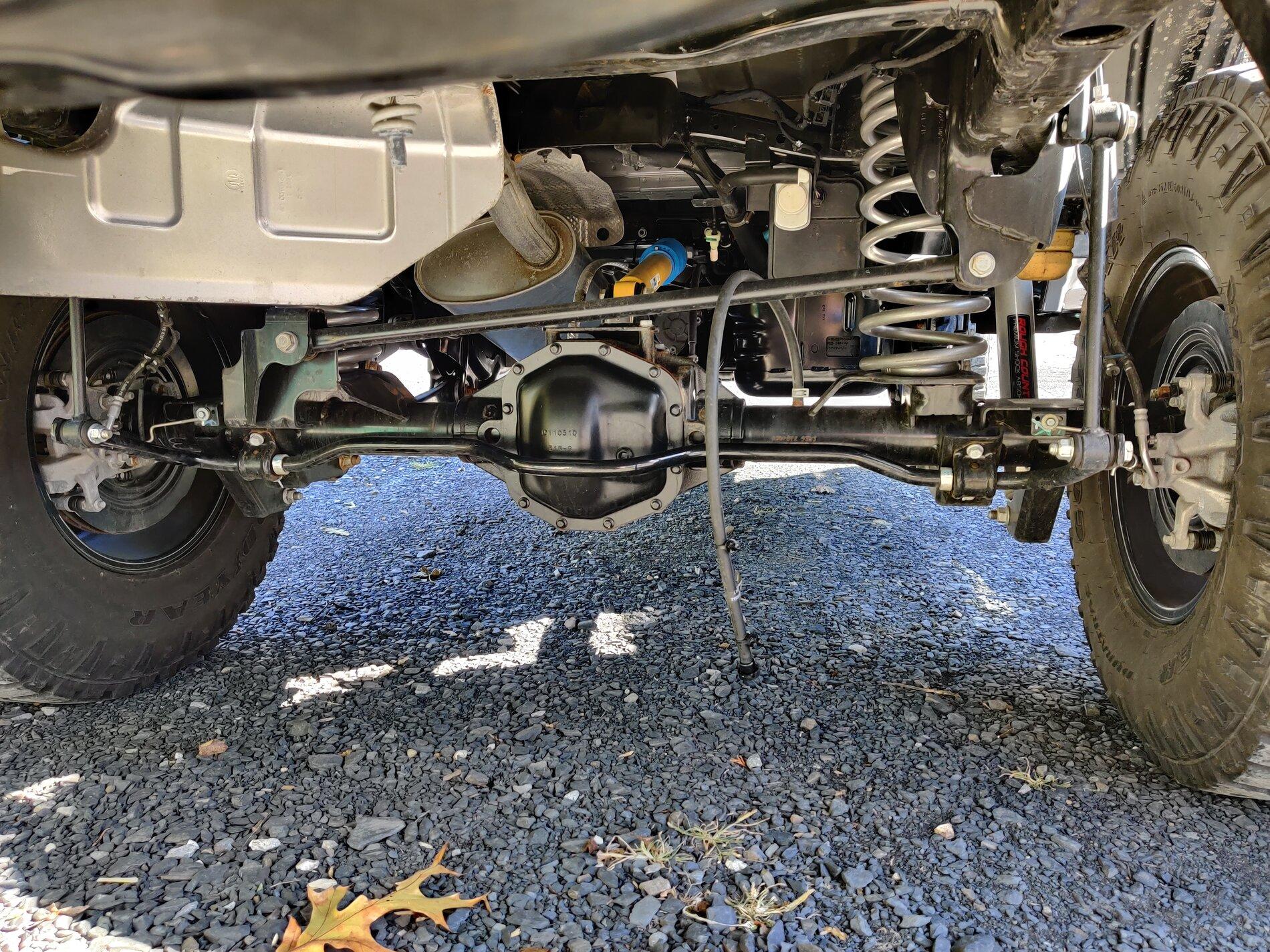

For what it's worth I saw this like 6 months ago before going to work and had to put it back on. Has this happened to anyone else?
Jeep Gladiator Leaking axle seal? IMG_20201105_102828
Renegade
Zac
Sep 11, 2017
3,616
4,818
Signal Mountain, TN
2020 JT
Lift installer should check for the need to relocate the breather tubes, based on suspension articulation.
