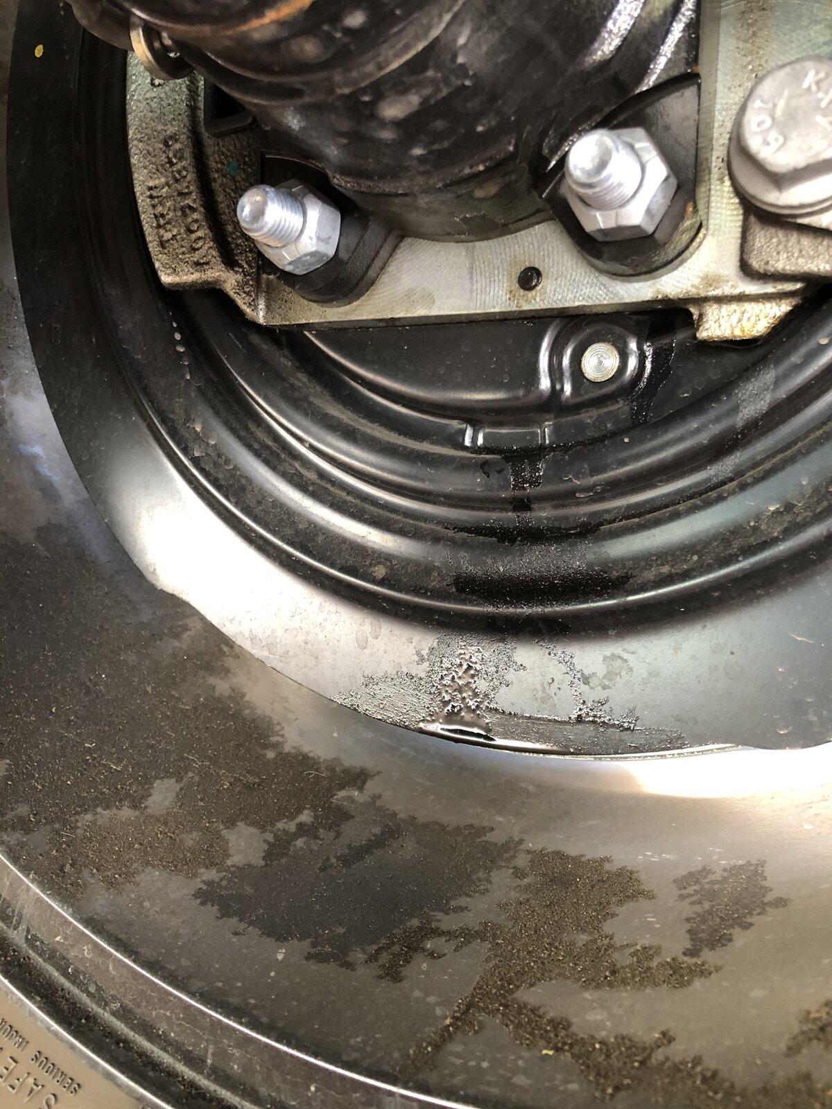

Looks like I'm lucky enough to join the club. 1200 miles on my '21 Diesel Sport.
Built 3-21 MDH 033003
Jeep Gladiator Leaking axle seal? Axel Seal Leak

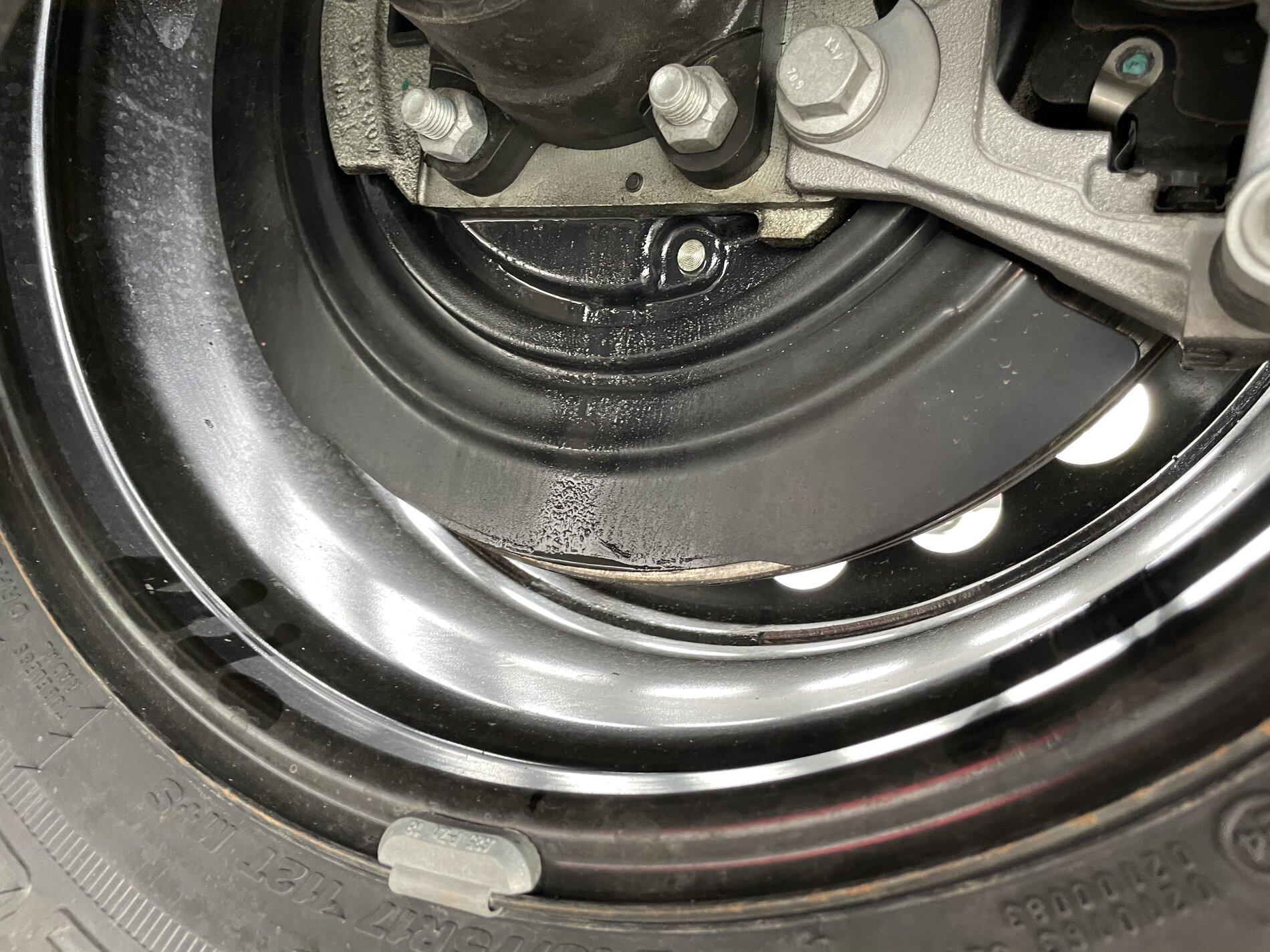

I ran into the same problem with the passenger rear axle on my 2021 Sport Max Tow, 3,500 miles

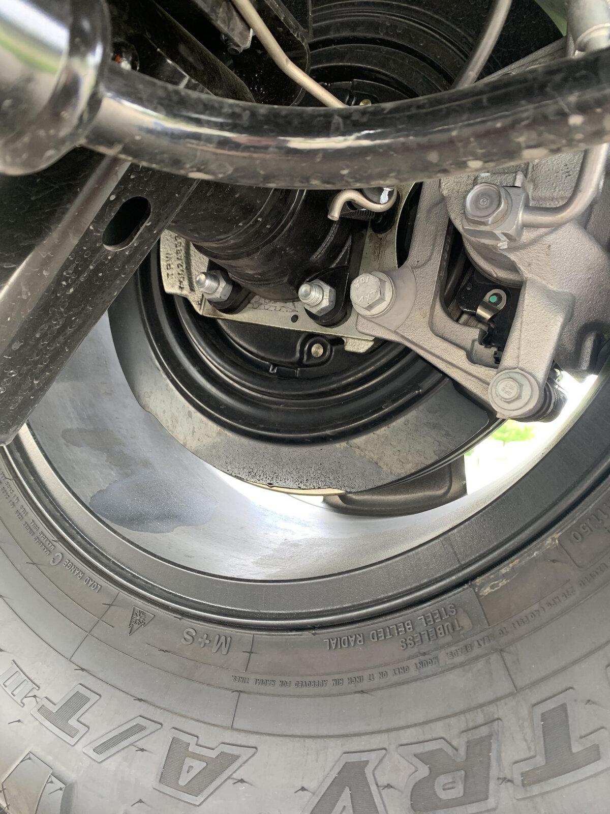

I have an appointment next Tuesday to get mine looked at. Found the leak on the passenger rear while installing the Clayton 2.5 Overland Plus last weekend.
