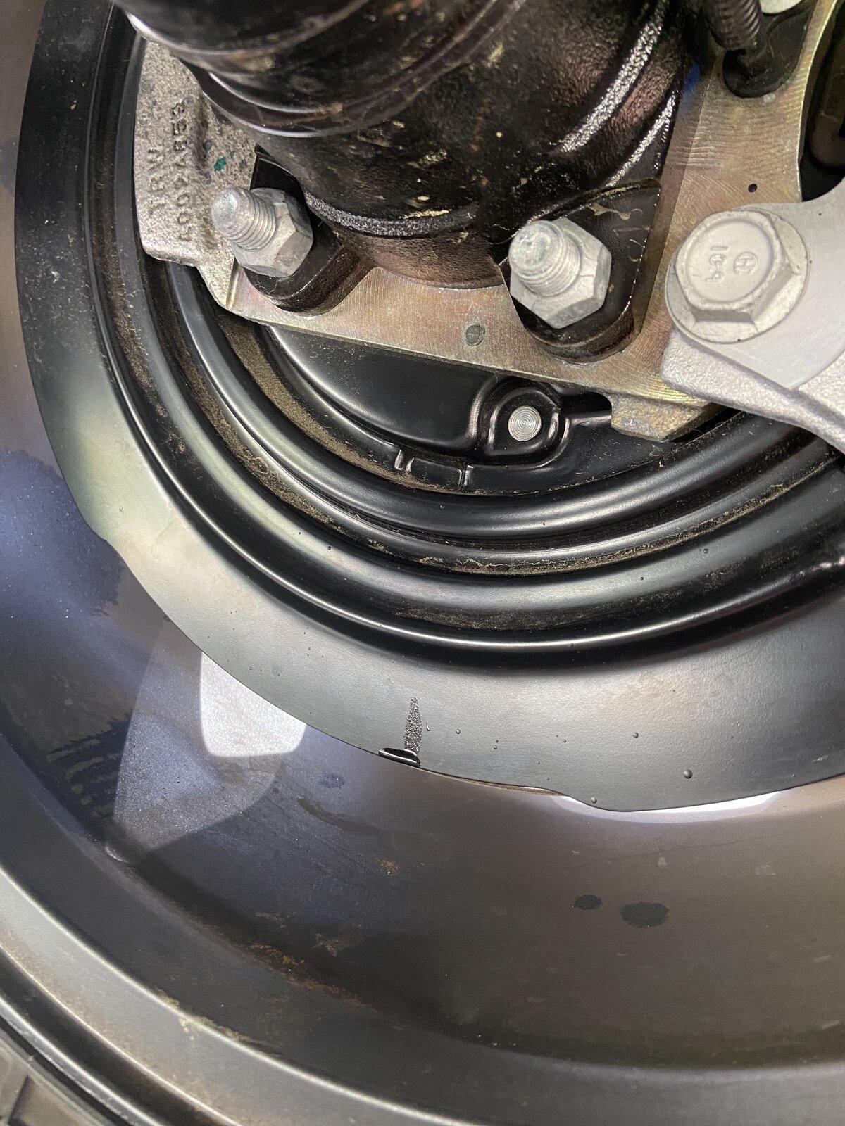

So I wiped it all down and drove it for 2 days and not a drop. Heading on a 300 mile trip tomorrow so we’ll see if it drips again. I’m sure it is still there but odd it is not dripping all the time. I’ll likely get it to the dealer next week.
AXG1040
Anthony
May 13, 2021
60
58
VB
21 JT Mojave
About 200 miles in it showed itself again. Appointment Friday for dealer to see the leak and order parts. Is what it is. Not going to let it ruin my love of this awesome truck.
That drip looks like water to me. If it was oil, I would think it would leave residue all the way up to the point of the leak.

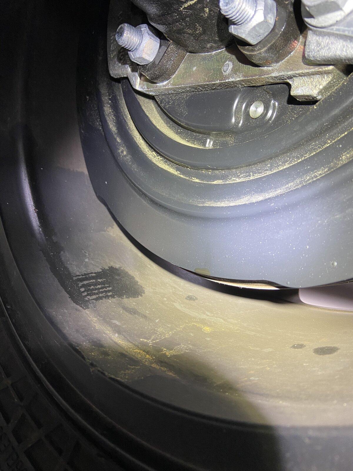

Man I wish it was. Took a better picture. Diff fluid for sure. You can see it on the wheel too. The leak occurs between the rotor and dust shield. No worries...warranty will take care of it. This post made me take a look. Otherwise might have been some time to notice.
