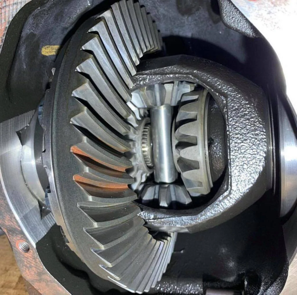

I've never heard the whole assembly called a differential personally. This is the differential.
Jeep Gladiator Leaking axle seal? diff
View attachment 154402 To call the whole assembly a differential would be a misnomer IMHO. You could have a full time locker like a Detroit for example that defeats the whole "differential" aspect of the axle assembly completely. Then there is the front solid axle in a 2WD that has no differential at all, or a trailer for example.

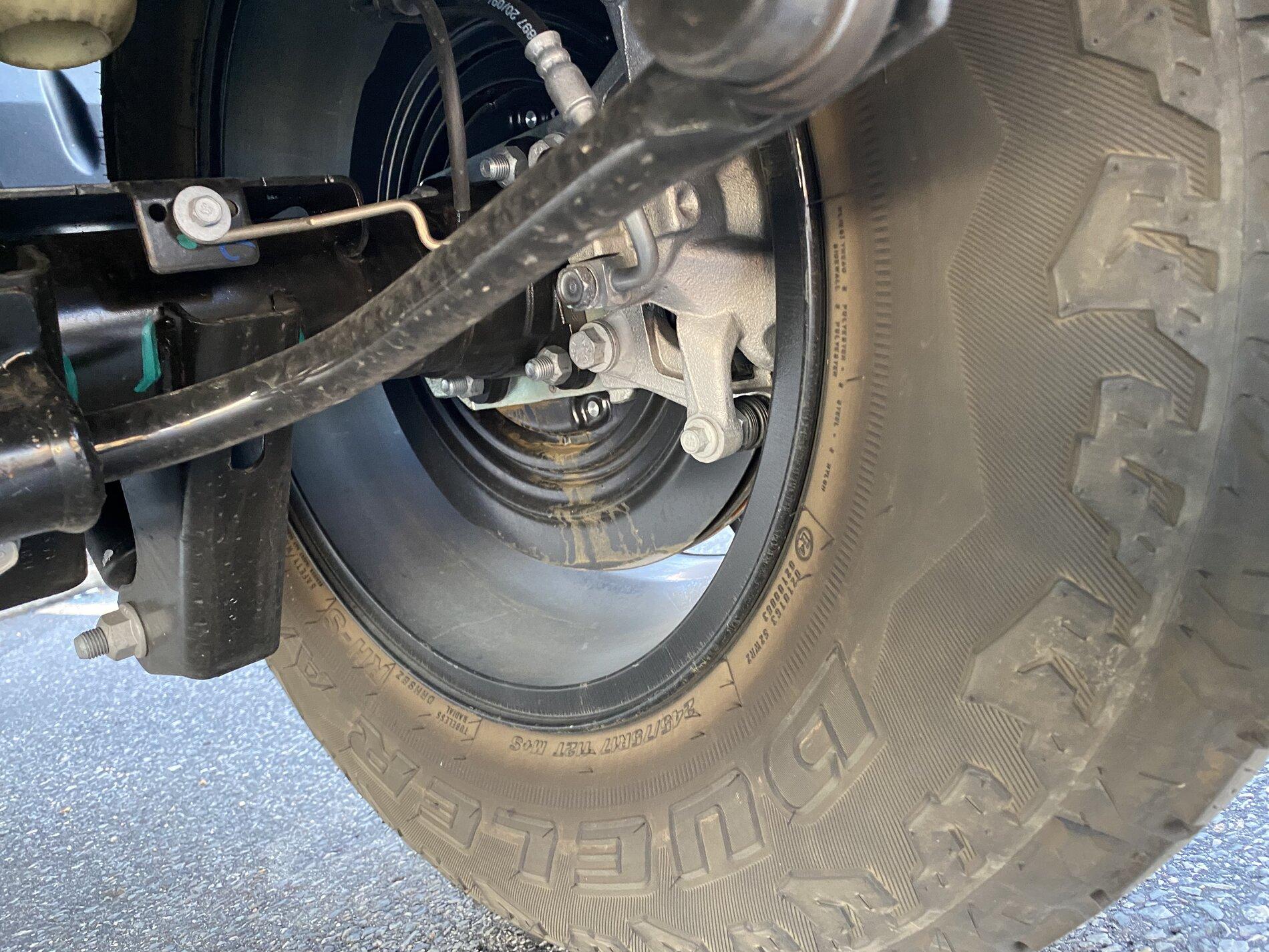

Can someone help me out here? Mine was ordered 01/05/21, took delivery 02/20/21 so I definitely fall in the gap where people are seeing this. After seeing this thread I figured I would take a look and saw this:
Jeep Gladiator Leaking axle seal? 0EB71F7E-CA16-4375-B56B-CE6BC36BA8A7
I am not entirely sure if this looks like what others are experiencing. Can someone chime in here? I brought it to the dealer for another issue and told them to look into this too and their response was that it’s just a rust stain. But, I find it odd to be just on this corner of the truck.
Furthermore, the time in which everyone is getting their axles replaced is bugging me. I have been waiting 6 weeks now for an entire front differential and axle assembly (for a different issue) to be replaced and after badgering the dealer weekly they have no timeframe at all on it. I understand it’s a different part (front, not rear) and parts are scarce right now, but does this sound normal?
To me looks more like it got wet (water) and collected dust. I would just clean it up and keep an eye on it.

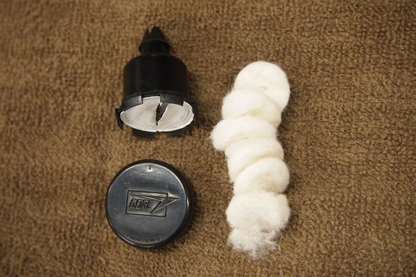

Picked up my Gladiator from the service department and drove it home 60 miles this afternoon. Looked under it when I got home and did not see any fluid. I'll check it again in a few days.
Something did occur to me on the way home. When I had a Nissan Frontier I remember talk of the D44 axles springing seal leaks because the breather vents would get clogged.
So in the morning I'm going to do two things.
- pull the fill plug to make sure it's not over filled.
- check the breather hose to make sure it's not kinked or otherwise clogged.
Just thinking out loud.
You may be onto something here. I remember my Frontier blowing the seal on one side at around 10,000 miles. Dealer replaced both sides under warranty, and I immediately did the vent hose mod that all the Nissan guys were doing where you route a section of hose off a straight through threaded stud to a high location and then terminate with a small fuel filter or something similar to keep insects out.
Never saw a leak after that.
Another trend I'm noticing. Most of the leaks seem to be on the HD axles, Max Tow and Rubicon.
Do the wide-track axles and the standard axles share the same style pressure vent?
If you hadn't happened to see it before, check out my earlier post on page 5, #74 of this thread about the restrictive vent hose cap on the rear axle.
After discovering this restriction, I had been running the truck with the vent cap assy. completely removed from the axle vent hose for about three weeks & approx. 1,000 miles until I could get it into the dealer for the seal repair.
Coincidentally the leak almost completely stopped during that time frame. It never did actually drip onto the backside of the wheel, so for whatever it's worth, I believe this restrictive vent is a major contributor to this rash of leaking rear axles.
Just got my Mojave back from the dealer yesterday after they replaced the axle shaft w/bearing & seal assy.
Before reinstalling the vent cap last night, out of curiosity I opened it up again to see about cutting a slit in the paper membrane to allow easier venting, and hopefully prevent any future leak issues.
The picture below is a new discovery that the body of the vent is packed, and I mean VERY tightly packed with a heavy felt material.
It's no wonder that it's almost impossible to blow, or draw any air through the rear axle vent hose. All I can figure is they did this in case you would drive through extremely high water to prevent it from flooding the axle housing.
Since I have no plans on installing a periscope, and converting my truck into a submarine any time soon, I removed all but a very little of this heavy felt from the vent cap.
Now it will pass vented air as it should when the gear lube expands & contracts from thermal cycling when driving. I feel pretty certain that this will eliminate any future seal leakage from pressure buildup. We'll see.
