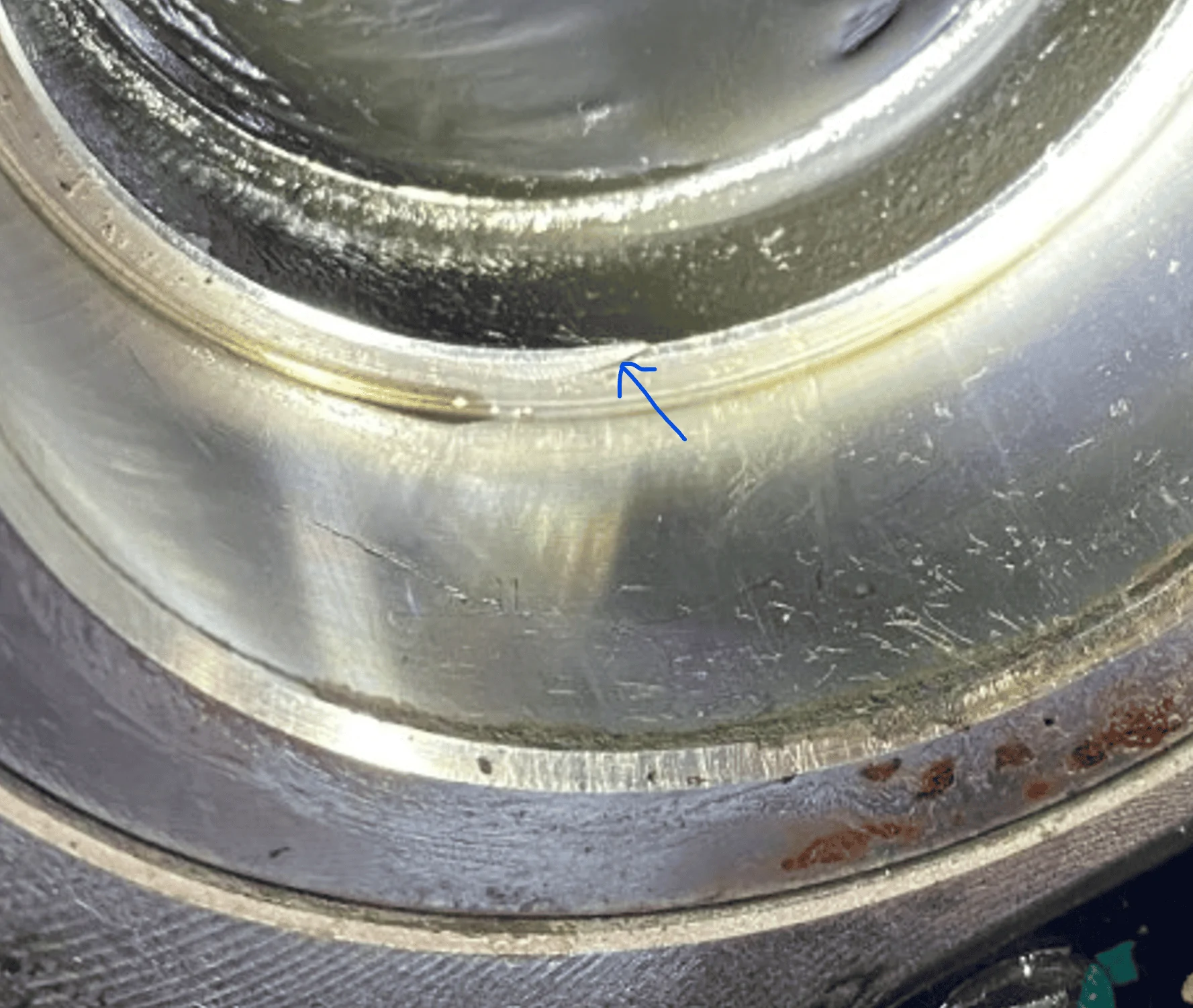

Update: Took it back to the shop so they could take more photos for Mopar and report to them. I've included the photos here:
It appears there may be enough of a machining error (arrow) on the housing to cause a leak- what are your thoughts? The service adviser and tech I am working with have claimed I am leaking about 1/4 quart a week- seems like a lot more than what appears on my wheel.

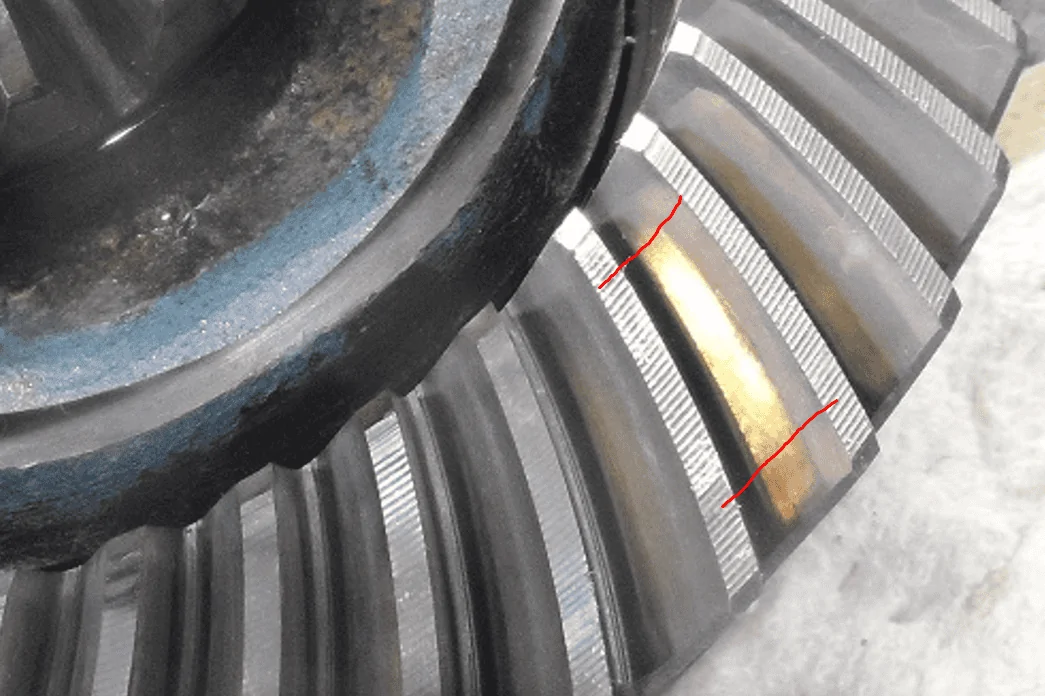

Here's from a book on differential gear setup - and an example of the one from my SX4 -
This is a good wear pattern. Very much centered, and even the length of the tooth as well as height of the tooth -
Jeep Gladiator Leaking axle seal? 1654541798781
Maybe hard to tell from this pic - I can't find the others I took of the rear differential from my car. It has over 193,000 miles on it. I rebuilt it a far as bearings and seals at about 190,000 when I took the pictures. The wear pattern for a gear nearing 200,000 miles is very good.
