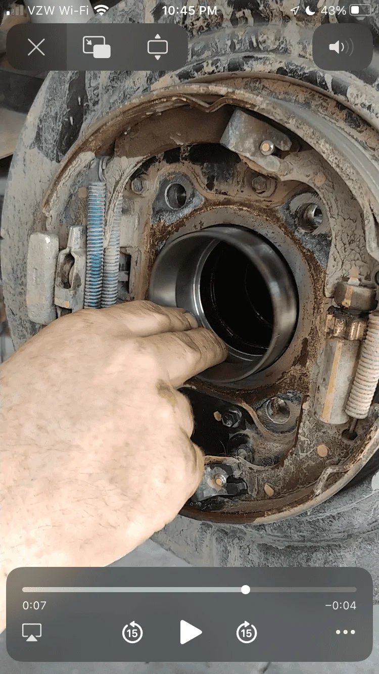

Went to install lockers on my Willys and found the leak in the rear axle on both sides bad enough to mix with the brake system. 10-10-20 build at 13k. Seems like the race was spinning independent of the bearing within the axle assembly. Stopped any other work and taking it into a local dealer
The cup, or race, will not fit tight in the axle tube. It won't be "loose", but can turn. When the whole thing is put together, the cup is held in place by the pressure put on it by the seal which is pressed against the cup/race by the retainer.
It's made that way so the whole thing just slides in, and is "clamped" in place and prevented from turning in the tube by the force applied by the retainer.
When the retainer nuts are taken off and the axle slid out, you can slide the race or cup out of the housing. Sometimes you have to work it evenly because it is a close fit but they are not driven in. It's not a press fit.
It will go in and can be turned, but not be loose in the hole.

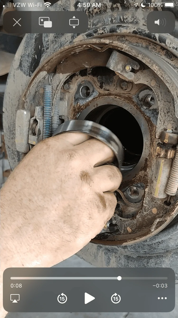

https://www.vzmessages.com/vl/e50e280637762f763be46786c549f94d98ff7dff
video of race. Seems more loose than should be? Does it seem normal per your experience?
If I'm seeing it correctly, that one looks pretty loose. They should take some effort in that they need to be perfectly lined up and square with the tube to go in. They'll slide in or out a long as the pressure or pull is even, but that just appeared loose.
Also it looked like it had been turning in the axle tube. Once in, they should not turn due to the pressure of the seal and retainer against them.
In short, that one just looked too loose and I don't like what appears to be a wear pattern on the outside of that race. If it's turning in there, it's going to wear the tube, and it means there's nothing pushing against it to hold it in place. Makes me wonder if that's also leading to the leak as the axle can move vertically - too much play.

There are signs the race was spinning itself within that housing ID.
I thought I saw a wear pattern or "shiny spot" on the outside of that race in the video.

I have a possible theory in your case - perhaps others.
It's not just the diameter of the tube where it is machined for that bearing race to fit into, it's the depth. If it was machined in too far, then when the axle assembly with bearing, seal, spacer ring, and retainer are installed, they will not be "squeezing" against that race to keep it from spinning. What holds it from sliding out and in, or turning inside the tube is the force of the bearing lip (and note - these are special tapered roller bearings with a ledge on them) - bearing lip or ledge presses on race, seal goes in, and is pressed against the bearing pushing it against the race. It's all clamped in place to keep things from moving when that retainer is bolted in place.
If that is machined too deep, the race goes in too far, and when the retainer is bolted in place, it's not pushing the seal hard against the bearing which in turn is not clamping the race in place. If things can move, you have play in the axle and it can cause leaks.
I would bet that if that was all put together, you could get some axle play.
That machined area size - diameter and depth - is critical. If it's too deep, the race goes in too far.
I'll look in my books and see if I can find any drawings. The closest I can find is Mercedes and it's a very similar setup but they use felt pads and o-rings to even seal the retainer and keep dust from getting in from the outside! Now why doesn't Jeep do that?

But if they’ve machined them all this way, shouldn’t they all leak?
