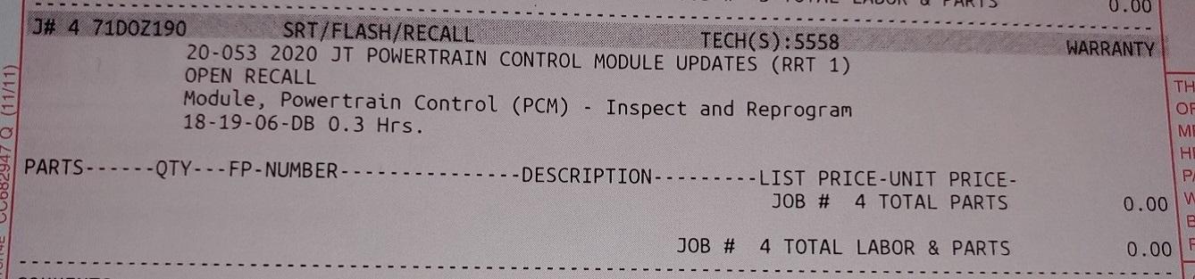

It will be like they did with the PCM programming - certain VINs only, and although called a recall, it's an RRT most likely. Yeah, they use the word recall.
If it's like the PCM - owners will get cards, or it's possible even CARFAX will notify people.
They ask "do you want us to do it while it's here?"
I said yes...........

It's not a true recall. This will be an RRT - just like that PCM thing was called a recall, it wasn't. It was a RRT. It will get put on the invoice as a recall.
There are no recalls as of this time, and no TSBs on the axle as of this time. (at least nothing the feds have). There may be RRTs out on it and those hit dealers before almost anything else.
I'd bet the owners will get a card either from FCA or CARFAX.
But it's not a recall in the recall sense.

Can I ask if my vin number is on the RRT list for this axle leak issue and they will look that up and let me know?
I had the PCM thing from your photo performed on mine the first time I dropped it off- I didn't even know about it until I picked it up.

You should be able to contact your dealership shop and get that info.
It's possible this is just rolling out and people there may not be fully aware.
My 2020 won't be impacted.
RRT - Rapid Response Transmittal
This is how they'd find out using their resources -
. TO VERIFY THAT THIS RRT SERVICE ACTION IS
APPLICABLE TO THE VEHICLE, USE VIP OR PERFORM A VIN SEARCH IN
TECHCONNECT.
