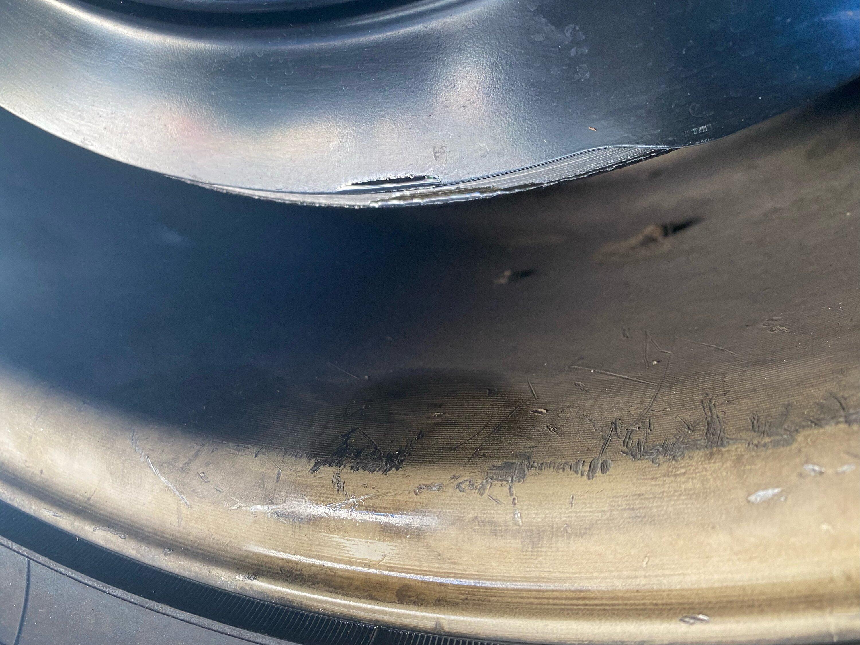

I am seeing it on both sides. First comment from Tanner was, "Did you add fluid?" Nope.
They fixed my pinion bearing and I drove to Tennessee and back. Went in to Jeep for a free oil change and they spotted it on both sides. Tech commented the "only time he sees this is with a regear"
I cleaned them off and it's suspiciously less than it was when it was on the lift. But it is gathering on the bottom of the dust shield and a tiny bit on the tire bead.

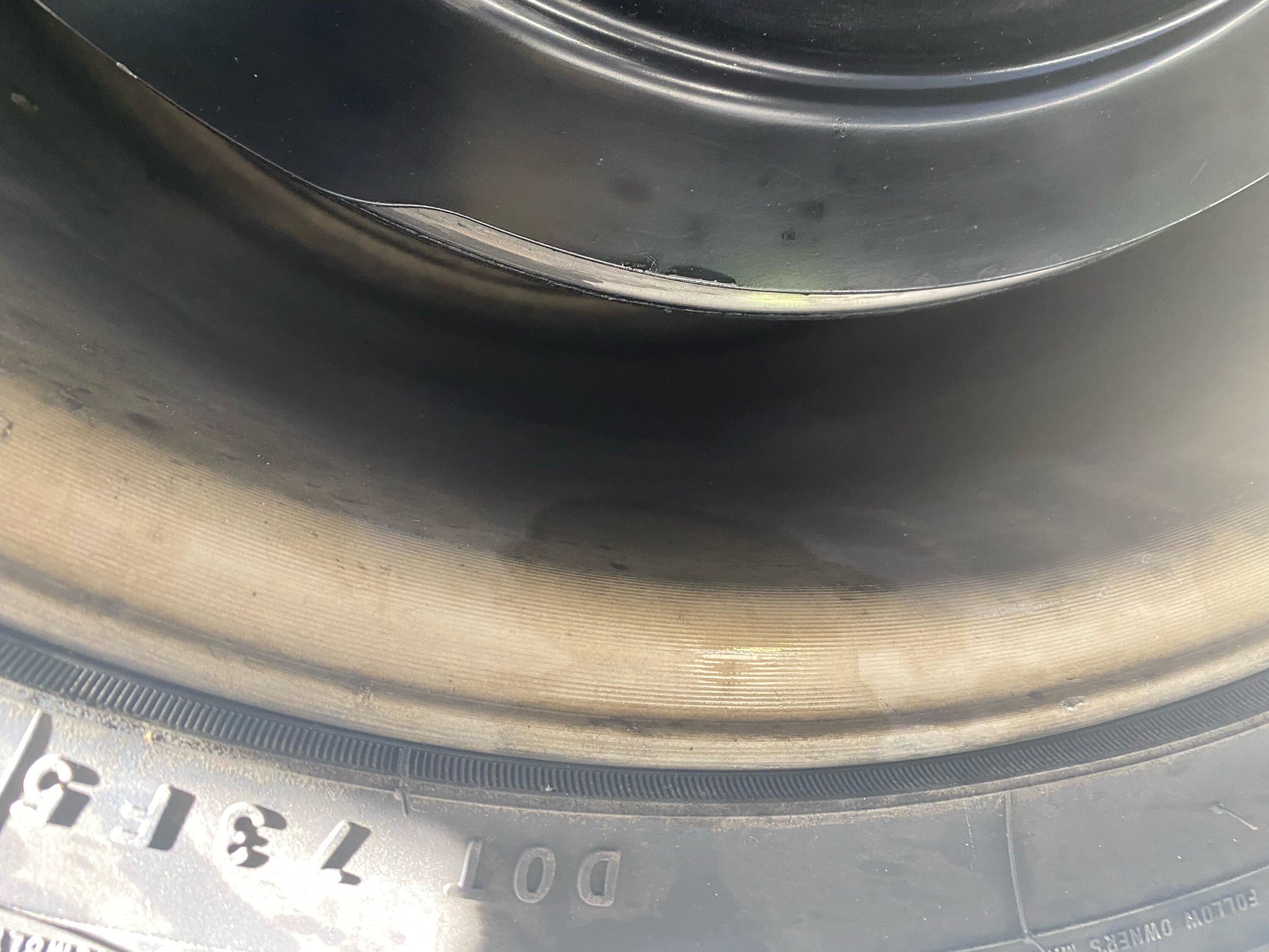

Here is the state of mine. Not as bad as some....but
Jeep Gladiator Leaking axle seal? IMG_0891
Jeep Gladiator Leaking axle seal? IMG_0892

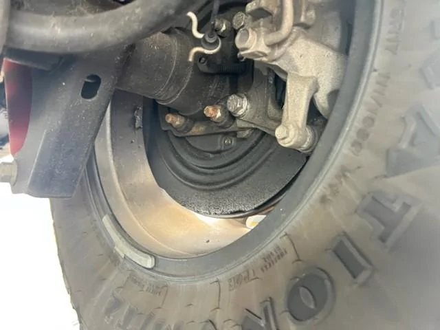

Just got back from my second Jeep Wave oil change and they found the PASS rear axle leaking. Gotta take it in Wednesday to get it diagnosed. Assuming I'll get it back same day for parts - would be nice if they had a loaner. 10350 miles.
Jeep Gladiator Leaking axle seal? IMG_E4260[1]

Just got mine back today. Here in Indianapolis I was able to drop mine off on Tuesday this week for service Wednesday (they squeezed me in with no appt) and they had it ready Thursday night about 4p.
Now just got to watch and see if it starts leaking again.
They used part # 68474264AA Shaft-Axle Rear
