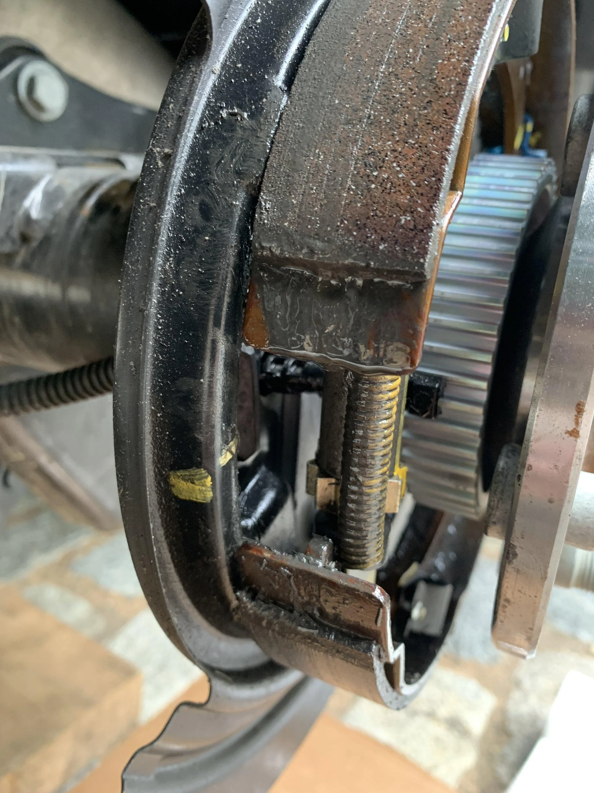

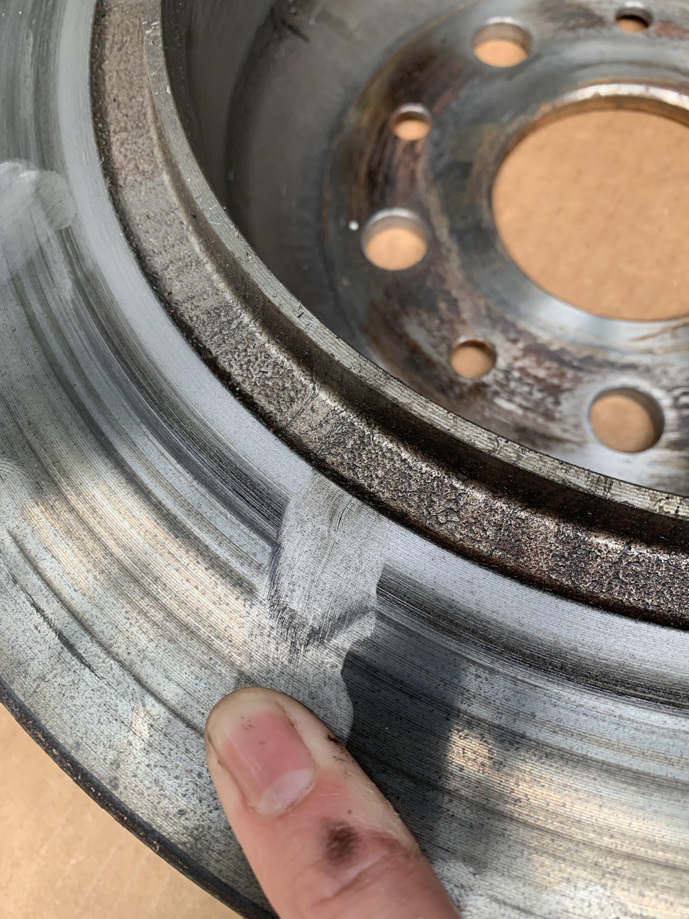

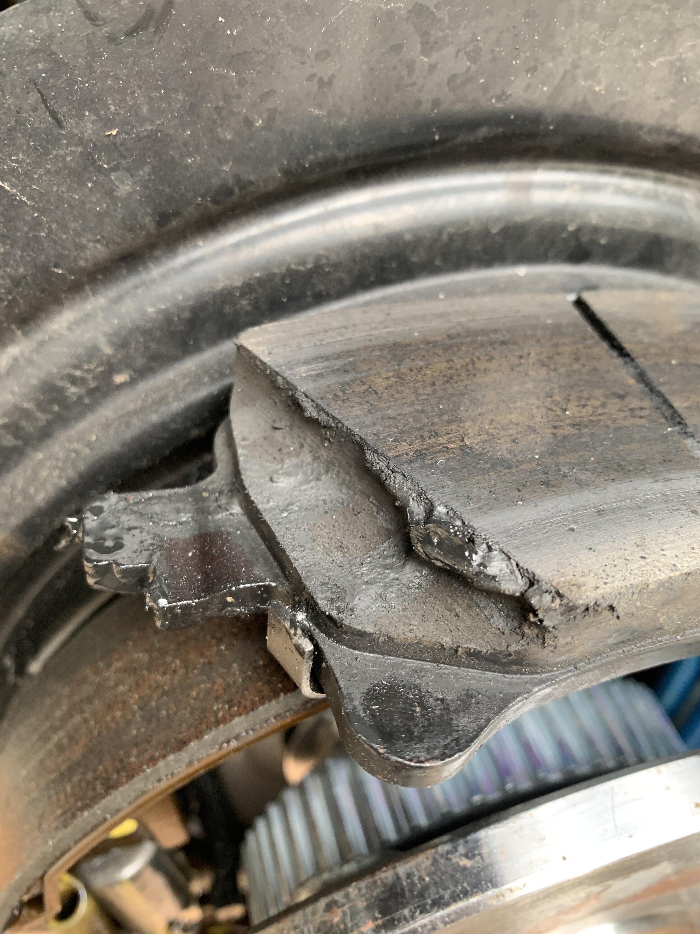

Since there is talk of contaminated brakes, here is my condition. I recentlyhad my leaking rear passenger seal replaced by a local dealer. When I picked up the vehicle I did not see anything on the invoice about cleaning or replacing the brakes. I asked the service manager about this and he told me the mechanic said the contamination was not bad and he was able clean it up. I got home and looked under the car and the inside of the wheel and dust shield were still covered in oil. I pulled the wheel, caliper, and rotor to verify. E brake lining and drum area were saturated with differential fluid and the rotors inside surface had a film of oil. Inside pad had oily sludge on its leading edge. I am trying to figure out how to proceed with the dealership.

Take it back. Say that you looked under the truck and seen that everything is still oily. Don't say that you took it apart. They will blame you for the bad pad

That mess is inexcusable. Doesn't look like it was cleaned at all to me.
When we fixed leaks, we gave the vehicle back to the customer looking like it had never had a leak. The point wasn't to fix the leak and do nothing else, it was t clean up the mess the leak made, take it back in time.
These people swap parts and that's about it. No customer service.

I am leaving on a 2,000 mile trip in another two days and don’t trust this dealer now so I used two cans of brake clean to get things in reasonable shape. I am unsure if the pads are shot regardless of how well they have been cleaned. I have read where others have had pads and rotors replaced by the dealer. I can tell the mechanic had to remove the rotor to change out the axle so I can’t fathom how or why this happened.

Brake clean will clean up the rotor no problem. But the pads have to be replaced. The one in the picture has a piece missing. I would replace the e-brake shoes too. You'll never get the lube out of them.

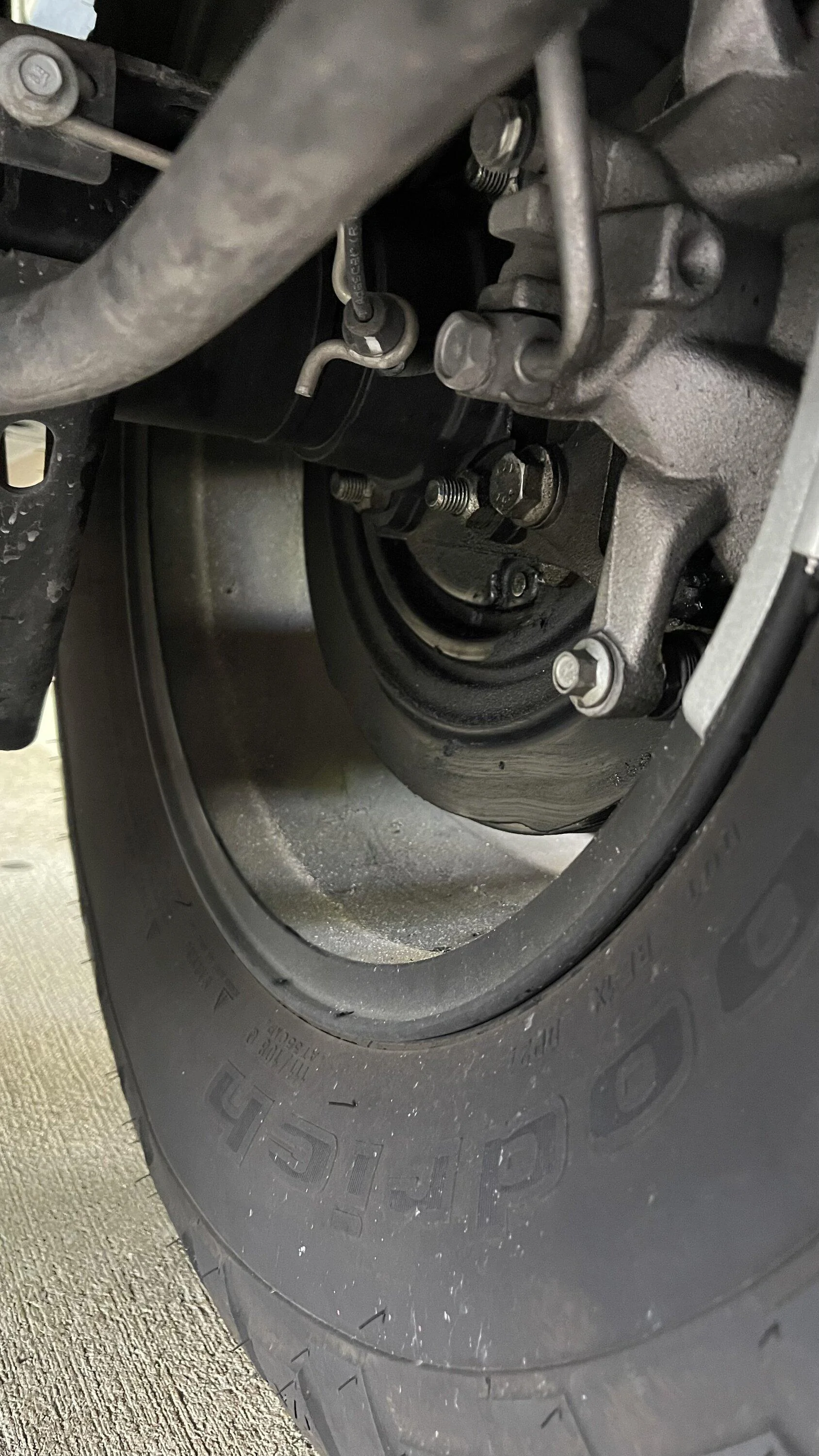

Well, crawled under my JT a while ago to look at spring part numbers and discovered my right rear axle seal is leaking. Less than 1K miles on the truck. Guess I'll be calling the dealer tomorrow.
Took awhile for the part to arrive. Axle/bearing/seal assembly. Mechanic said the axle was pitted and caused seal failure. About a 3 day fix. Dealer provided a rental car. So far, so good. So, either there are no parts inspections during assembly or the part was inspected and deemed to not create a problem....WRONG.

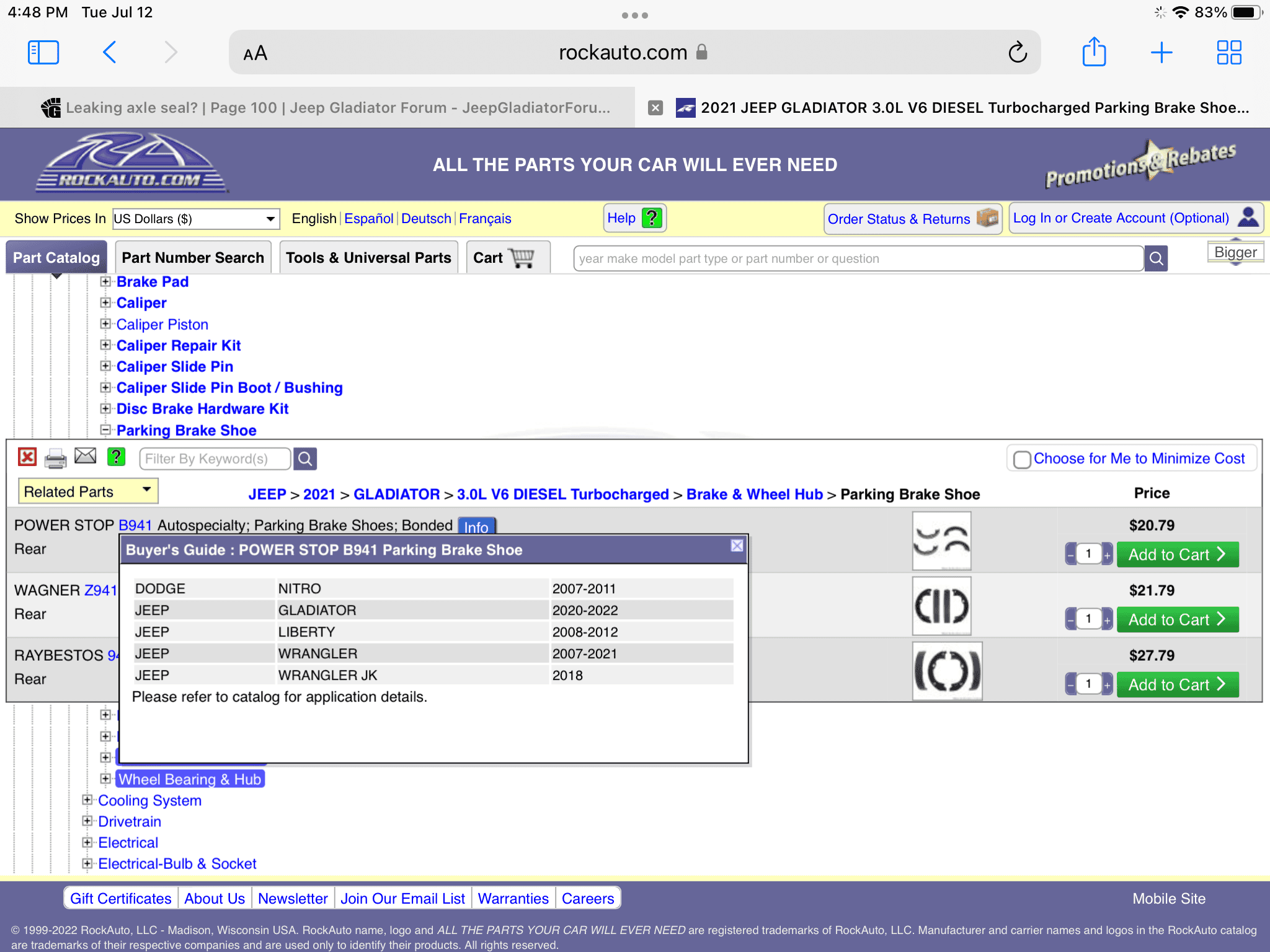

oem ones are spendy but aftermarket ones are like 20.
power stop makes some B941
