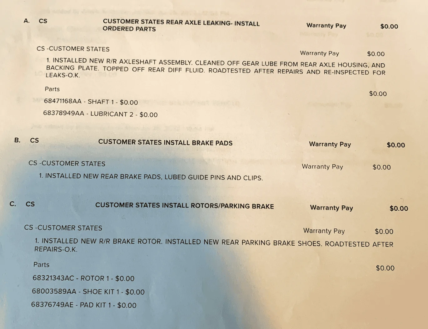

staying_tuned
Jan 11, 2021
54
776
1,215
Kentucky
Previous: TJx2, JKx1, JKUx1
Software Architect
Dropped it off last night just before closing. They put me in a Ram w/ the 3.6 and called me this morning around 10:30 to let me know it was ready. They told me during the initial inspection months ago that they intended on replacing the rear pass. rotor, pads and e-brake shoe but I thought the pads were still on backorder till Nov. Thankfully they got it all in and done very quickly.
