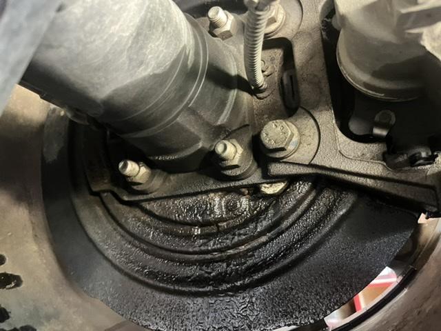

Well add me to the club. 2021 Sport S 3.6L max tow. Had my tires rotated today and noticed it. Made appointment with dealer for Monday. Checked diff and it is clearly low on gear oil. Topped it off. Pictures are below. The tire is after being rotated to a different spot.
What I am wondering is how bad is it to drive? I have a 2200 mile round trip road trip planned in a week. Worried it isn’t safe to drive that far. Dealership couldn’t really tell me over phone.

Just rolled under mine to add some control arm skid plates and looks like I have the leaky axle as well.
Passenger rear 2021 Gladiator Mojave.
Left VM for dealership hopefully call me tomorrow to get it in soon.
Hows the parts situation, anyone know the availability for the pieces they need to fix it?

The passenger side axle assembly should not be hard for your dealer to find and replace. It took 3 days to ship from wherever to my dealer.
If that replacement does not fix the leak, the next option is to replace the entire assembly- which I'm told there is a backorder situation on. They may offer to piece together the rear end with some new (axle, gear bearings, housing) and existing parts (driver side axle, carrier, etc). I would advise against letting them do that unless you are very confident they know what they are doing. Just some advice to keep you out of the nightmare I am currently in.

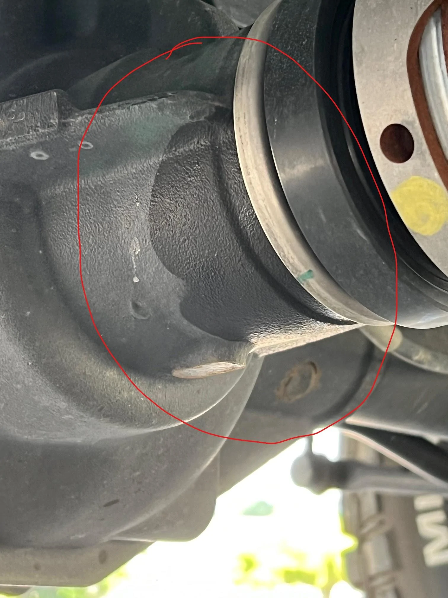

Just a question here, but kind of goes along with the whole rear axle issue that I had as well. I have what appears to be a fluid leak from the front of the diff where the shaft slides into.
My dealer says:
Yes this is moisture. The seal gets hot and cold, expands etc. Chrysler specifically says do not replace seals unless there is a fluid build up and an actual drip from the seal. What you have is normal. It must drip from the seal to warrant replacement.
My dealer says:
Something here doesn't click.
Your dealer is correct, they will not do any warranty repair for fluid leak staining until droplets actually form. Just about all the other vehicle brands are the same in this regard.
My dealer says:
As said - dealer is correct. That's not an unusual appearance.
Consider that to make a spot like that would require only a part of a single drop of hot fluid.
something like that is what I'd simply wipe now and then if I was showing it and being judged on appearance and cleanliness, otherwise, I'd ignore it.

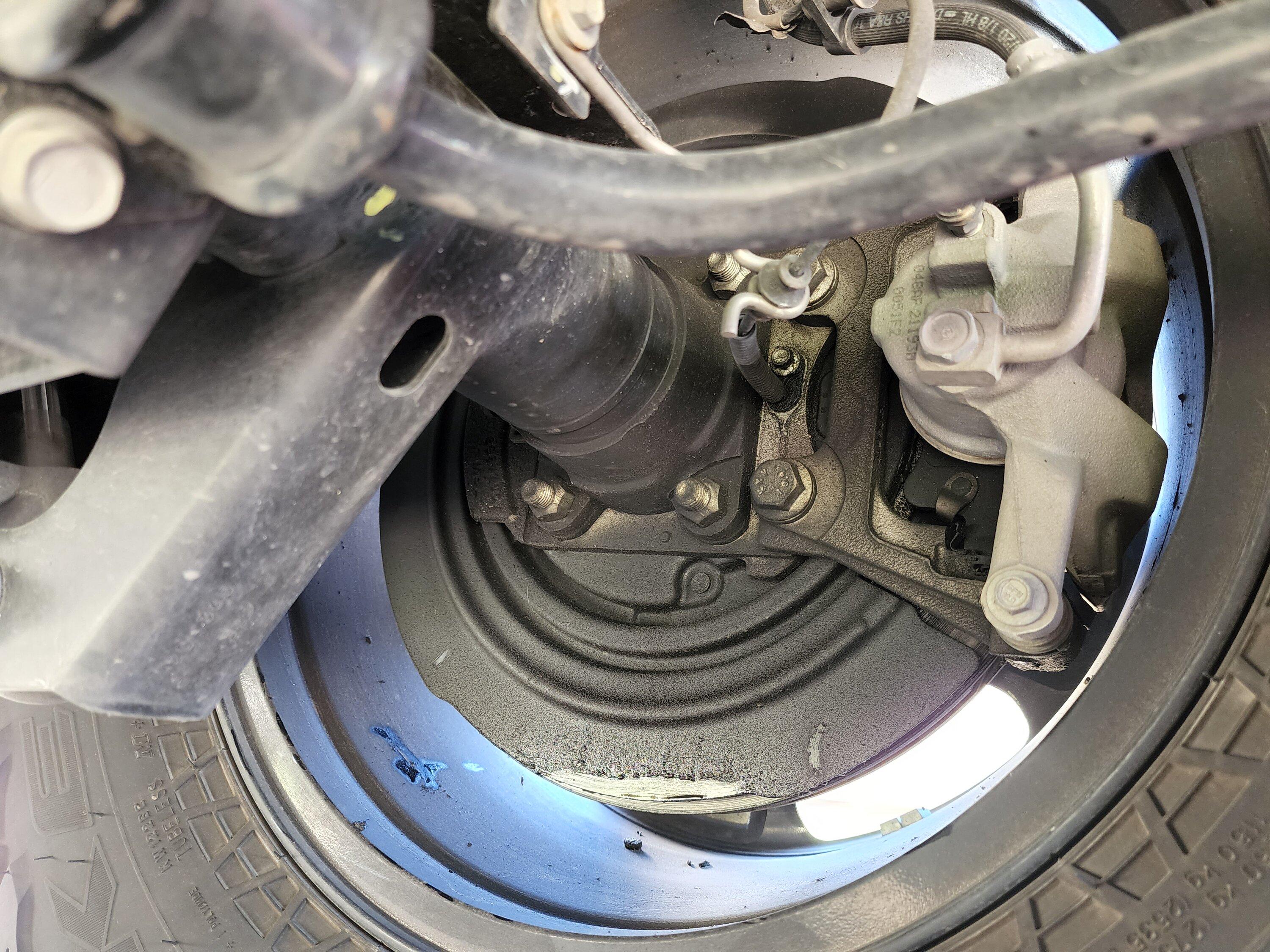

Dropped mine off last night waiting to hear from dealer to confirm leaking axle and then of course time line to repair.
It seems the leaks don't leak "a lot" and a little oil seems to go a "long way" in making it look worse then it is. As pointed out in another thread (shadowPapa) comment it was mentioned something like you would have to lose 3 ounces before possible damage to occur and obviously that would be a big mess compared to some spread out over the back of the "wheel".
What I am curious about is the possibility for water or other contaminates to get into the axle?
How likely in water crossings or mud holes is stuff likely to get into the axle and cause issues?
