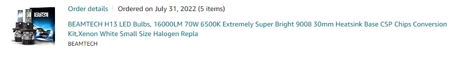

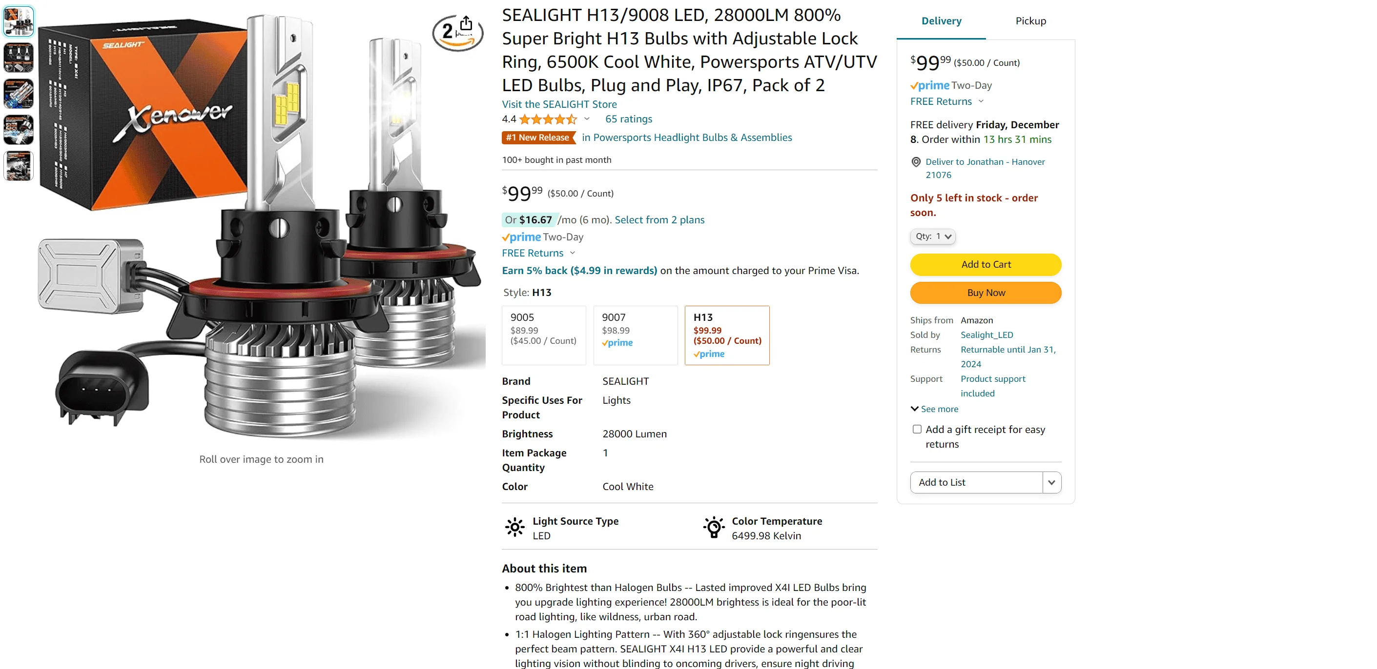

Bought these and tried installing them yesterday, but for some reason the passenger side connector did not fit. I did not want to force it so I uninstalled and put back the stock halogens. Really disappointed because the stock halogens suck, might as well put a candle on the hood and use that as my headlights.
I may try another Sealight bulb, some 2024 versions came out but if its the same thing, then I may need to find another brand. I saw Fahren as another brand but I remember someone saying on another thread that the high beams were basically useless. I may go with Beamtech but wish it would ship with Prime so it'll be delivered in a day or two. Amazon only has the fog lights whenever I check.
