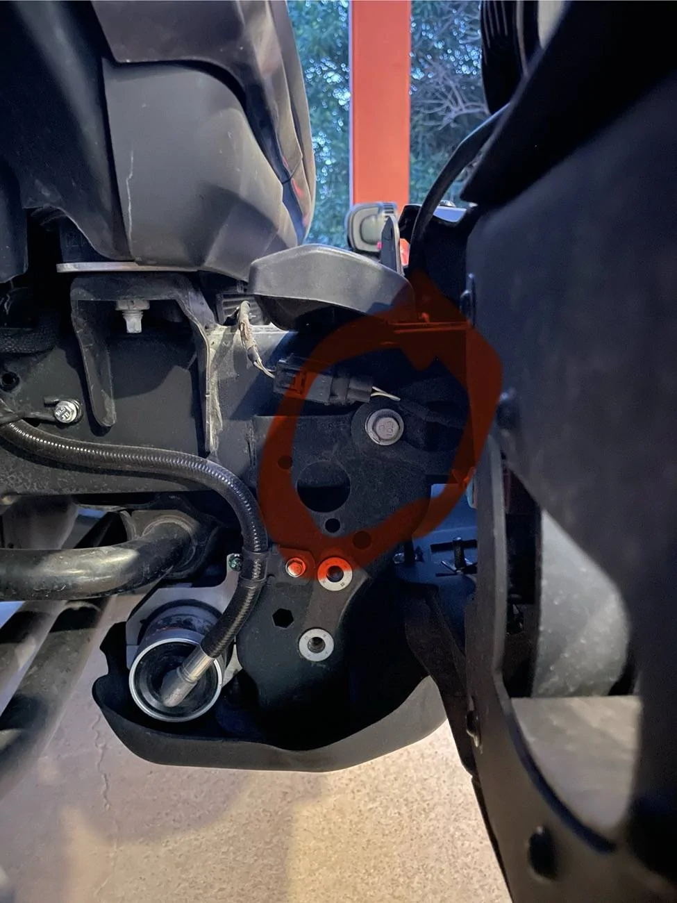

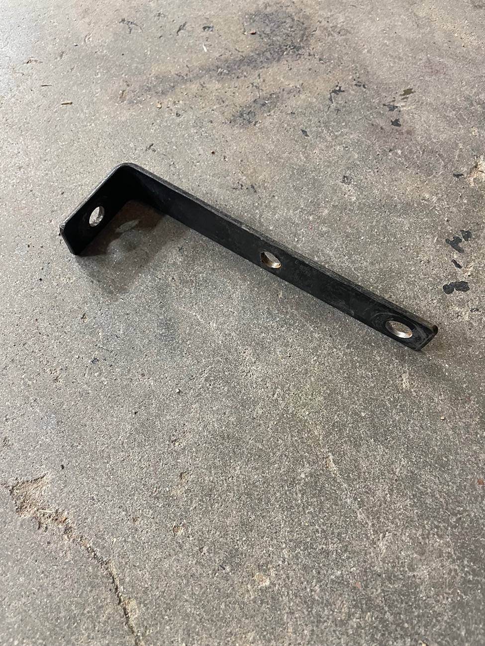

I made some simple L brackets that were attached to the bolt on the side of the frame for the front bumper. Cut a slot in the trim piece for them to pass through.
Jeep Gladiator Leds on factory OEM plastic front bumper IMG_8535
Jeep Gladiator Leds on factory OEM plastic front bumper IMG_8240
The bracket and the bolt in question.

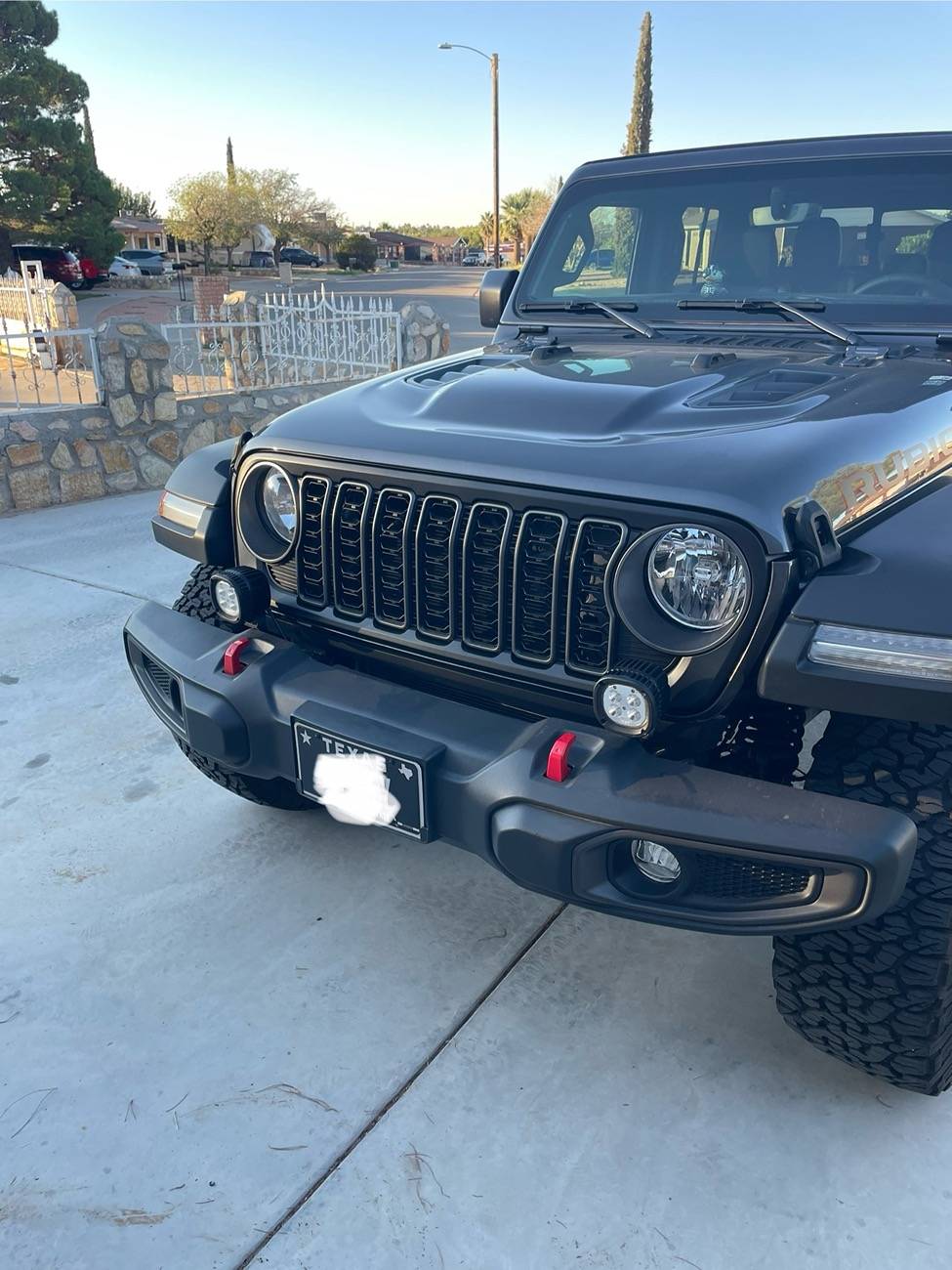

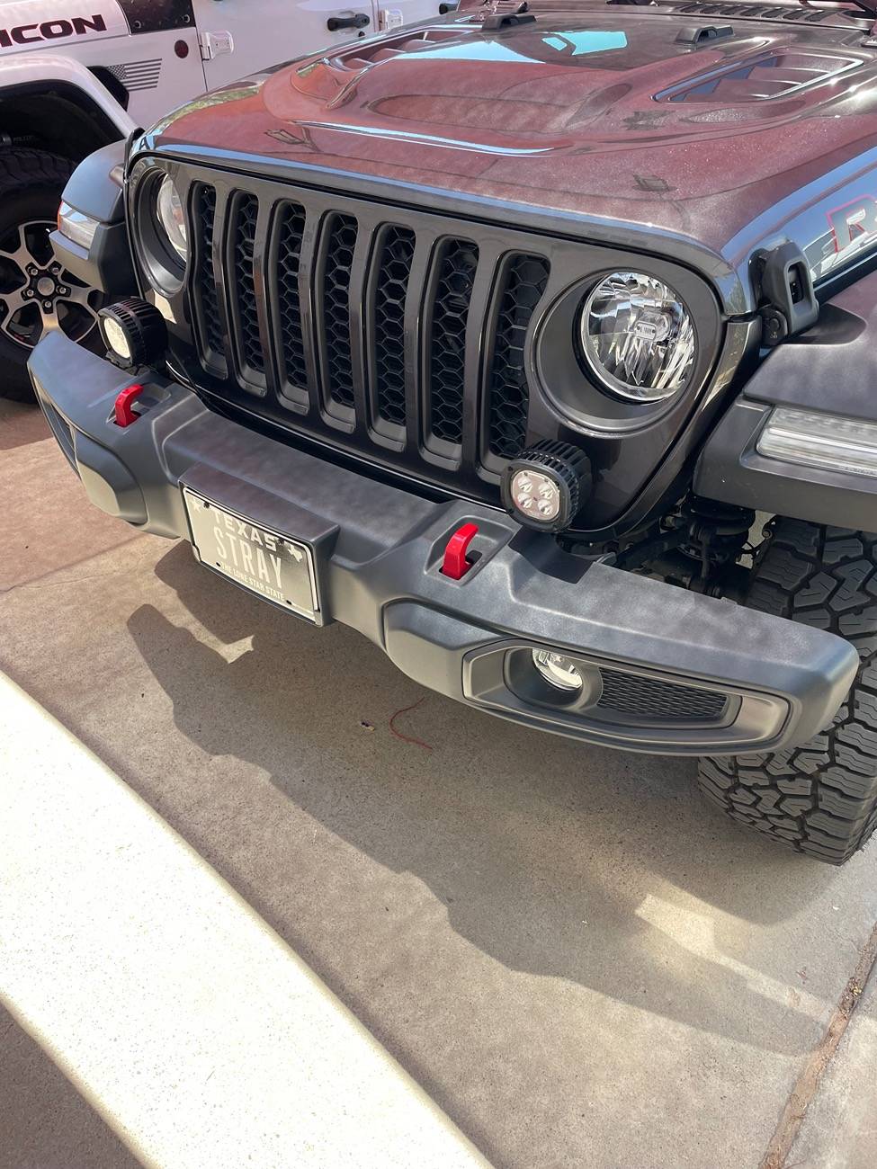

Jeep Gladiator Leds on factory OEM plastic front bumper IMG_9026
Jeep Gladiator Leds on factory OEM plastic front bumper IMG_9027

Thanks for info. How do you like quality? Reviews are mixed.
I had no issues with them. You do have to drill a few holes and put in some rivnuts, but they are very solid. I cut some small holes in the plastic cover plate and put it back on. It left just the two mounting tabs sticking up at the back of the bumper and looked pretty decent.
