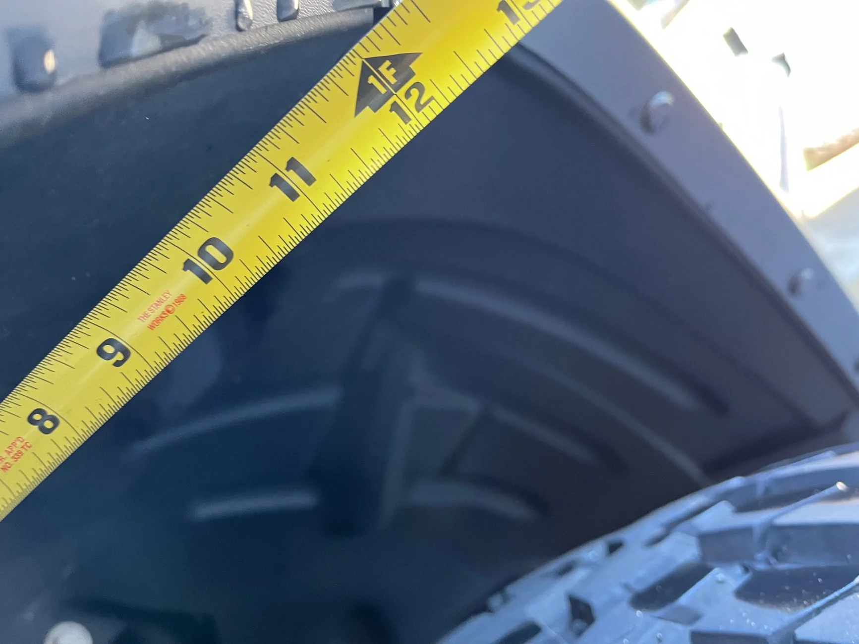

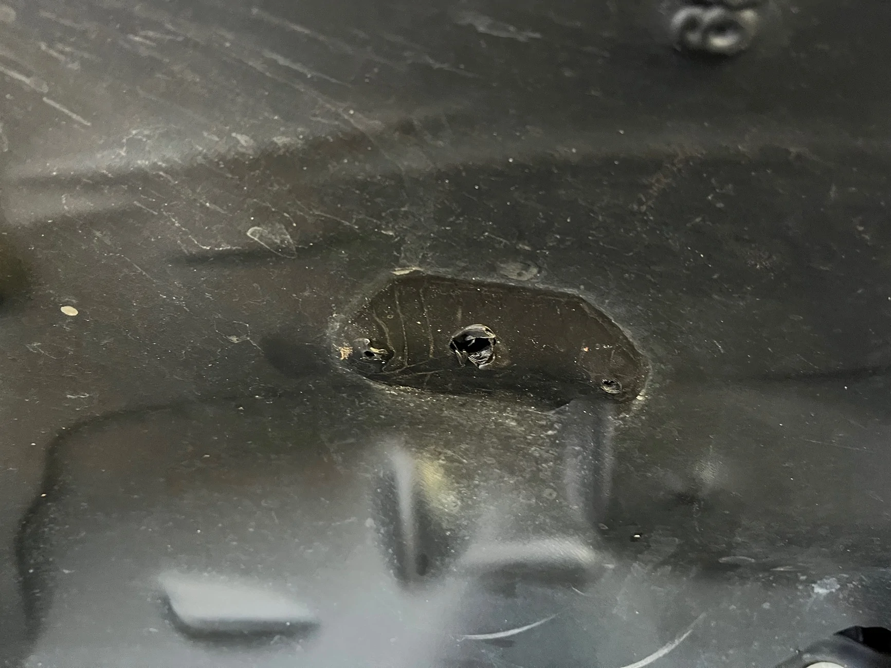

So here is where Rock Light WAS mounted! I took them off. The bolt that came with rock lights was about inch or inch and half. About 3/4 of inch was sticking above fender well. That is what rubbed wiring harness. I’ll try to get pics from dealer of that. As you can see I had it mounted about 12 inches in and right above the bump out on inner fender well
