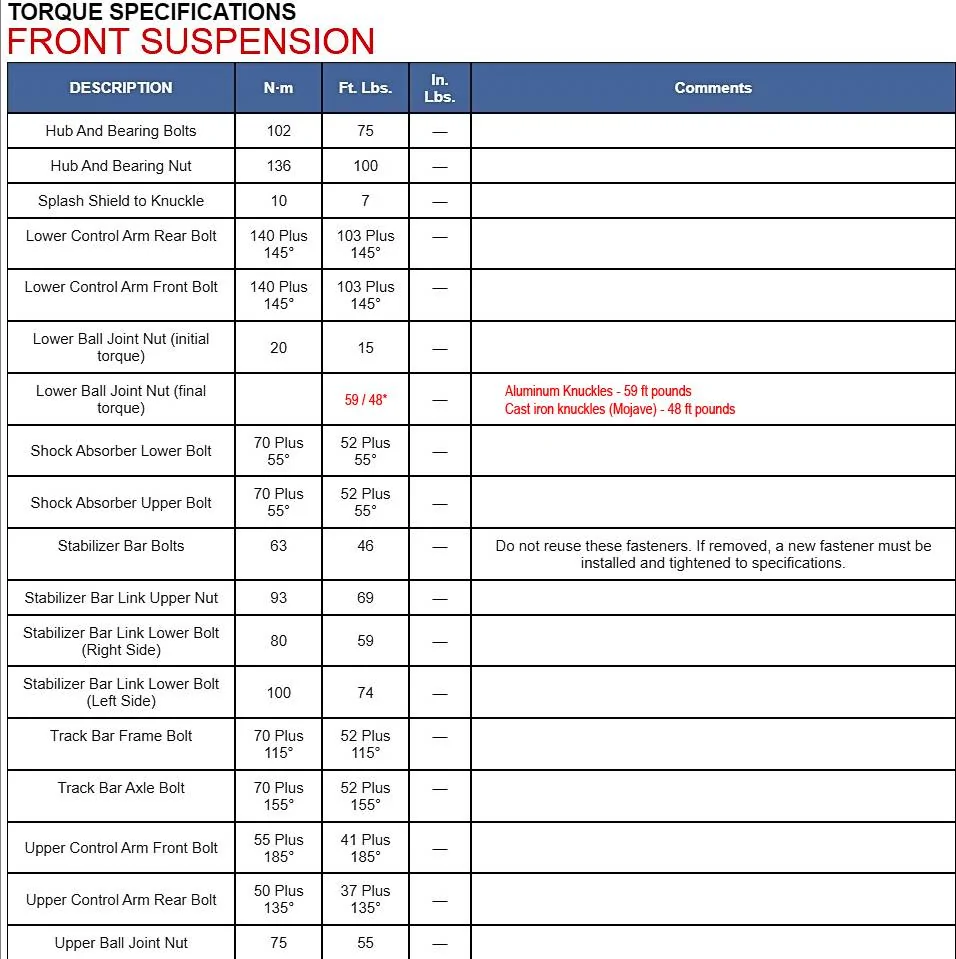

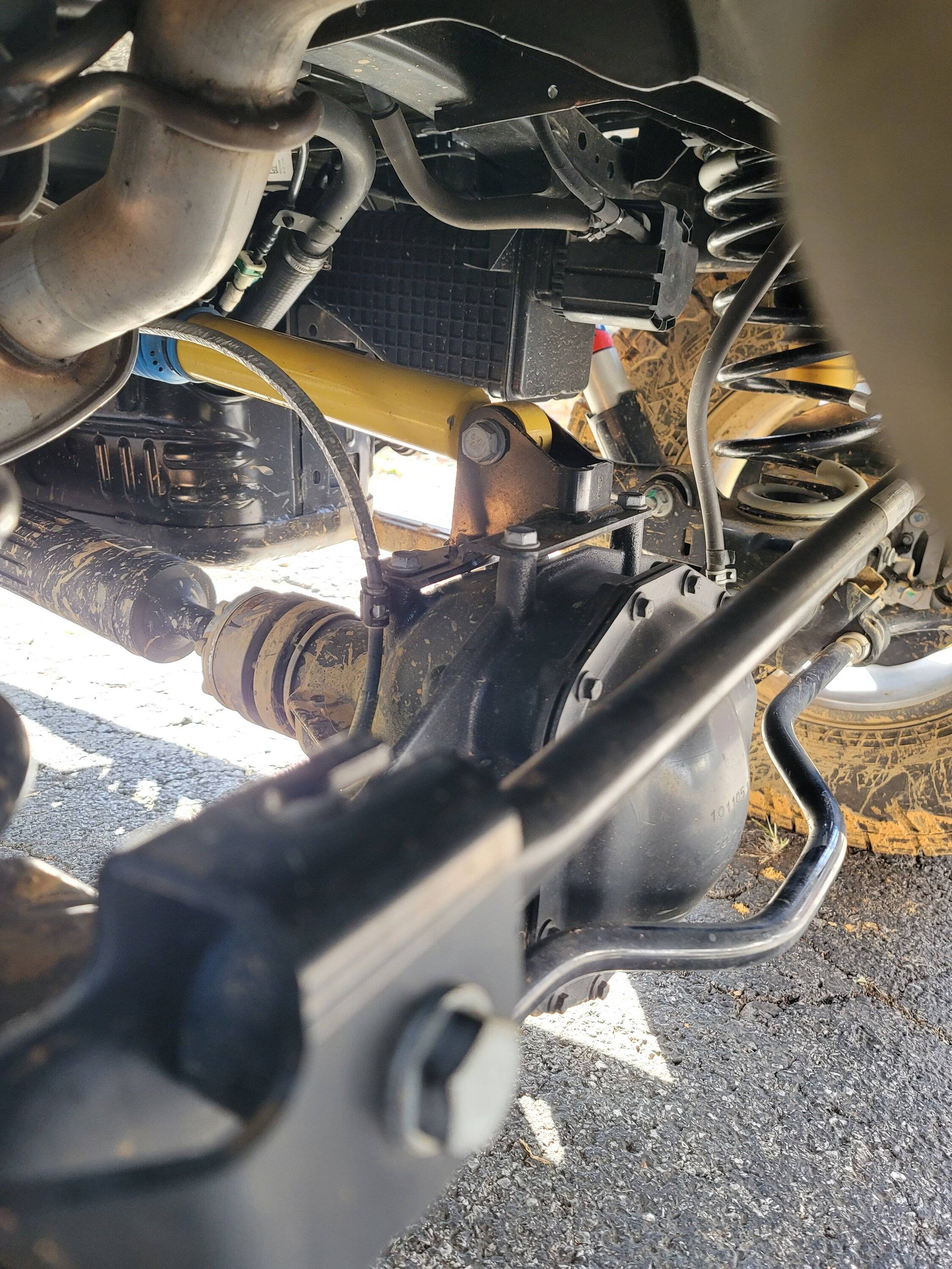

It was only me....so I need a hand to secure a wrench to the back of the bolt so it doesn't spin, then a hand on the torque wrench so it doesn't pip off, and a hand on a floor jack. That's more hands then I've got!!
That being said I do like the thought.
Honestly if I just had another person so I could get 2 hands on the torque wrench it would be all good. That's why the lesson learned is have a buddy with you for that part!
The force on the torque wrench keeps it from popping off the bowl. The nut can be held on by a wrench that's wedged against the crossmember.
Plus, if you do one side at a time then you don't have to raise the vehicle up on jack stands.
