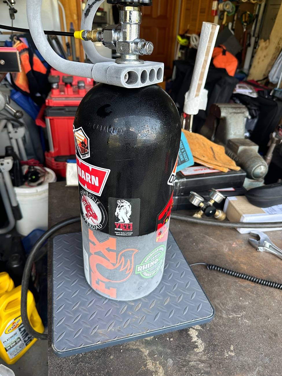

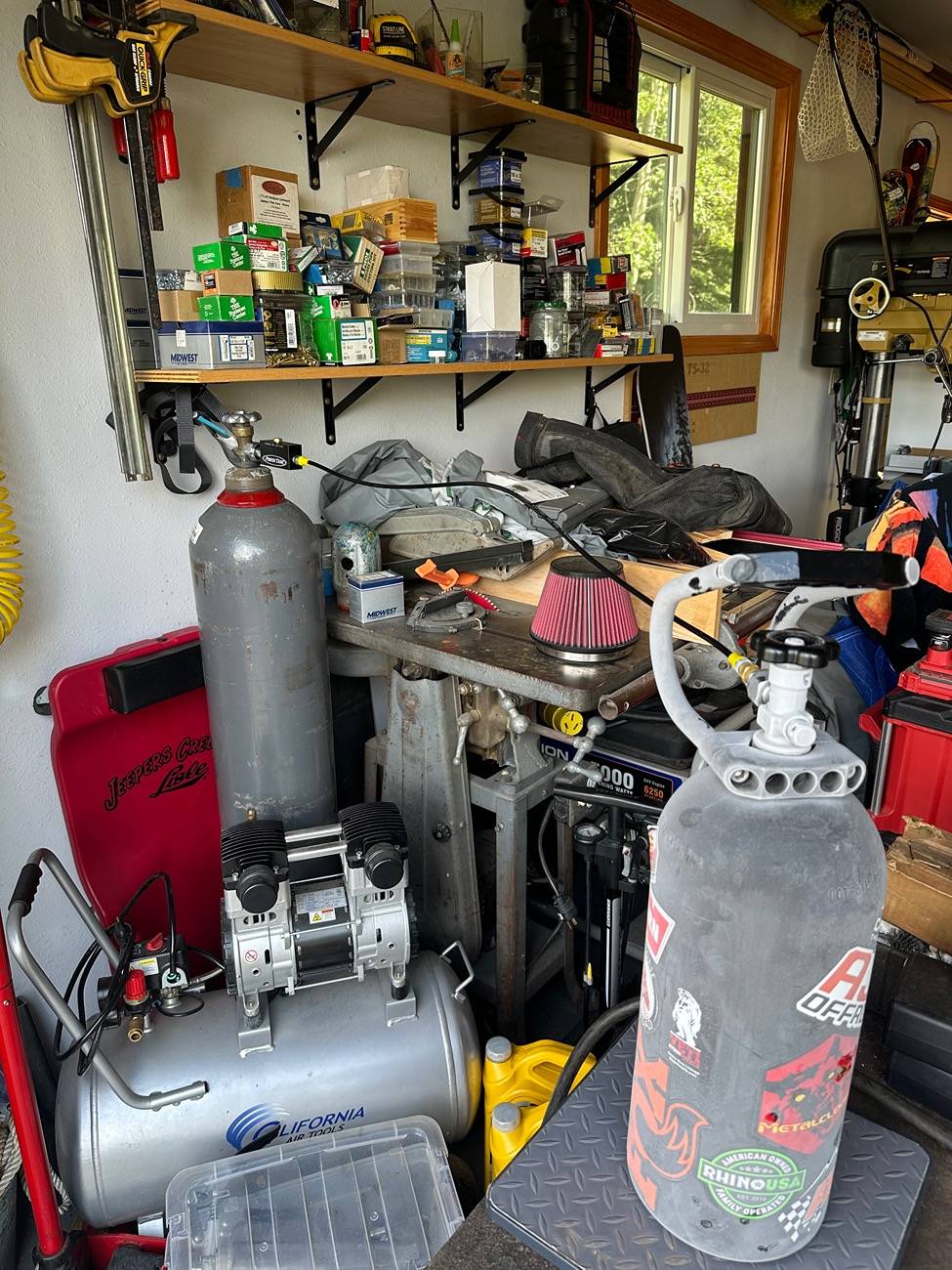

Any time. I’ve loved it. Zero issues with anything. Their support is fantastic as well. I asked some questions when I got it as I was new to co2. I’ve been doing my own refills for about a year now. It’s cheaper than paying the local shop. I have a 50lb tank in the garage that’s under $40 to refill. I get 4+ refills of the 10lb with it. And I can do top offs instead of having to wait for it to be empty. The trick is to have a large tank with a dip tube so you’re getting the liquid co2 at the bottom. Then use a cheap scale to figure out how much to put in. My empty weight with the handle is around 16lbs. So when it hit 26lbs I know I’m full. The other trick is to freeze your 10lb tank before filling it. I put it in the freezer overnight.
