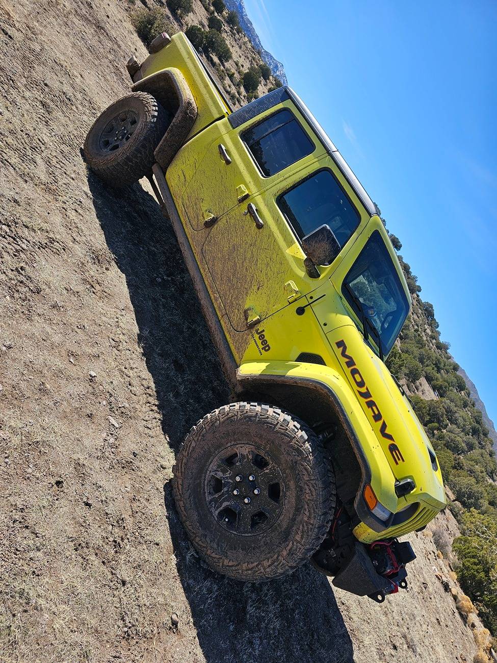

The shocks could use some more travel but are by far the best factory shock ever offered on a Jeep. I'm trying to get the Jeep to ride as good as possible at speed in the desert as that is my use, so any non-resvoir shock that is less than 2.5" body is a substantial downgrade for me. After the wheeling trip pictured below, I have added a set of metalcloak sway bar disconnects up front to help the 3 wheeling. I'm also adding the rock krawler triangulated rear 4 link to minimize the side to side motion of hitting bumps at speed soon. Eventually I'll add either long arms or drop brackets to the front to minimize the front axle arc travel, but I don't feel like they are necessary by any means. With only 2" of lift the axle is only 1/4" to 3/8" off center so I don't feel the need to go to an adjustable track bar. Obviously the spacer kit isn't the be all end all of suspension upgrades, but it's very complete for what you need at 2". It works great and retains the factory ride very well. The combination of bump stop extensions and shock extensions not only let you keep the great factory shocks, they keep them within their designed ride zone and bump travel zones. In my opinion that's why people say the metalcloak kit that retains the shocks doesn't ride well. It's not because the shocks and spring rates don't jive, it's because the amount of lift vs shock extension and bump stops aren't equal putting you outside the designed ride and compression zones of the bypass shocks.
