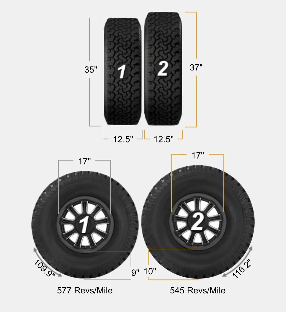

I thought if I go from a 35 to a 37 I gain 2 inches of ground clearance, in terms of losing an inch in the wheel well that makes complete sense except I'm running a higher clearance fender so that should off set the 2 inch loss, right?
You are gaining 2" of diameter. That is spread out over the full diameter of the tire. So you are only gaining an inch on each side.
Jeep Gladiator Let me know where my thinking is off regarding the need to lift my Jeep 81355028-FB52-452F-9271-5F4647B383C6
Think of it this way. You put that 35" tire side by side with the 37" tire. To have the center of the wheels match you would lift the 35" tire up 1" to match the center of the 37". So that is 1" more of ground clearance with the 37".
Got it, and thanks it makes sense now.
Also not all tire brands and models measure the same.
My 35's are 34.5"
So in theory, you could have really tall 35s, say the measure 35.25" then go to 37s that only measure 36".
It happens.
