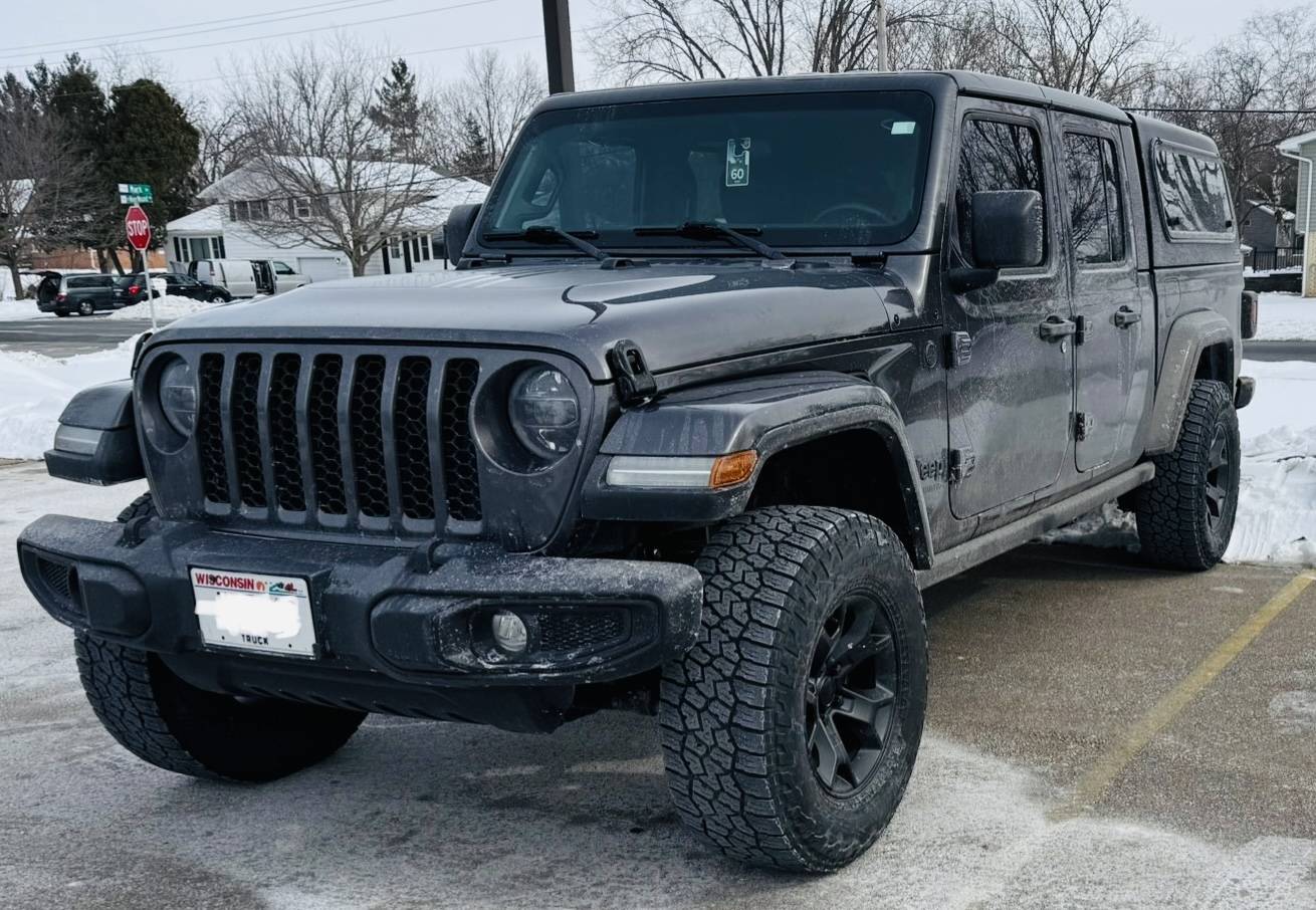

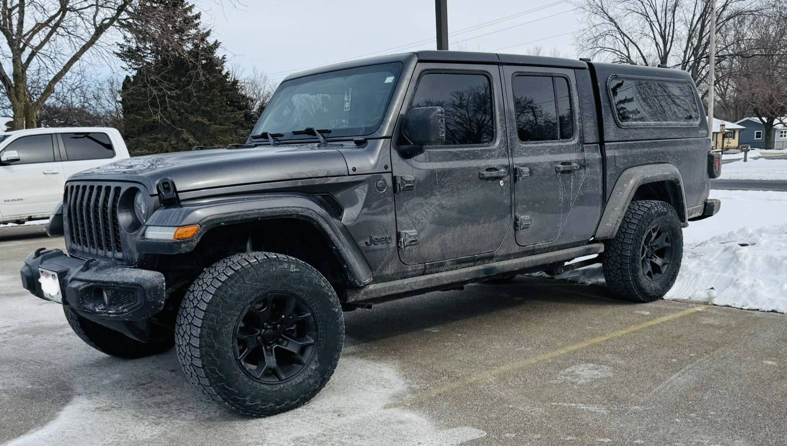

Thanks for all of the replies.
Today - I punched the trigger on the Teraflex 2.5 spacer lift - along with the Teraflex lower control arms, and front/rear track bars - AND billstein 5100s for the rear (I had them up front after my TF 1.5 level a year or so ago).
Installation is NEXT Monday!!
Will be riding around on 33s until they wear out and I'm okay with that until thinking of going larger.
@RodRecket had an old build of his JT with a 2.5 and 33s and I thought it looked great! I even have the same wheels already on my JT.
