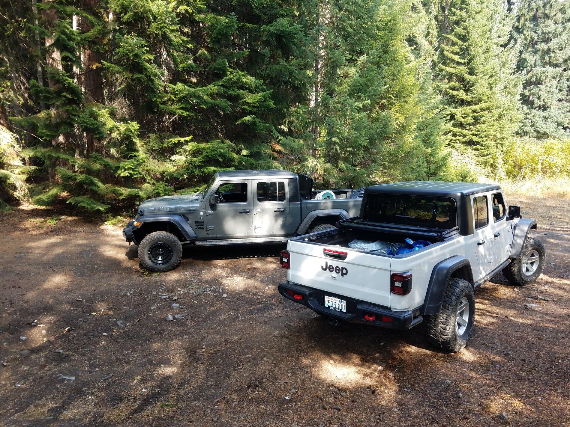

Regarding your question about looks with the stock tires, you have a Rubicon with 33" tires so it will not be as noticeable as it would be if you owned a sport.
In the pic below, my friend's Stingray Sport Max Tow has a Mopar 2" lift, and stock Rubicon size 33"tires on aftermarket wheels. My white Rubi has a 1.5"/.75" level spacers on 35's.
