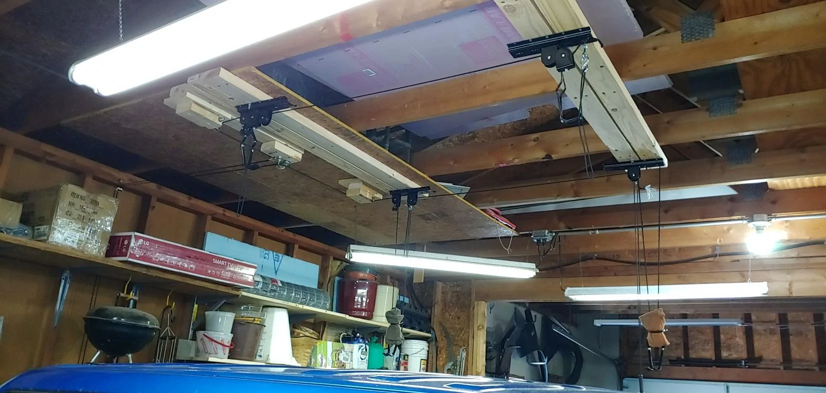

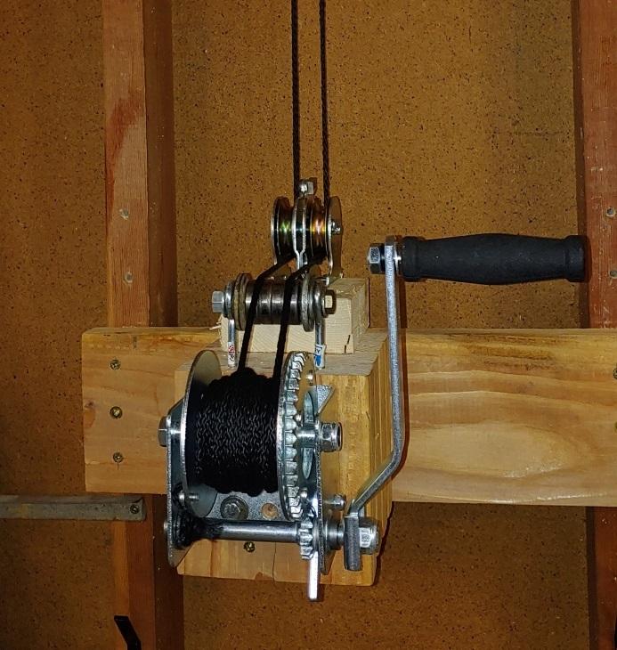

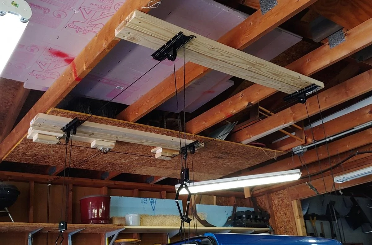

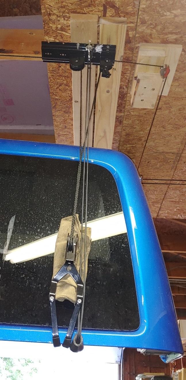

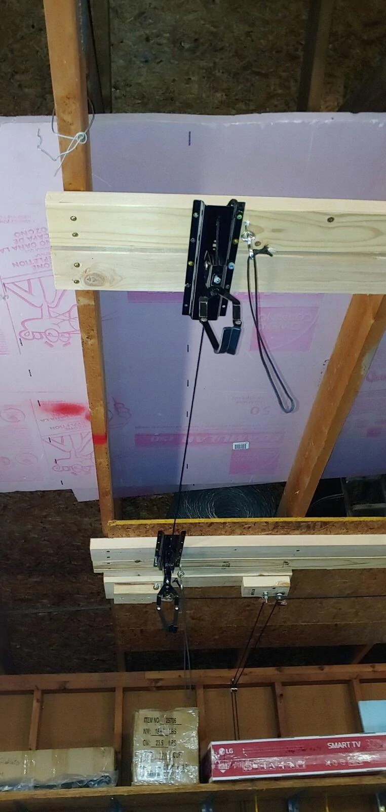

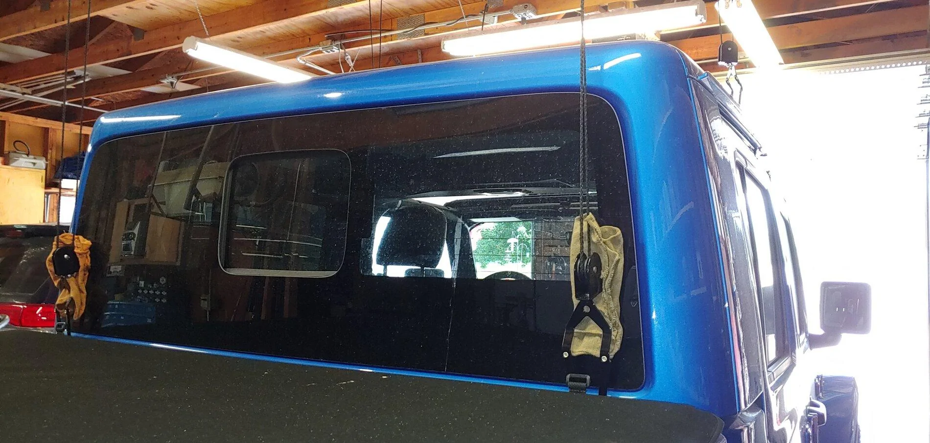

Some have a way to lock them - if not, drill the winch and put something through to lock it.

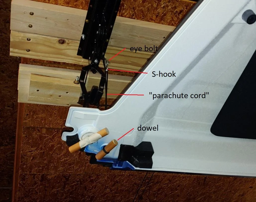

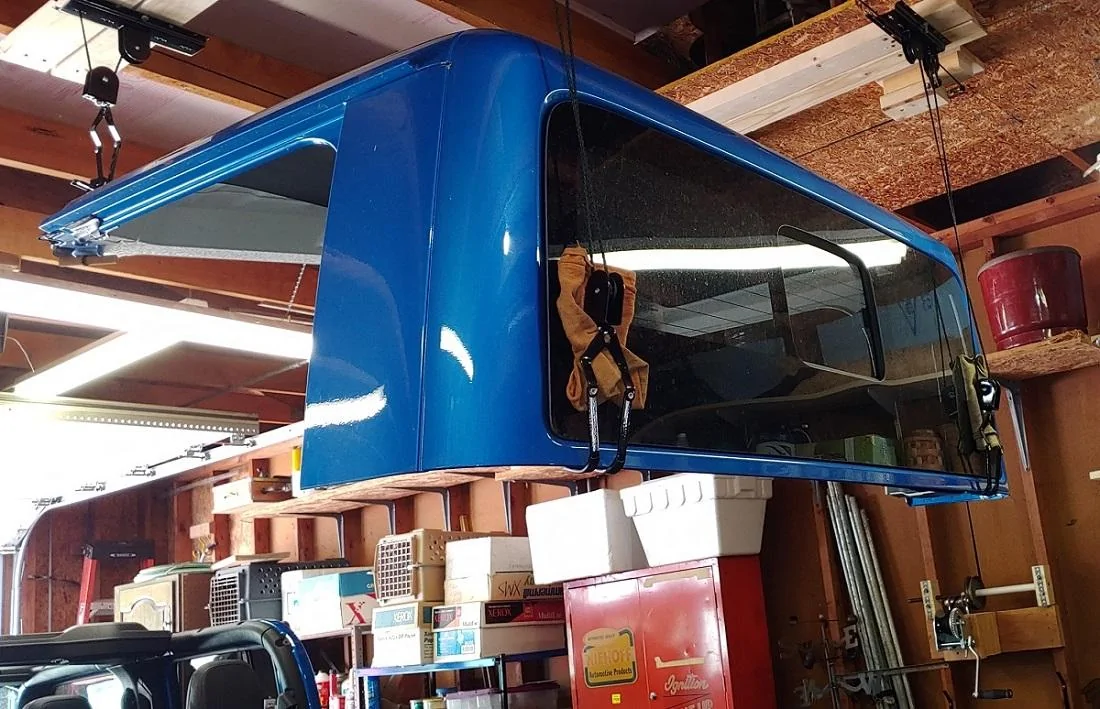

In my case, once the top was up I had some hooks in the ceiling and used cord at each corner to secure it. I could totally release the winch and the top can't come down at all.
The extra loops hanging down - once the roof is up those go through holes in the roof and a dowel in the loop below to secure it.
Jeep Gladiator Lift / hoist for top? 20201004_124926
Jeep Gladiator Lift / hoist for top? 20200714_165042
Jeep Gladiator Lift / hoist for top? 20200714_164936

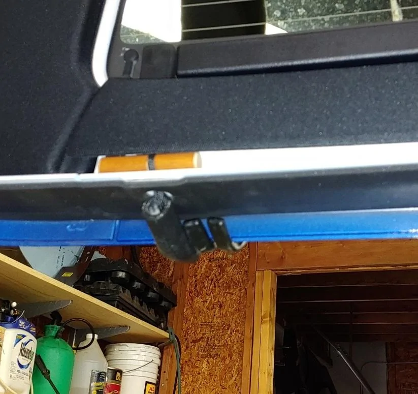

Safety cord with dowel to hold it. Hooked into heavy screw eye in the rafter.
