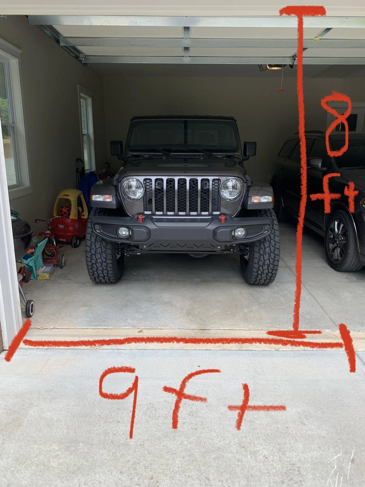

I have a huge garage, so I have no issues. Here are some dimensions for you to consider as I don’t know what standard garage dimensions are. Mine fits easily into the dimensions shown in photo. Nothing professional, but you get the drift :LOL:
JKS 3.5 Lift with 35x12.5 tires - Top of hardtop on Gladiator is about 6’5”.
Jeep Gladiator Lift/tires vs standard garage opening 4D98E78E-ADD5-4AC9-9A8A-6F10DBC74DED
