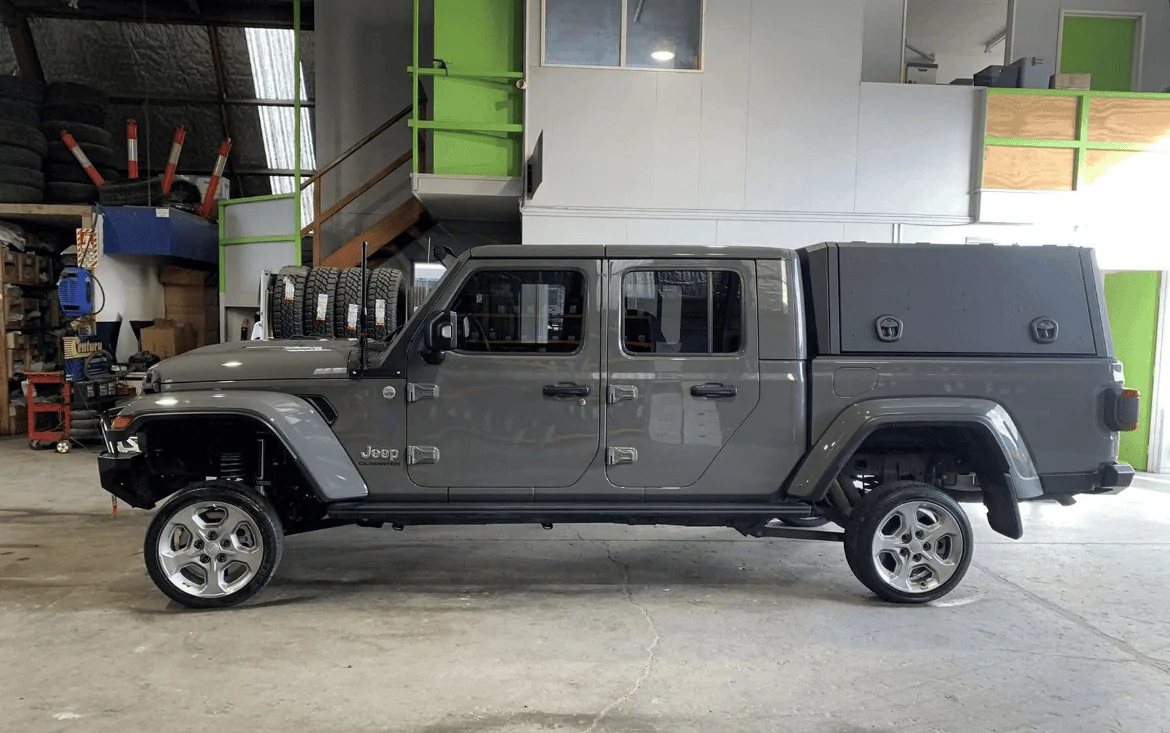

What was it like driving on those tiny wheels? It does look hilarious.
He had to feel every pavement joint he came upon, and bird crap made for a jolt.
