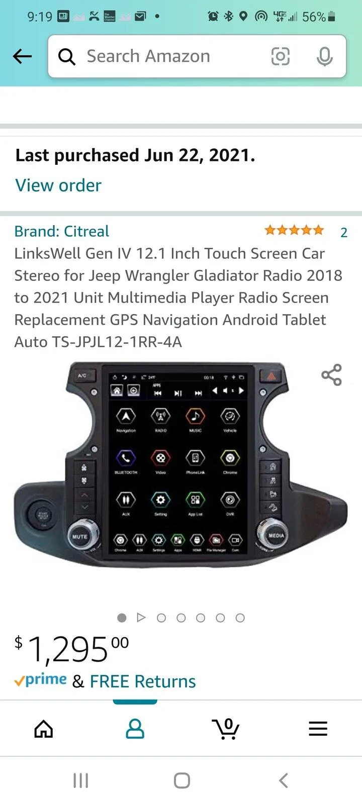

Ordered on Prime Day for $1039!! Should be able to get it installed next week.
