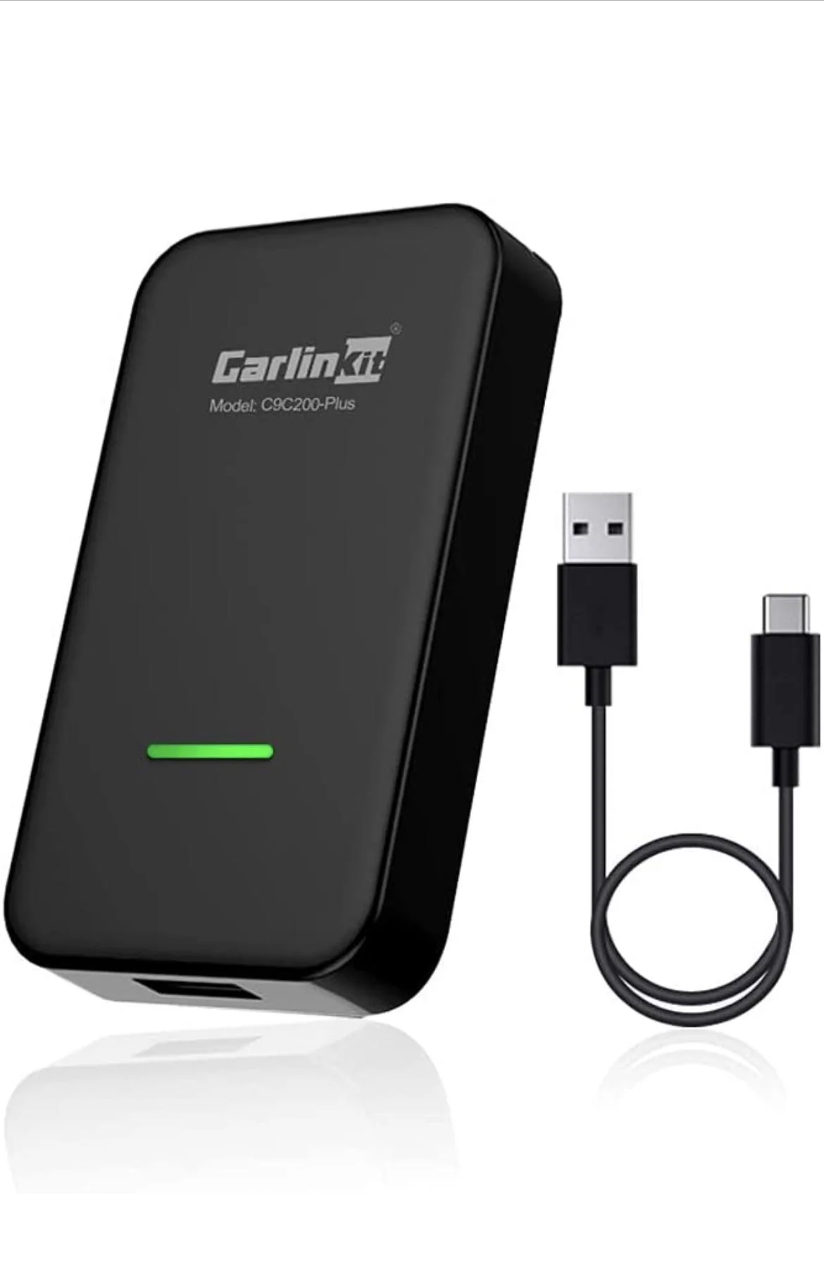

Anyone know if wireless CarPlay adapter is compatible with this unit? Just bought the Garlinkit and am wondering if it will work here

it comes with wireless android auto and carplay already
