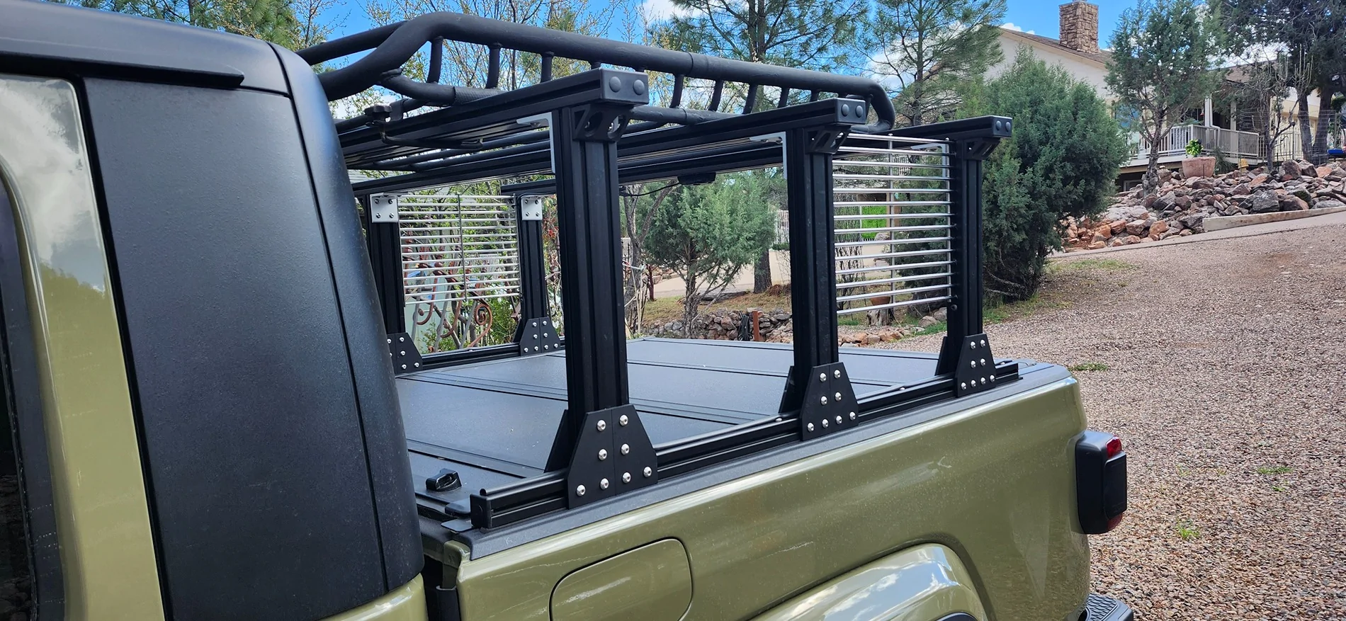

Just build your own using T slot material from places like TNUTZ or 80/20. You could make it as high as you want and it will accommodate heavy attachments. Its cheaper (~$800) than buying some of the ones made from sheet metal and is far stronger since it's all solid aluminum extrusion. I have the trifold cover that had to open and there aren't any out there that would accommodate it.
Jeep Gladiator Looking for Bed Rack suggestions that work with trifold tonneau cover 20260310_141334
