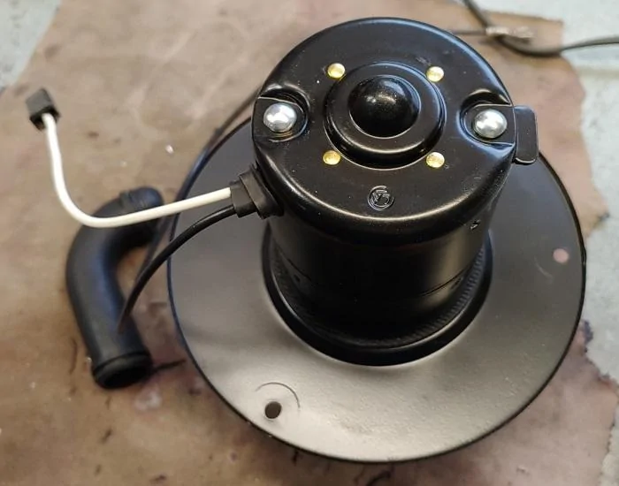

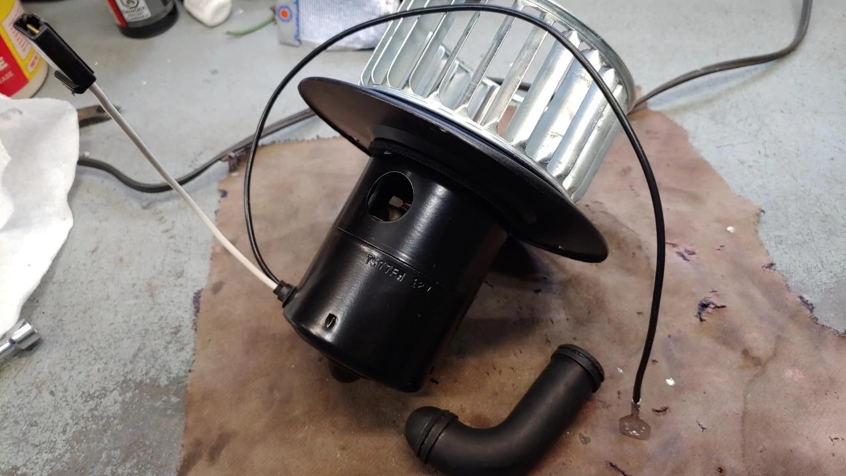

I'm needing to "specialize" a bit more in my shop work and let someone else do what they do best with the correct tools. Thus, I am looking to find someone who can make me up a bunch of the following wire leads as shown in the photos below (for money, of course!)
I restore classic car electrical parts and do plating for people restoring AMC cars.
Among the things are restoration of the HVAC blower motors. Restoration means new wire leads not just for safety, but because the wires show.
I don't have the correct proper tools for the types of crimps these need, and I've not been able to find the correct terminations - like the ground look or the hot lead connector.
I spend my time on the motor itself, prepping, powder coating, plating, any repairs needed internally, new brass rivets for the bushings/bearings and such and it would just be more cost effective to pay someone who already has the correct tools and could knock these out in minutes.
My wiring tools date way back and aren't the highest end for this type of connector plus - I've had an impossible time finding them.
The wires are 14 gauge copper, white for power, black for ground.
Frankly these danged things are the sticking point. Too much time being spent trying to find the connectors and then make them right.

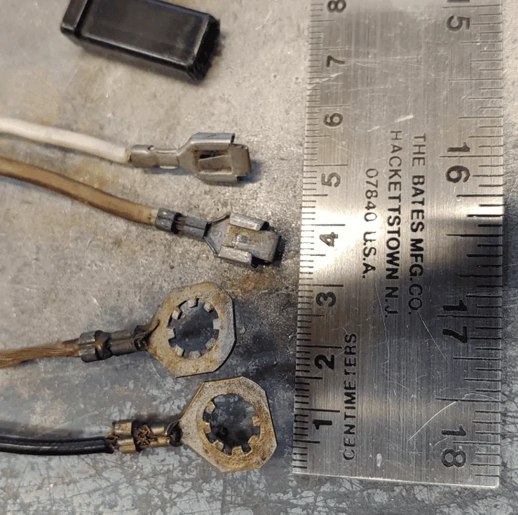

The crimp is the easy part.
Finding the terminals, especially the push-ons, will be a challenge.
Do you have some pictures showing more details? And how long do the leads need to be?

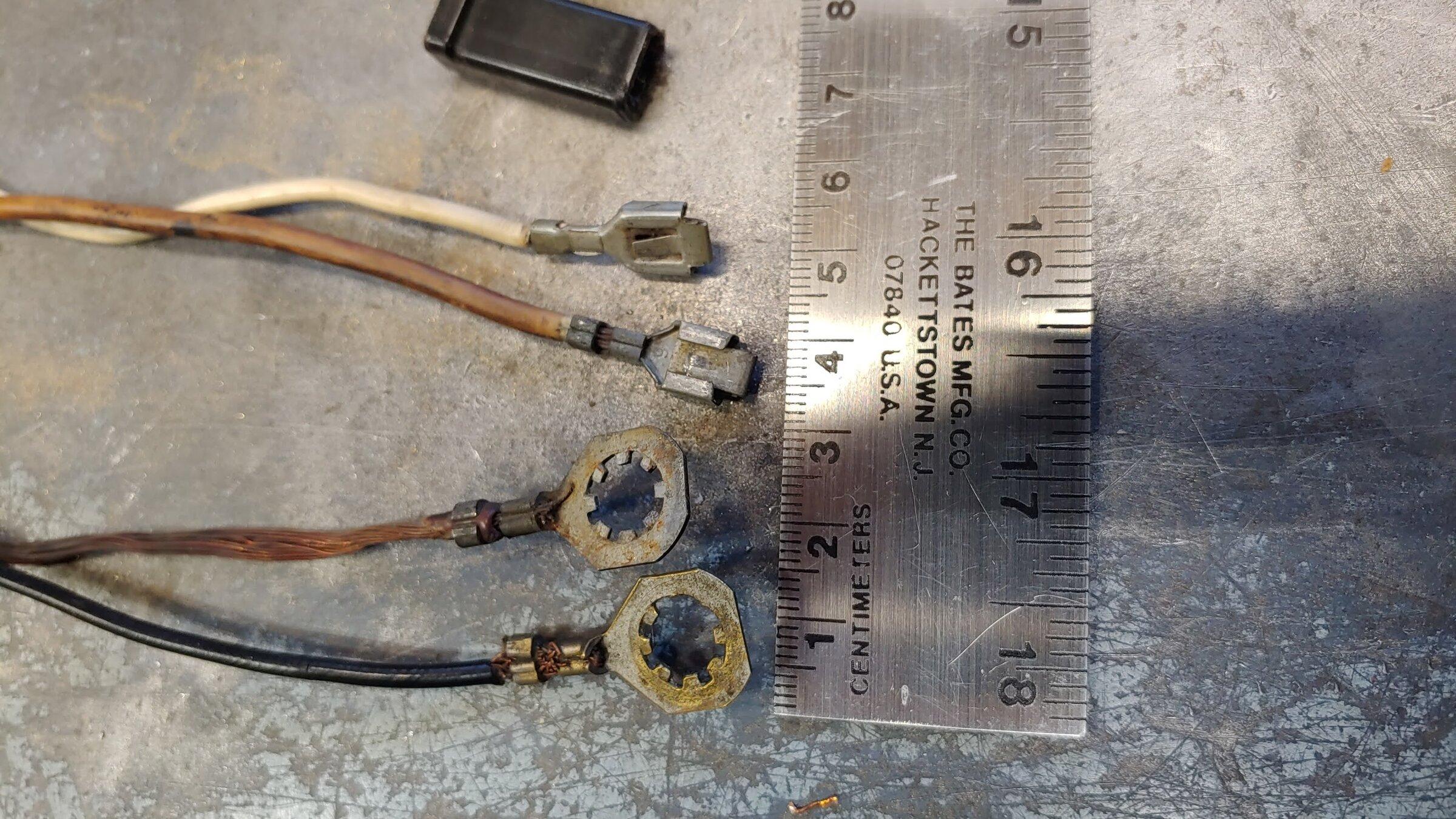

I can give as many details as needed. 14 gauge wire, and I have the notes on how long the black needs to be vs the white (shorter)
The plastic shell, as I call it, isn't a problem. Those are seldom damaged. I'm not worried about the black piece that pushes onto the terminal. I remove and clean and re-use those and have rubber maid tubs or wiring harnesses I can salvage those from.
It's the terminal within that's the problem, and my crimping tool dates way back and is a generic used for multiple purposes.
I can send one of each of the original terminals or even original leads complete as I have blower motors I use for parts, too.

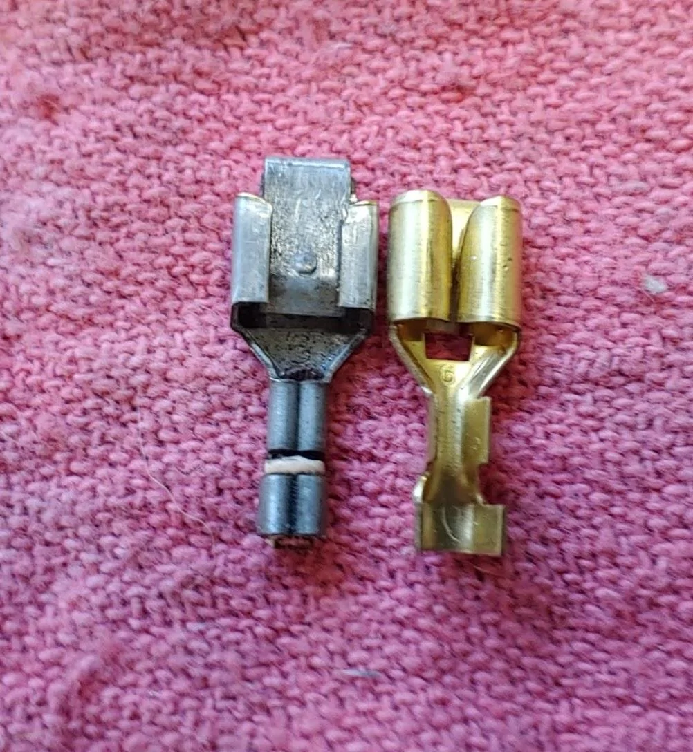

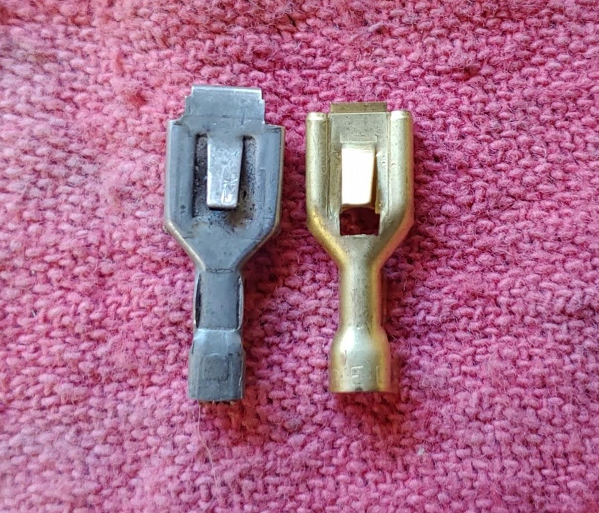

No, but if you look at the connector itself, it has two "notches" in the end and the terminals I have found, the type that has curled edges that the flat slides into, don't fit the shell and by the time you notch those to fit the shell there's not a great connection, besides having to put a wheel in the Dremel and trim the corners of every single connector and make sure it fits the plastic shell - and will make good contact and doesn't sit back too far in the shell.
Check out where the lock tab sits on each type, and how much of the connector sticks out to make a connection or is left up inside the shell.
I'm not concerned about looks inside the plastic shell - just that it does't sit so far back it only makes half a connection (it's high amperage and gets hot at the resistor).
To make total contact when pushed on, well, these don't until the thing is pushed half-way on and I have to modify each one by hand to make it work.
They can be either type - but the ones on the right don't fit, they sit back in the shell and are off to the side inside the plastic - and - you have to trim back the end corners to make them fit and snap in.

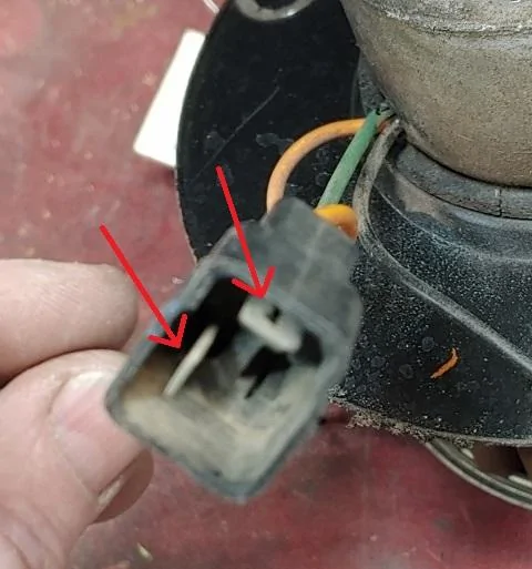

Those appear to be molex locking/star ring terminals and spade connectors. That 1/4" piece isn't looped back to add another spade and possibly broken?
40,496
54,011
No, and it's not a type that has a "release" like some similar terminals have. There's no switch-back for a piggy back.

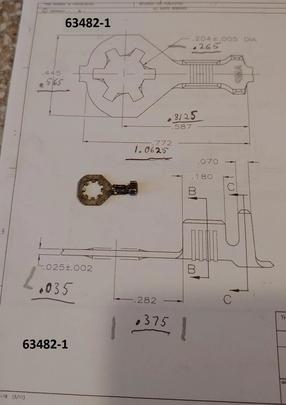

I got the heavy artillery out as far as measuring things (micrometer and steel rules) and two of those numbers are spot-on but one is a definite no-go.
640417-2 - good, a perfect match
640416-2 - good, a perfect match
63482-1 - not a good match. LOOKS correct but size is wrong. So back to the drawing board on that one.
I have engineering drawings of each and compared, and wrote my measurements next to theirs so it will be easier to compare now.
I added the measurements of the connector (ring terminal) I am trying to match to the drawing I got of 63482-1, which is a bit small.
