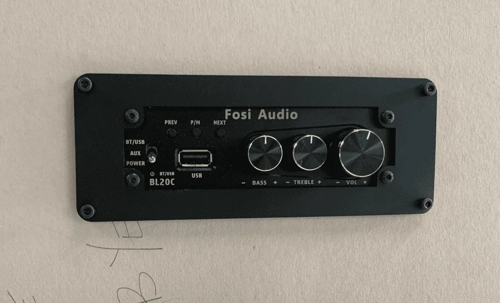

Just putting my two cents in - I've used Ponoko with great results. Your parts are flat, which make them ideal for their service. Relatively inexpensive and tons of materials to pick from.
I wanted a way to wall-mount this amplifier and they were great to work with.

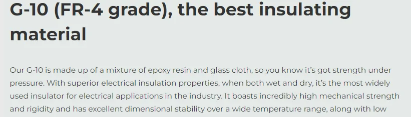

I'm looking at this material - a close match to the original material from what I can find.
Jeep Gladiator Is it possible to "print" these parts? 1666232164370
Jeep Gladiator Is it possible to "print" these parts? 1666232248506
The make-up of the material is likely as close as one can get with modern materials.
Jeep Gladiator Is it possible to "print" these parts? 1666232329950
The thickness matches the original very well -

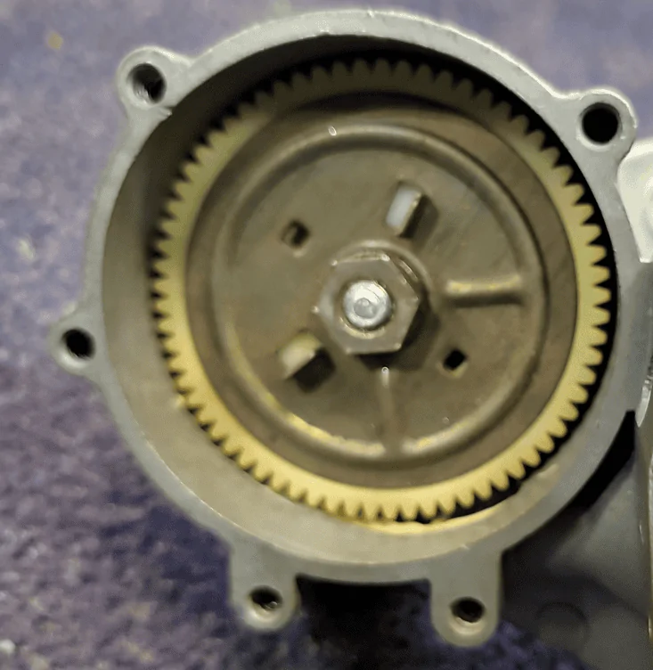

I did disassembly a NOS (new, old stock) wiper motor today I'm making look new again for a fellow doing a really high end restore on a rare car and it's a perfect example of the part I've been talking about.
If better shots are needed. It shows the original material pretty well, too.

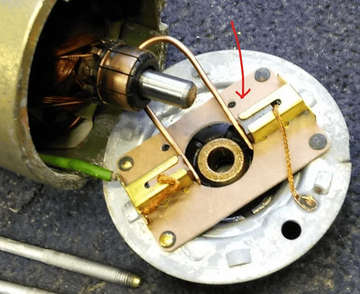

This piece is really a lot like the material used to hold brush holders in some small DC motors - about the same material. It's fairly fragile. I have to be EXTREMELY careful removing rivets and get the new ones in just right or risk breaking off the tiny corners.
(I could actually use some of these rectangles, too, as the corners break off so very easily, even when really careful)
