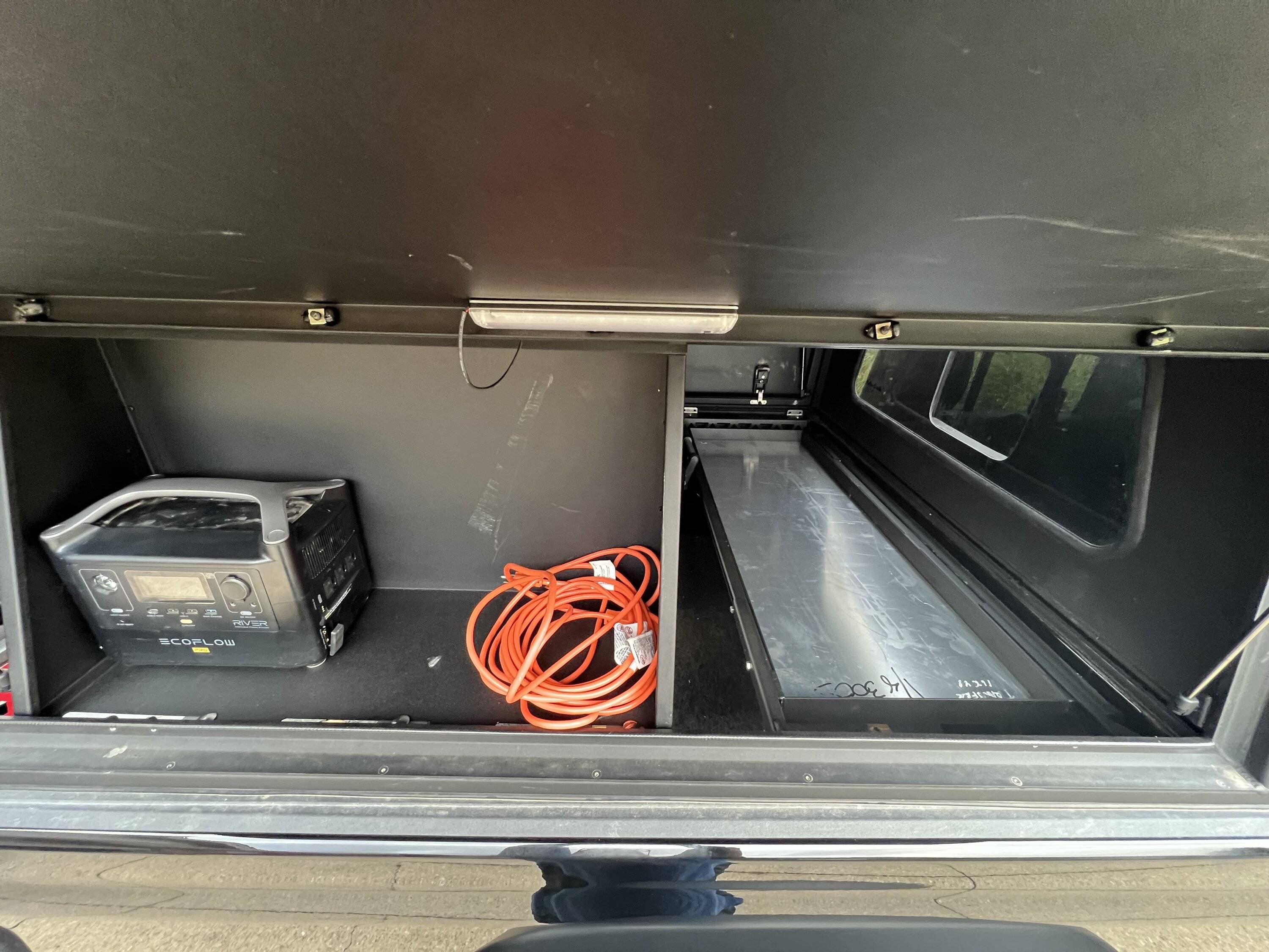

This is the rail system from Ali-Cab for the Wolfpack storage containers. You can see the piece of aluminum that I dropped in. Also a shot of the cabinet that I added a couple of months ago. Need to add shelves or maybe just some

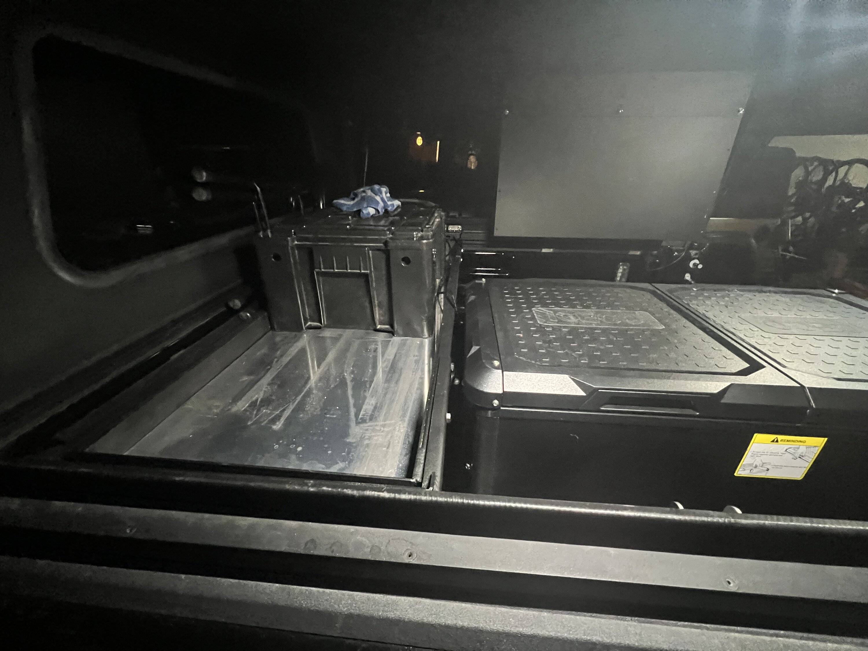

Here is the Wolfpack rail from the opposite side. I was really worried about whether it would all fit but got lucky I guess. You can see the fridge has about 1” of space left at most.

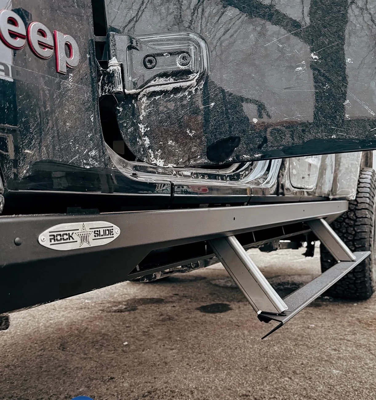

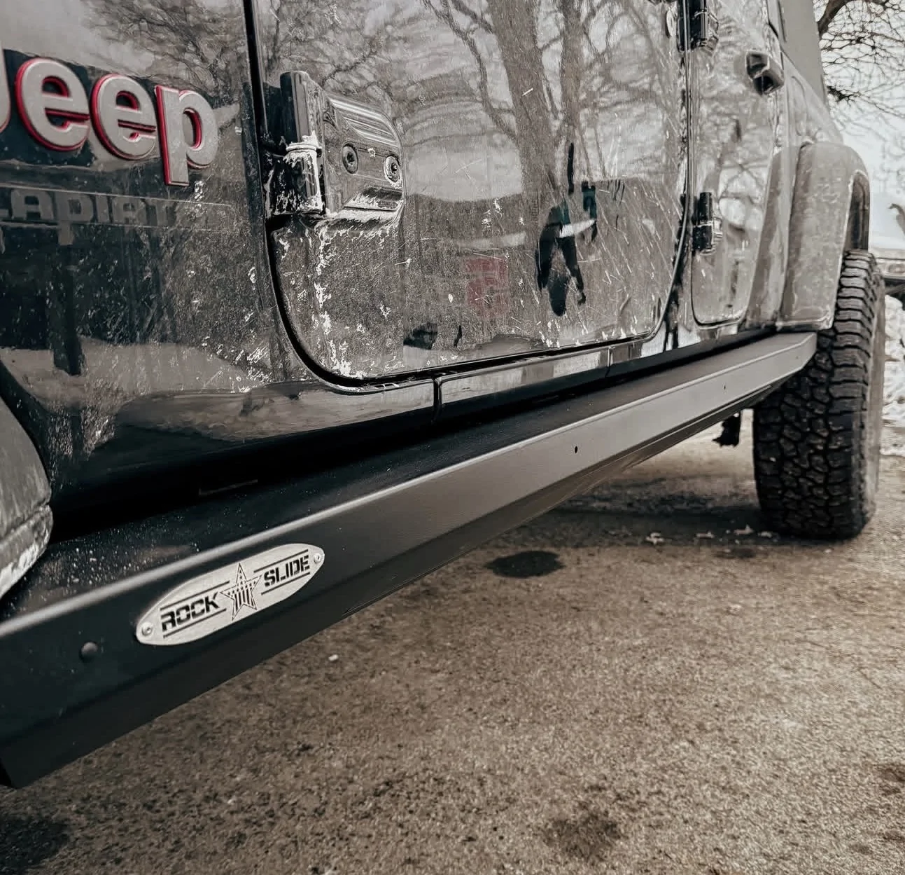

New Sliders installed. They are amazing and make it much easier for me to get in and out being that I am vertically challenged.

Any guess on how heavy these are? I've been eying them for a while, but skeptical with the winter roads here in MN.

I am not sure of the exact weight, I would say they are about the same as my HD sliders I had installed on a Tacoma a few years ago. I don't think there is any real way to save weight on sliders as they are there to protect your rocker panels and doors from crunching. Now that I have had them on for a few weeks, I would highly recommend them. Very well built and love the drop down step for the shorter folks plus the kids can now climb in on their own which they were pretty excited about.

50-60 lbs per side.
Rock Slide Engineering (RSE) Gen III Step Sliders for the Jeep Gladiator (JT) are heavy-duty, powered retractable steps made from 10/11-gauge steel with a 650 lbs per step weight capacity. They weigh approximately 50-70 lbs per side (100-140 lbs total), with some listings suggesting a total kit shipping weight of 225 lbs

Thanks for the clarification. My personal opinion, there are lots of places on the truck to try and save weight. Sliders, in my opinion, are not one of those places and that's probably why they are all on the heavy side.

They also make the extra attachable armor which adds quite a bit of weight. If you do go that route I believe it's easier to put it on before you install the sliders. Plus unless you've had the body mount bolts loose already. Then get a bolt heater to help release the red loctite. Otherwise you risk breaking one of those bolts. Good luck with install. This forum has a plethora of knowledge on this subject.

Installed and work really well for us shorter stature types. Will have to add the extra protection later, the core sliders were a pretty large investment already.
