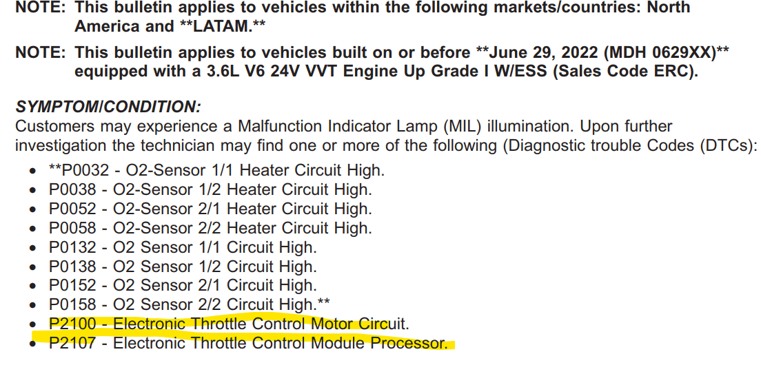

Was accelerating to merge into traffic, all of sudden lost power and cannot accelerate. It threw an error about traction control, auto start/stop; thankfully I was able to coast to the side of the road. Restarted the car and I was able to drive but with a check engine light. Pulled the codes and it was P2107 & P2100; any ideas?
2022 Rubicon with 273 miles.
11,790
31,485
A little google searching.
P2107 is a general OBD2 trouble code pointing to a malfunction within the throttle control module processor; the throttle actuator motor fails to operate and this is detected by the Engine Control Unit (ECU). Once the fault is detected, the ECU sets a Check Engine Light, which is displayed on the dashboard.
What the P2100 code means. P2100 is an OBD-II generic code which indicates that the throttle actuator control motor (TACM) circuit is open, as detected by the Engine Control Module (ECM). The throttle actuator will not work.

I believe there's a TSB for this - but in any case the truck is trying to tell you there's a problem.
There are TSBs with this same 2100 code.

Fyi, took my truck in for regular maintenance, and they flashed the fuel controller...so appears to have been a software issue
40,496
54,060
Fuel controller? You mean a PCM flash? There was an issue, known, related to the throttle body, throttle control motor. It's talked about a lot in other threads.

Yes, that. Sorry. Powertrain Control Module...fuel controller...same thing in my mind...BUT, I know nothing about cars!
