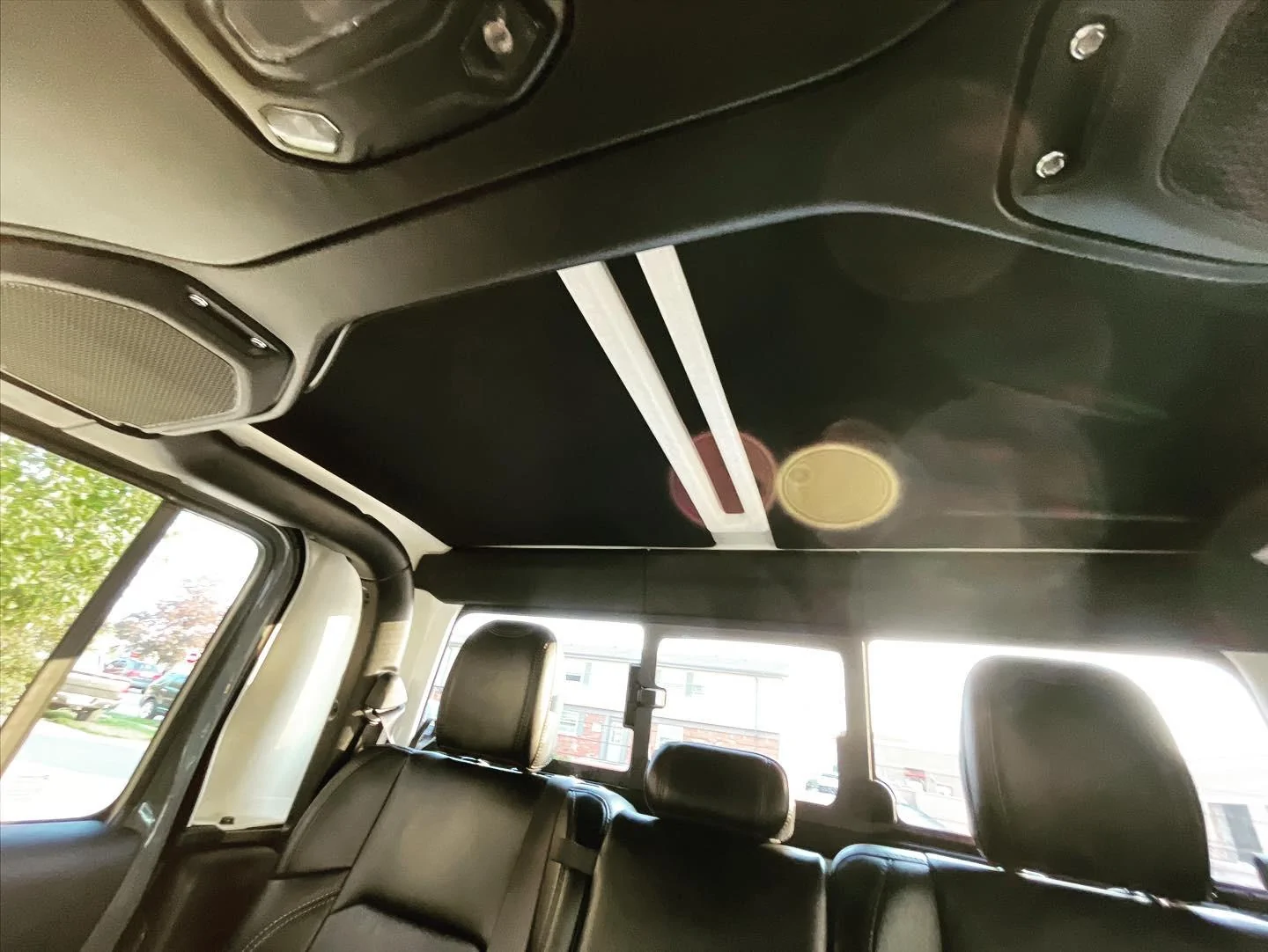

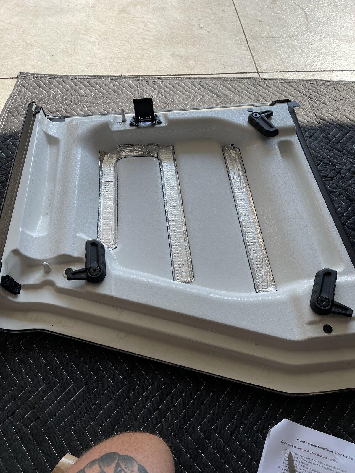

I installed a Hothead Headliner with the sound assassin strips, over the weekend. Noticeable road noise reduction (not dramatic), sound system sounds better and temperature control is drastically different. I would suggest researching headliners and see which would suits your needs.

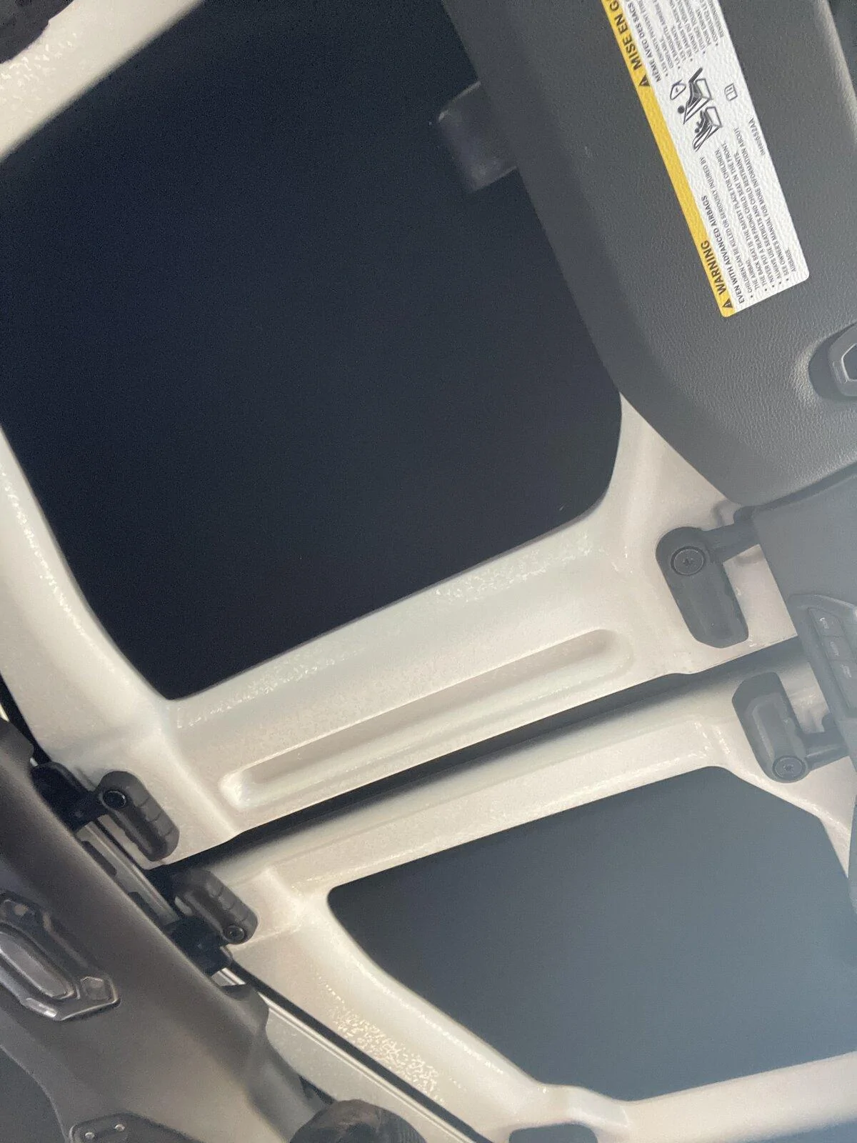

The front retainer brackets for the freedom tops are adjustable up and down using a torx head bit on their mounting screws. Adjust them down a bit to pull the front edge of the freedom panels down tighter.

IN the attached instructions, step 6 shows the small torx head screws to adjust the front, and step 3 shows the larger ones that allow the entire rear bracket to slide up and down.
