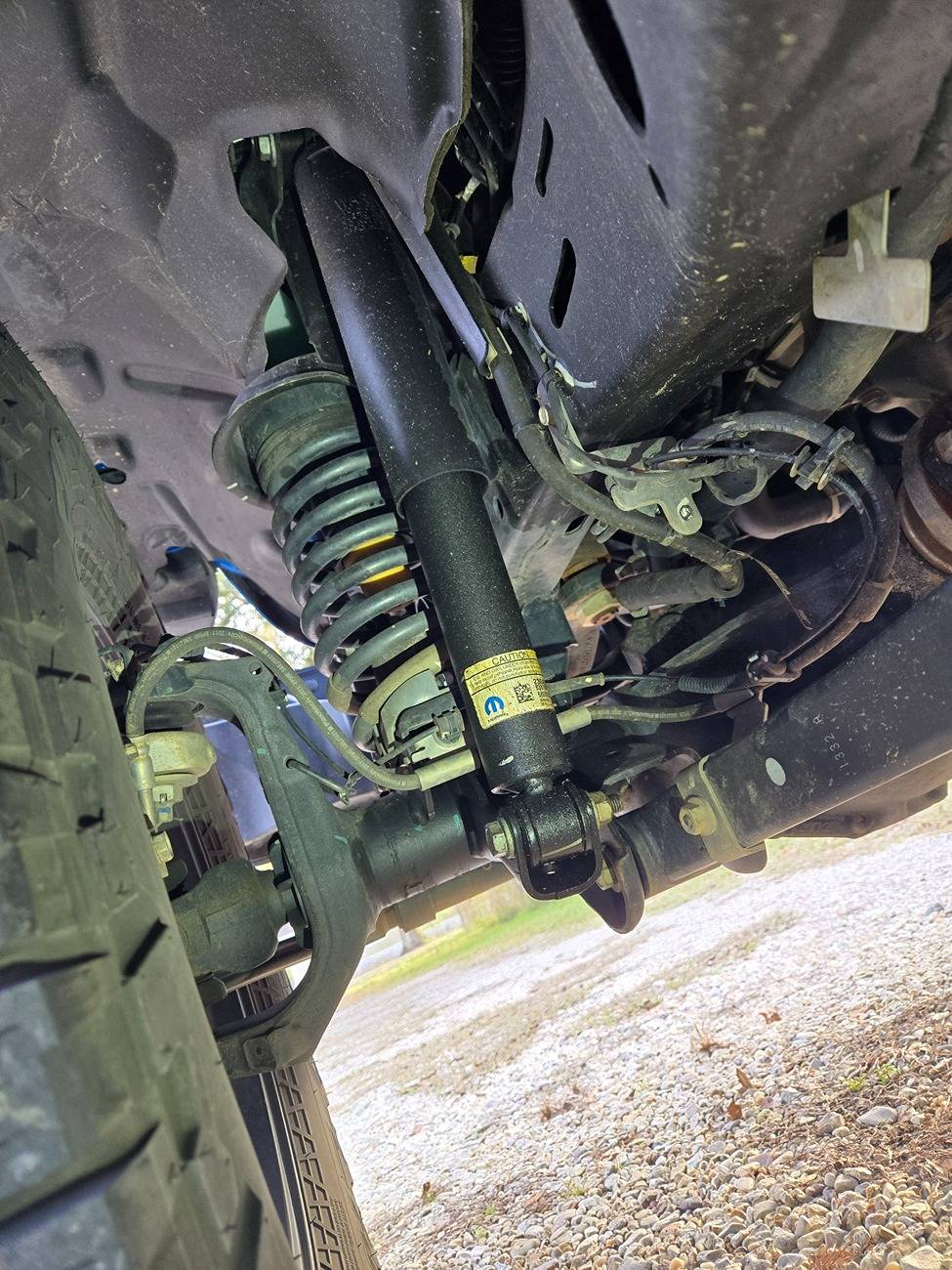

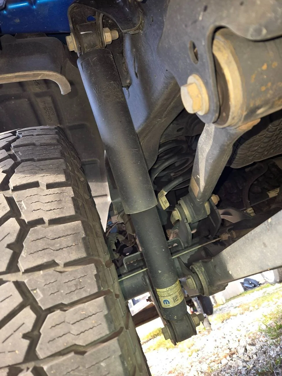

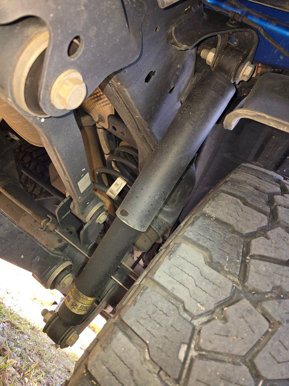

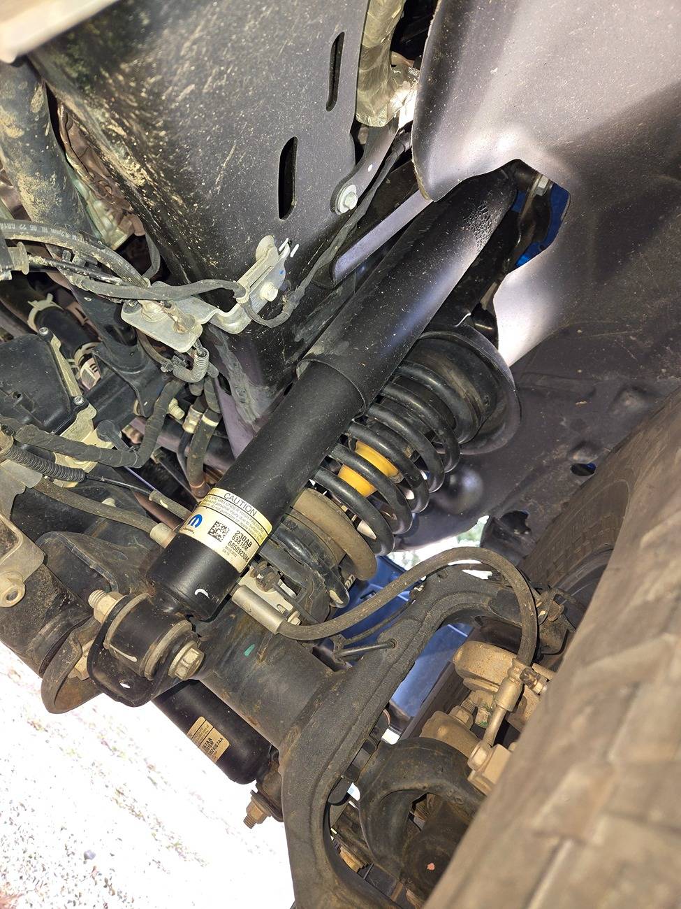

Been hearing a noise lately when going over the railroad tracks and figured it may be a shock. Rolled around under the truck and found one that is completely gone with oil dripping off the bottom (driver front), and another that has light residue and may go next (driver rear). Only 25K miles on the truck 😂 Anyway I ordered front and rear Bilstein 5100's from @Northridge4x4 to solve all this. I'm sure the really rough railroad crossing and intersection near my house twice a day (minimum) didn't help - which just so turns out, is rougher on the driver side...
Photo order is DSF, DSR, PSF, PSR.
