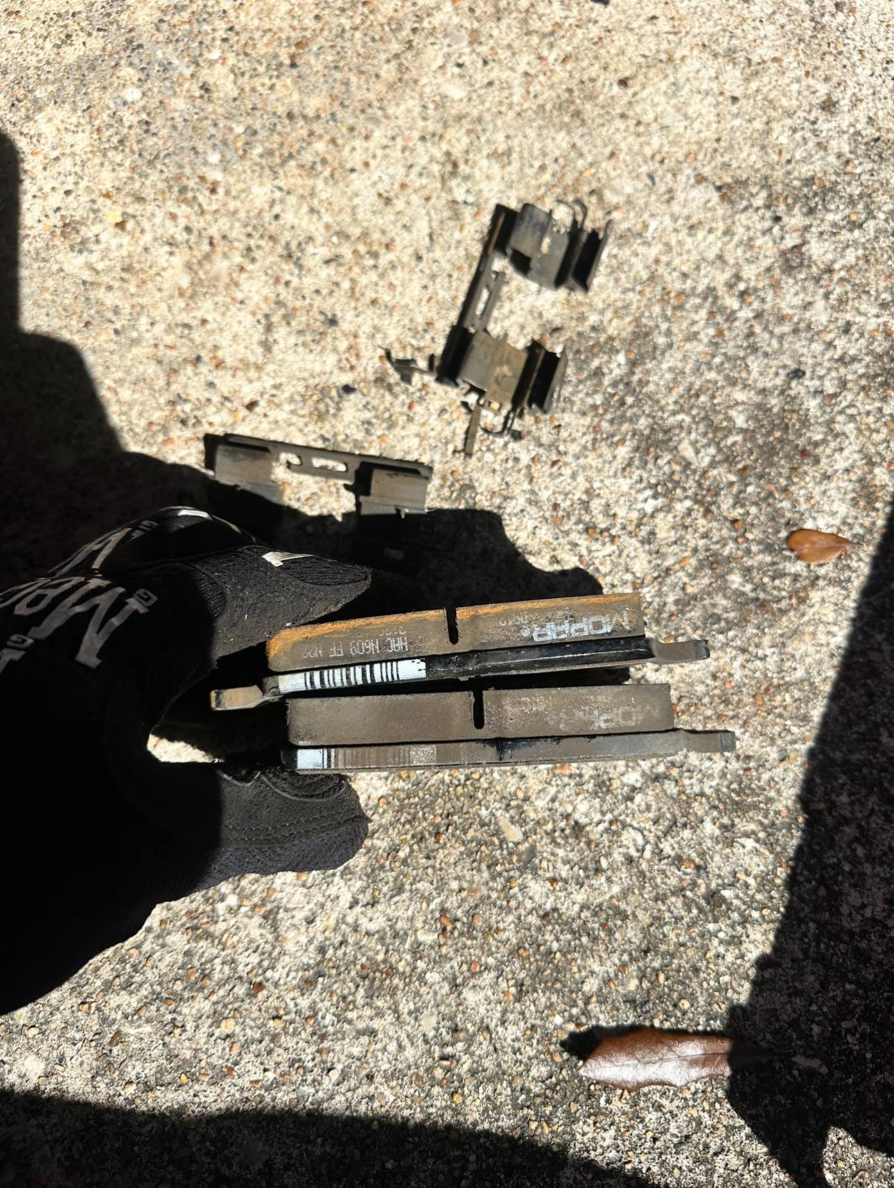

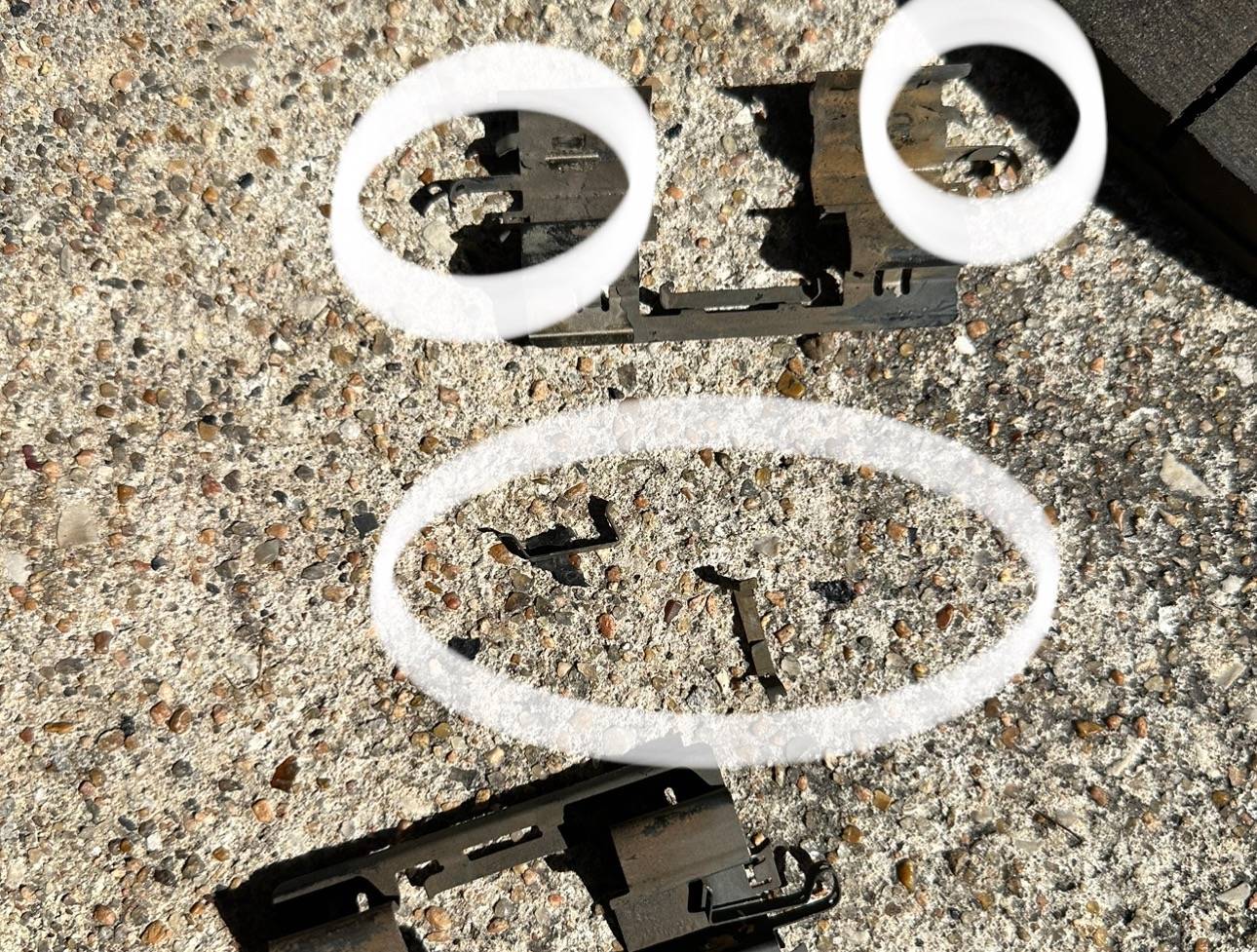

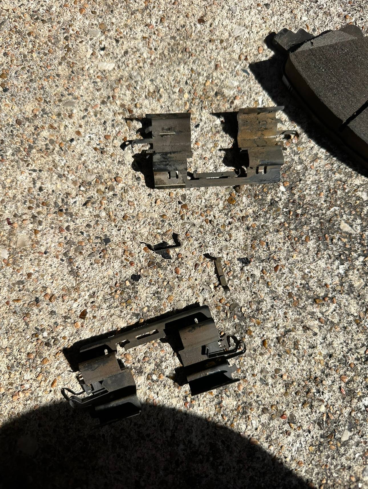

My gladiator started doing this last week and it was incredibly frustrating. I started at the most simple solution and threw the jeep on a set of jackstands and rotated the wheels and could not get the jeep to make the high pitched intermittent squeal. From there I removed the wheels and noticed that the lower clips on the brake pads on the rear and one of the front lower brake pad clips had completely fallen apart. The metal would slide up against the rotor and squeal at low speed. Then after getting up to speed would get pushed back far enough to be quiet for a few days. I will say that Mopar did a terrible job on these brake pad clips but the mopar pads seem awesome. I have had my gladiator roughly eight months or so and put 40k miles on it. The pads looked new front and rear. I went ahead and replaced them since i needed new clips but i am sure they would have made it to 100k. Once i replaced the brake pad clips i drove the jeep all weekend and she was nice and quiet.
