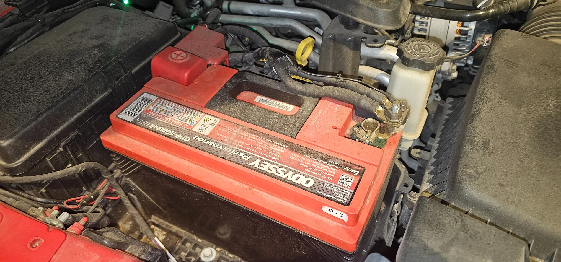

I got that Duracell Aux. So far so good. Odyssey main. Odyssey should modify their Aux to fit properly. I tried... didn't want to 'make it work'. It's the plastic casting.
Main, even matches the paint. =D

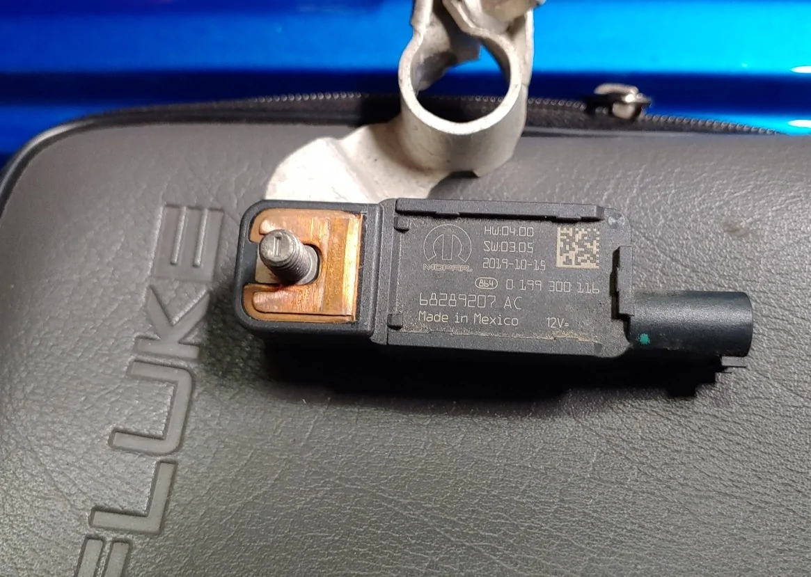

Did you disconnect the IBS that sits on the main battery negative terminal from that small connector while it was off to reset it?
Rules - when replacing batteries, ALWAYS fully charge the replacements before installation.
When replacing the batteries in a vehicle with the IBS on the negative clamp, disconnect the IBS connector for at least 20-30 seconds while it's off the battery to reset it for relearning the new batteries.

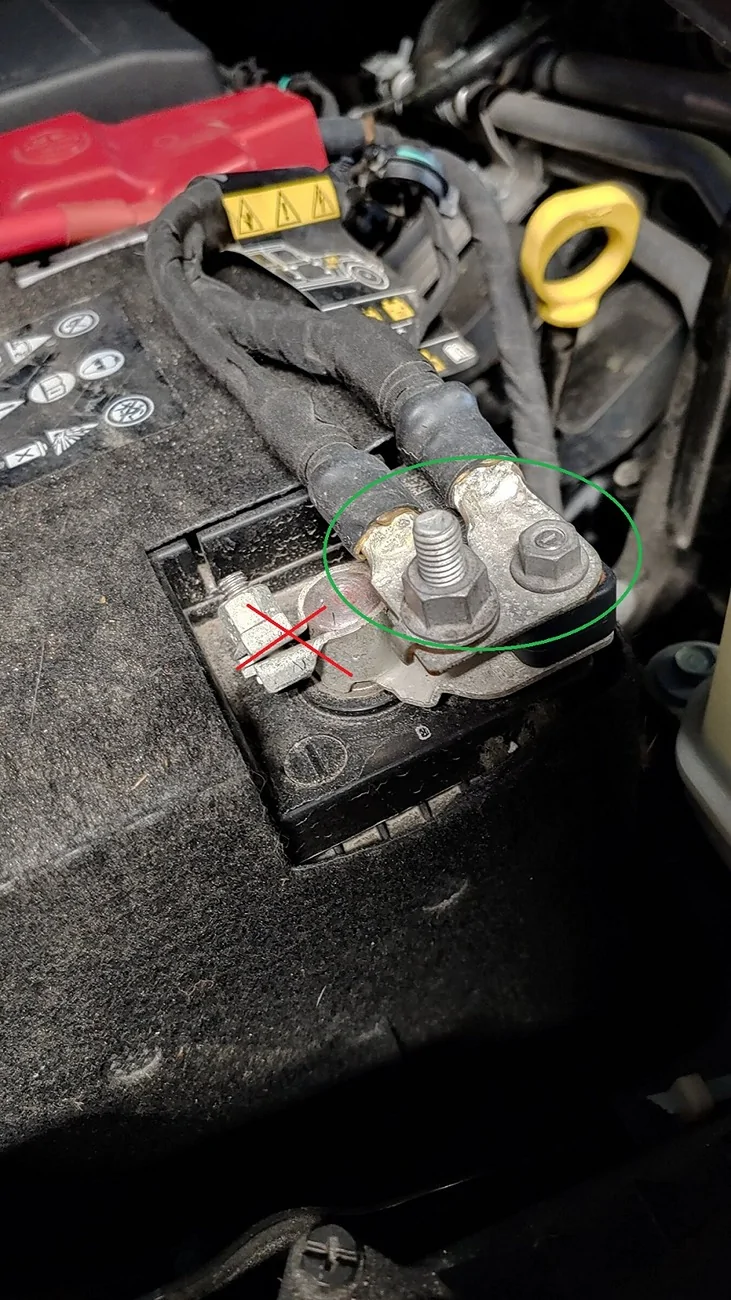

This is the IBS -
Jeep Gladiator Main vs Aux battery replacement question on 2021 JT 20220329_093938
Only ever charge a battery that's in the vehicle with the charger connected inside the green circle, never where the red X is.
Jeep Gladiator Main vs Aux battery replacement question on 2021 JT JT-neg-bat-post-connect

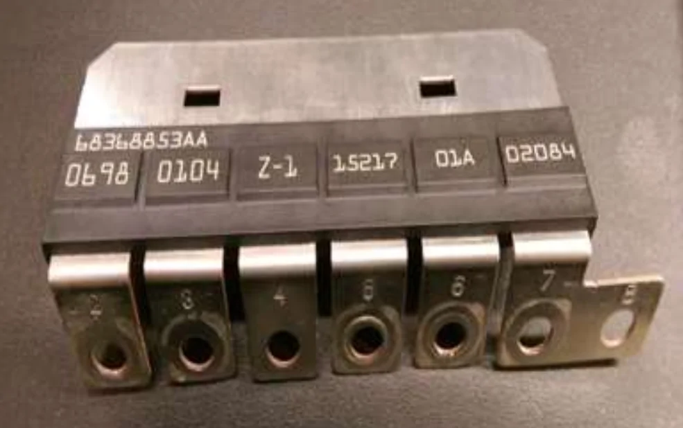

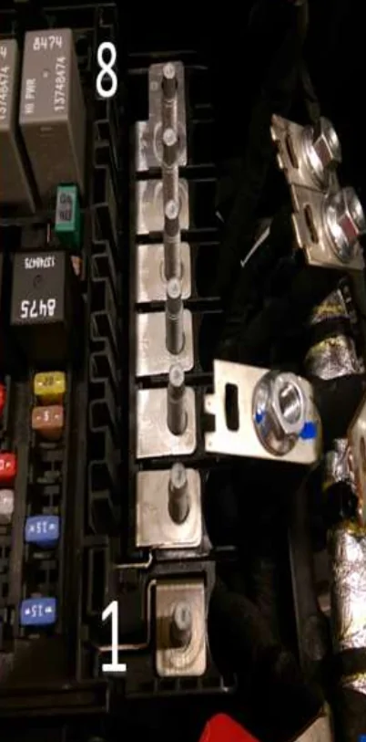

This is the high current fuse - you very possibly blew out N3 on this -
Jeep Gladiator Main vs Aux battery replacement question on 2021 JT fuse-array-3
Jeep Gladiator Main vs Aux battery replacement question on 2021 JT fuse-array-4
