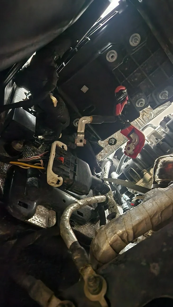

I drove the Gladiator for a couple of hours yesterday doing some errands and had no starting issues. The temperature dropped to low 20s last night and this morning I attempted to remote start the truck and it didn't start. I got in and tried to start it by pressing the button, but all hell broke loose. It turned into a Xmas tree with all lights and all kinds of clicking noises. The only way to reset everything was to disconnect the ground terminal from the main battery and the N1 terminal on the fuse box. Luckily, I had my NOCO jump pack at the ready. It started right up after reconnecting the terminals. Obviously the two battery design is not optimal on these trucks. On our old WK2 Grand Cherokee without ESS the original battery lasted 8 years. The Gladiator's barely made to 4.

Just wanted to update
I am not the most mechanical
And over all did not think it was that bad
A little bit of a pain, but not that bad.
Went for the wheel well method
I did the same when I did mine last year. I took the tire off and peeled the liner back so I didn’t have to deal with the plastic rivets.
My mistake was not replacing my main battery at the same time. Even thought it tested fine. It died about a week later and almost left me stranded. I made it home and the next morning it wouldn’t start and kept trying till I disconnected the batteries. I couldn’t stop it otherwise. The day before I got a power steering warning and it stalled on me. Thankfully it restarted and was fine till the next morning. It’s been a year and the power steering warning was a low voltage issue.

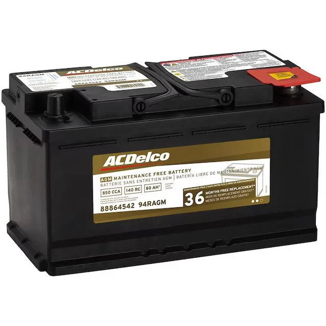

Today I replaced both OEM Main and Aux batteries with ACDelco Pro Golds. The OEM battery had no vents, the ACDelco has two, one on each end of the battery. Of course the positive terminal shipping cover comes with one plug, but does it matter which end I plug, the positive or negative ? Would it be good practice to also run an elbow and vent hose or is it venting into the engine satisfactory ? I've seen it both ways, I just wonder which is best.
From what I see, not all of those batteries are AGM, so make sure you put AGM in it. AGM isn't open-vented. They will build some pressure before venting. That's what made me look to see if "all" of those are AGM and the results came back "many are".
NEVER plug battery vents. and if those have open, obvious vents, it does make me wonder.
AGM batteries will vent, but it takes more pressure- in fact, "over-pressure" and it's rare for them to vent because it's pressure regulated.
If I was you - I'd triple check to see that the batteries YOU bought are indeed AGM.
AGM doesn't need any special vent because they so very rarely ever vent or release any gases at all. They are considered "sealed" batteries.

Well, the decals on the battery say it's AGM, ACDelco web site says it's AGM, the label says ,"non-spillable", that's all I can go by....
But I did notice the two vent holes. They may be safety valves for all I know... I'm not going to try and press fit the vent plug that came on the positive terminal cover into one of the holes... see vent holes in ACDelco web site pic..
