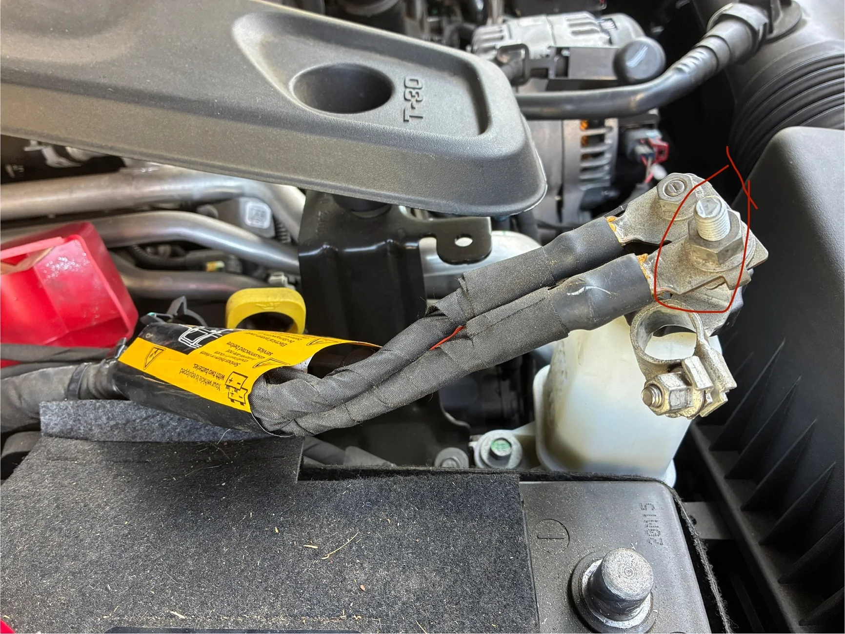

Thanks. I do have a Black & Decker charger that I've used to charge up the battery from time to time. How do you charge up the aux battery directly though?
Wondering if I should charge it up again and see if that helps anything at all.

You will need to separate the two cables at the main negative. One goes to the fender ground the other goes to the aux negative post. Your positive charging cable can just stay on the main positive post. Your aux positive is connected there via the PCR. Connect your negative charging cable to one of those cables that you disconnected and isolated. If you charger shows that it is charging, you chose the correct cable. When it is finished, simply move the negative charging cable to the main negative post. When it is finished, you can wait 20-30 minutes and test the voltage with a meter. If 12.6 or higher you can reconnect your cables to your main negative, starting with the aux negative cable. Leave the fender ground for last.

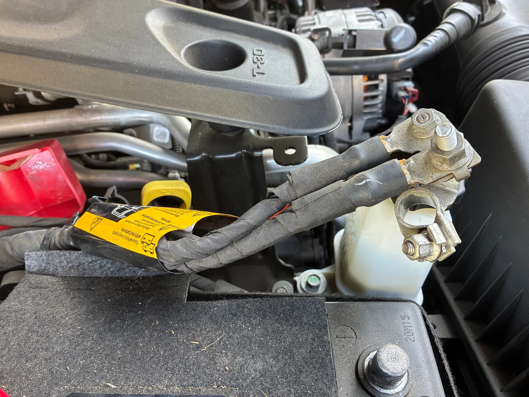

When verifying the voltage at the negative cable I got readings for both cables. Do I have to completely detach the thinner one to verify the aux voltage? The nuts do not budge at all.
Jeep Gladiator Main vs Aux battery replacement question on 2021 JT IMG_0146

Main battery load tested at about 11.3-11.4V which i believe is decent. That was tested after I had charged it up fully (resting voltage was 12.9).
If I understand correctly I can charge the aux by connecting to the terminal on top of the negative post circled here? How do I load test just to verify the aux battery health without removing it?
