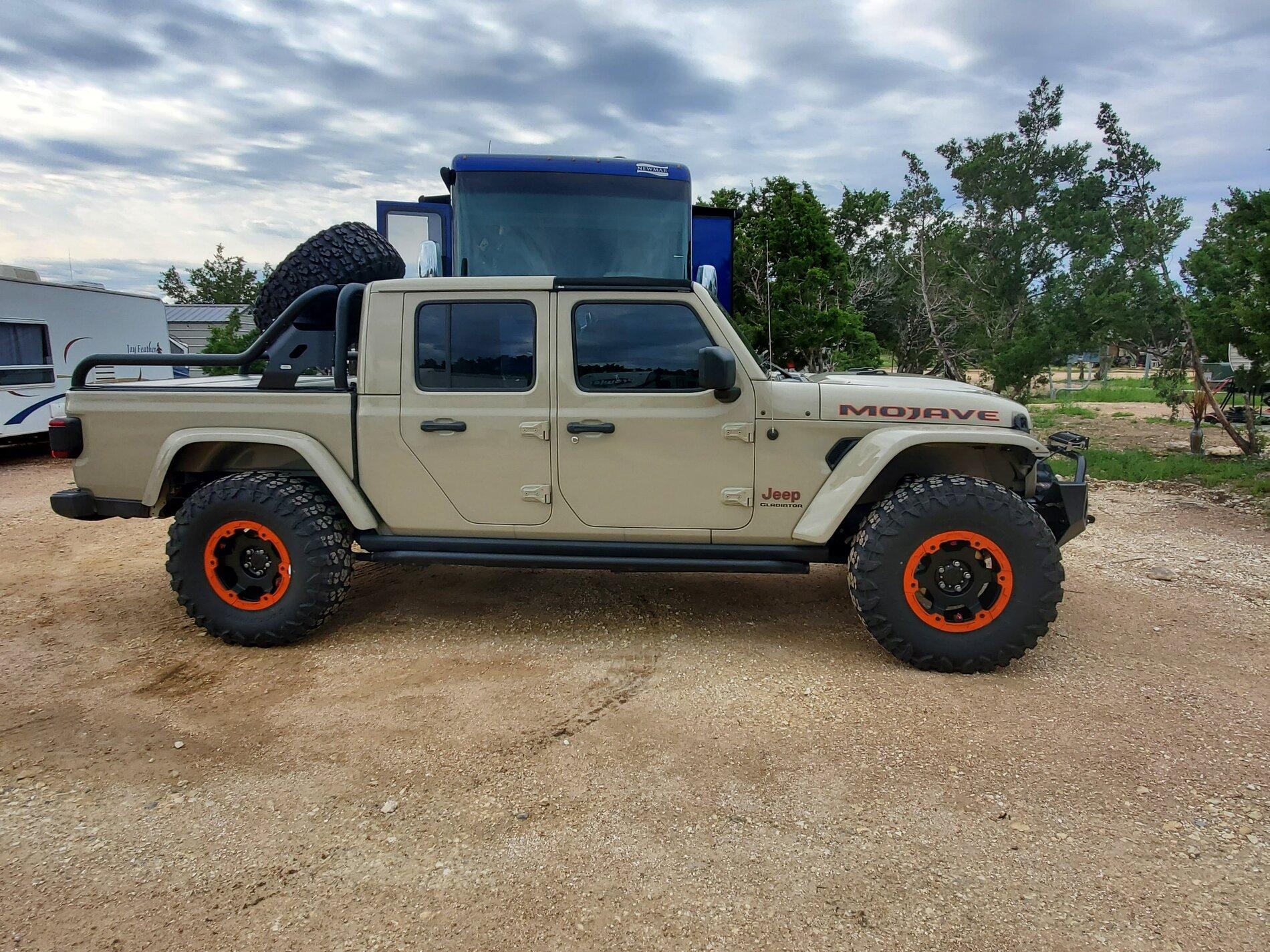

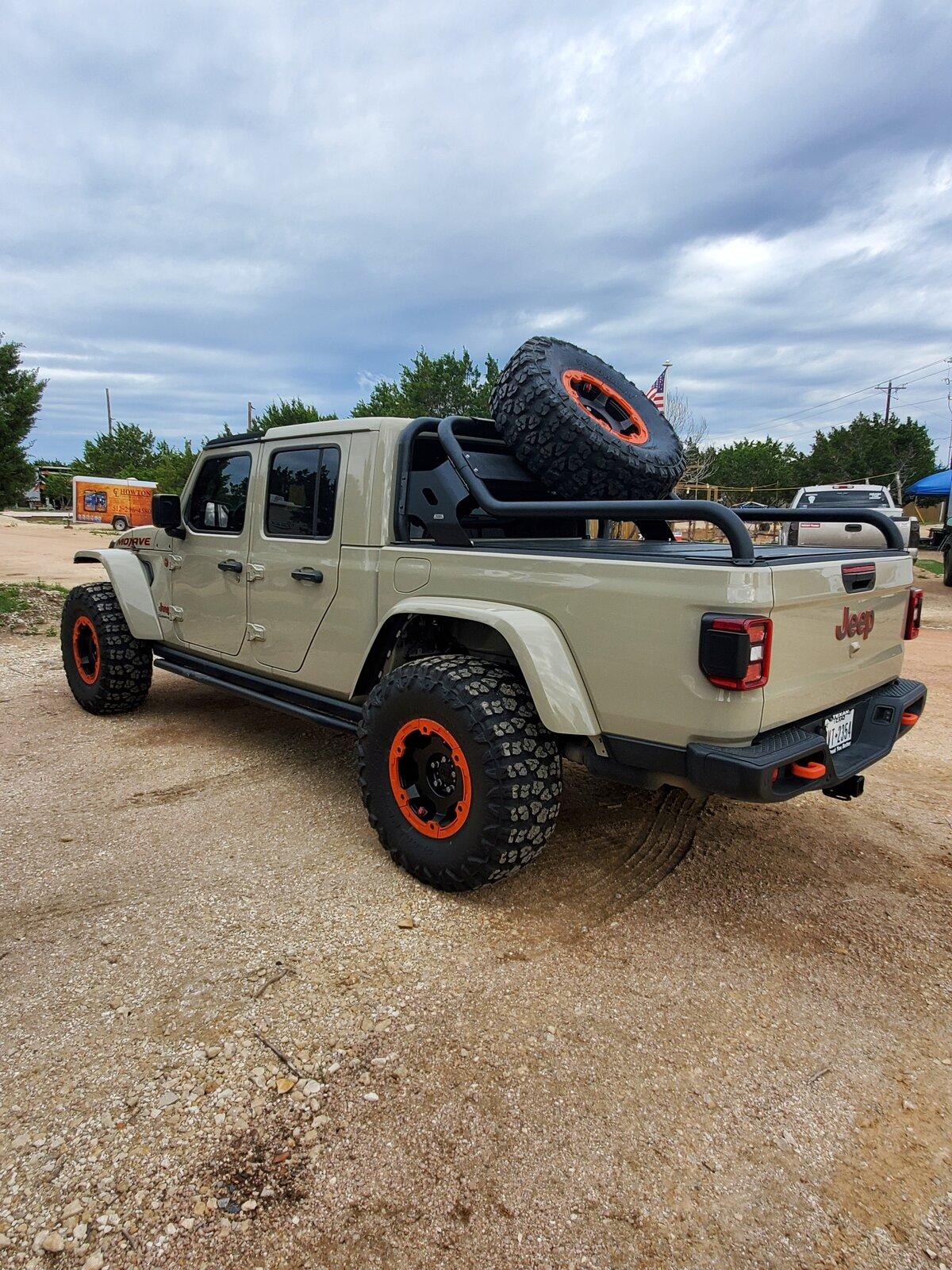

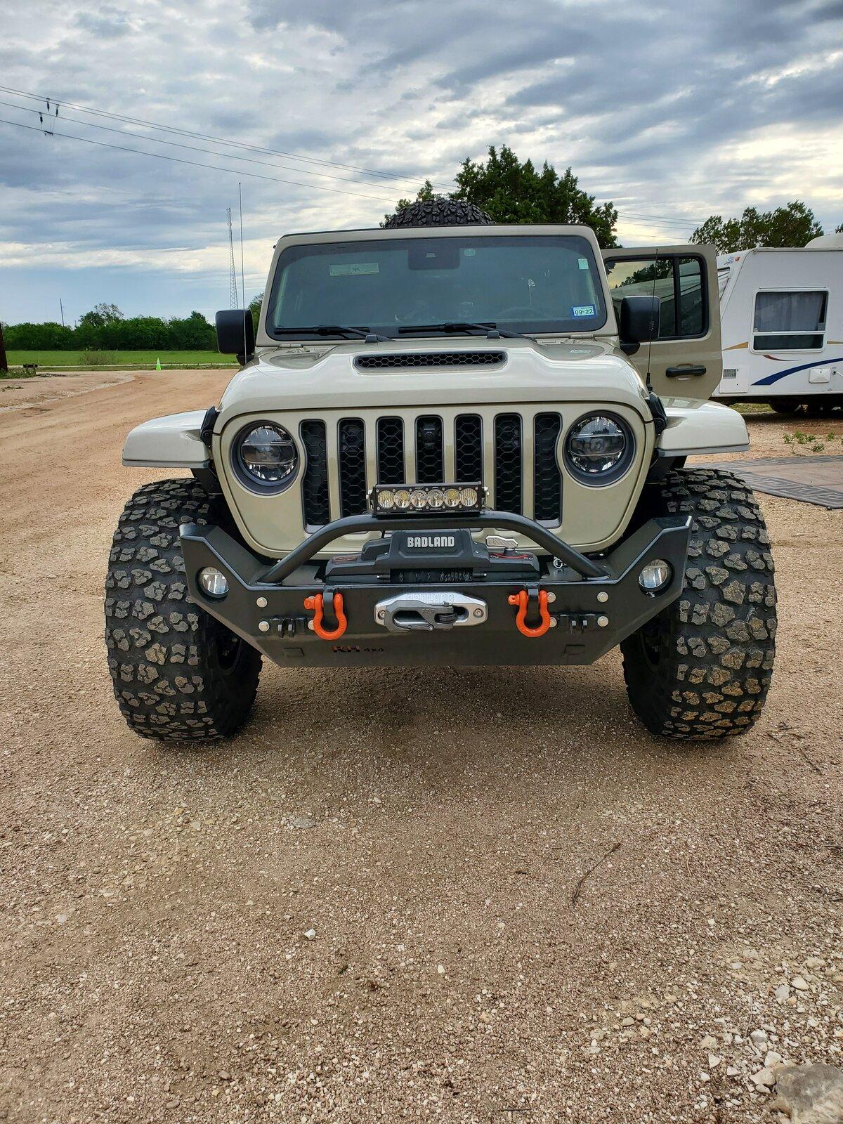

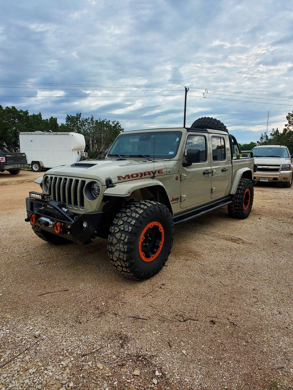

Love my Mojave and have finally finished a lot of the build.

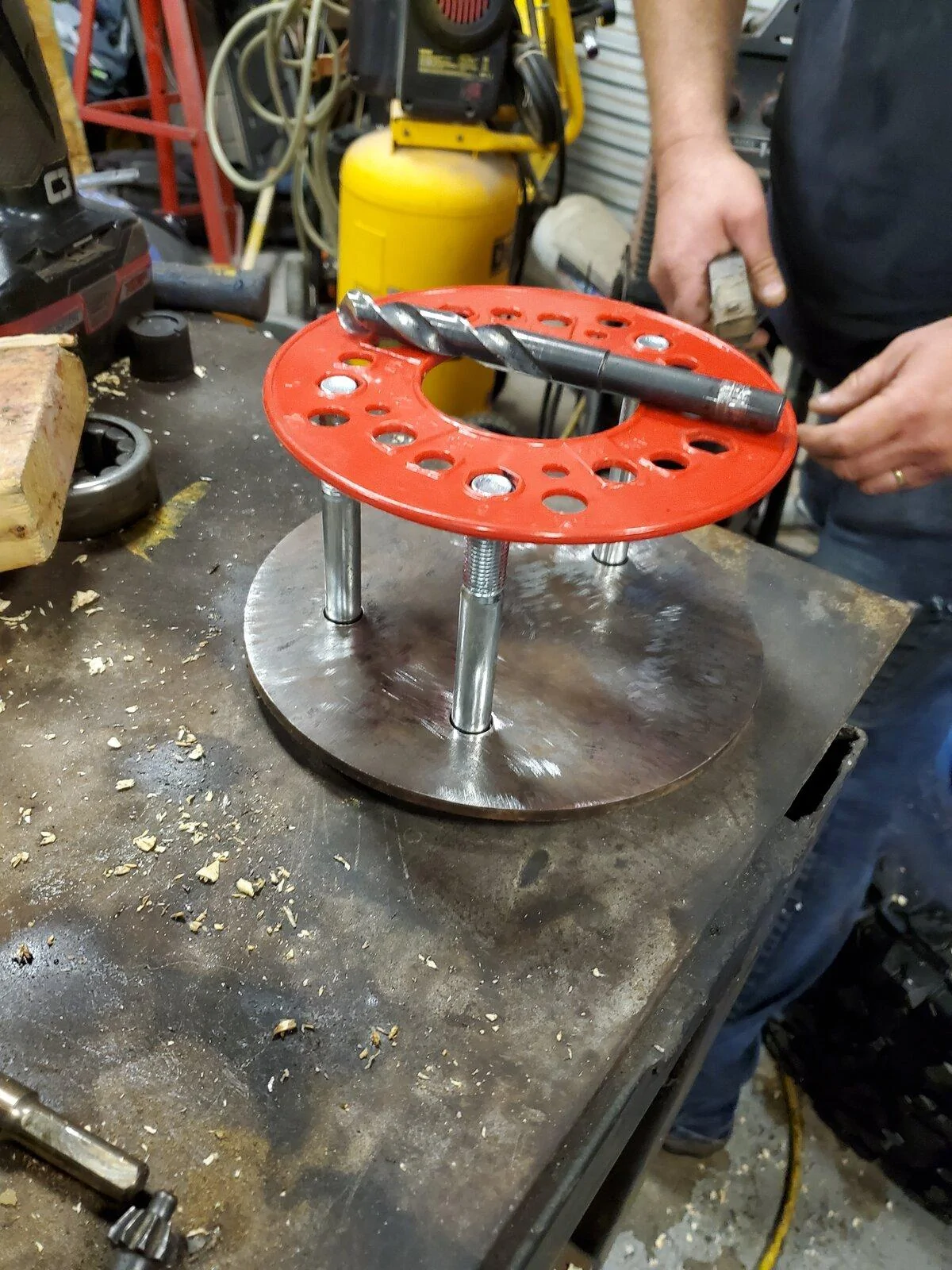

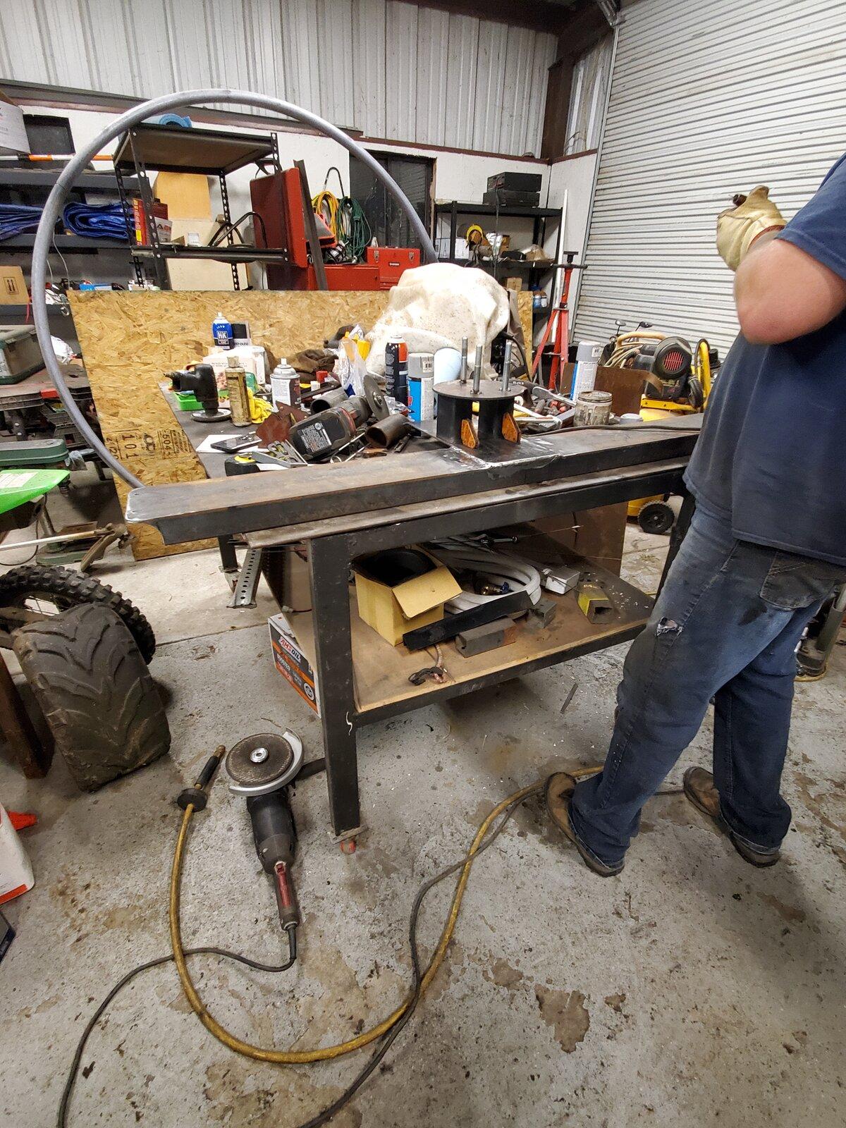

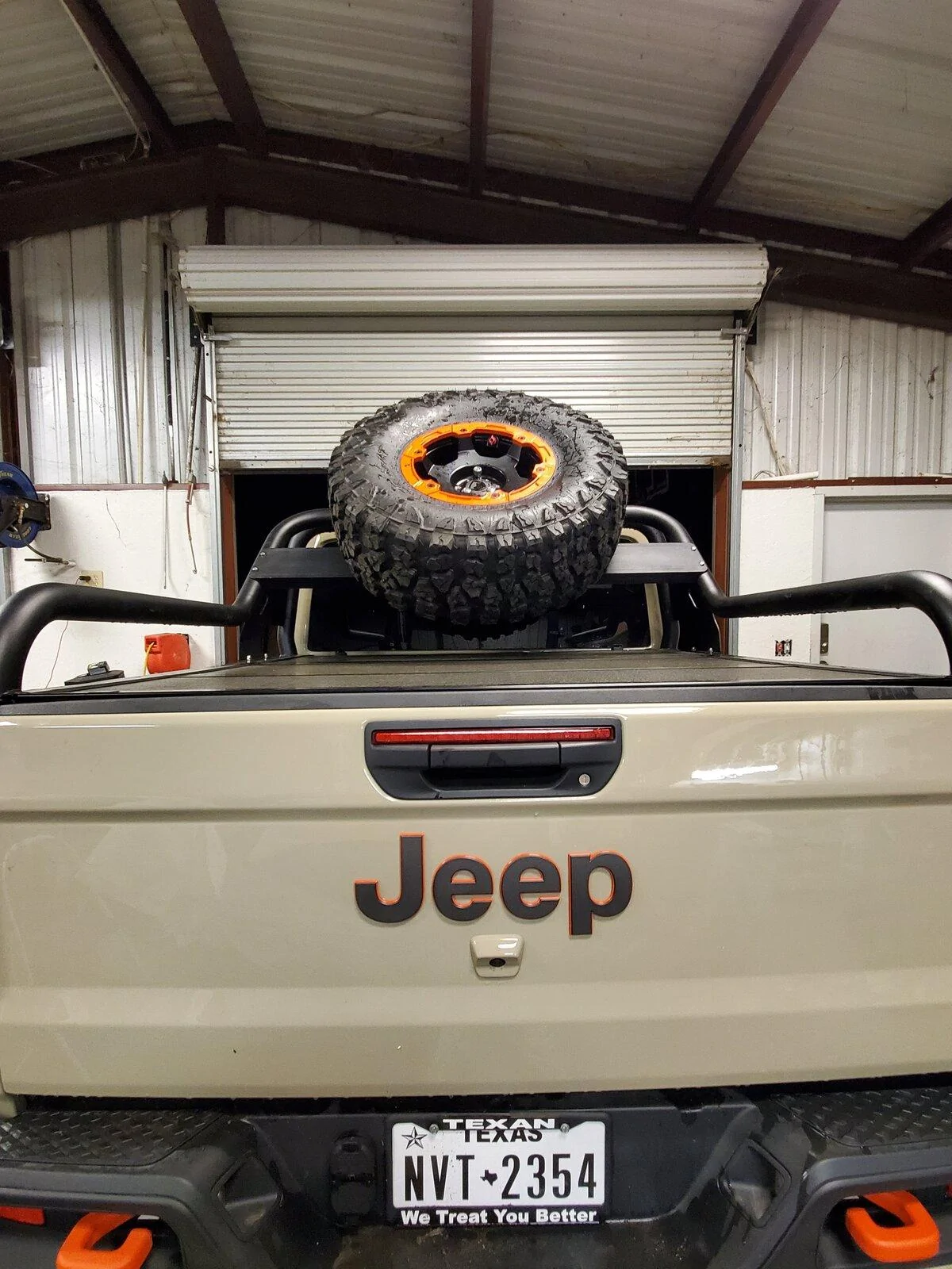

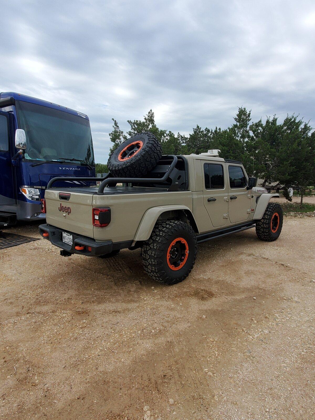

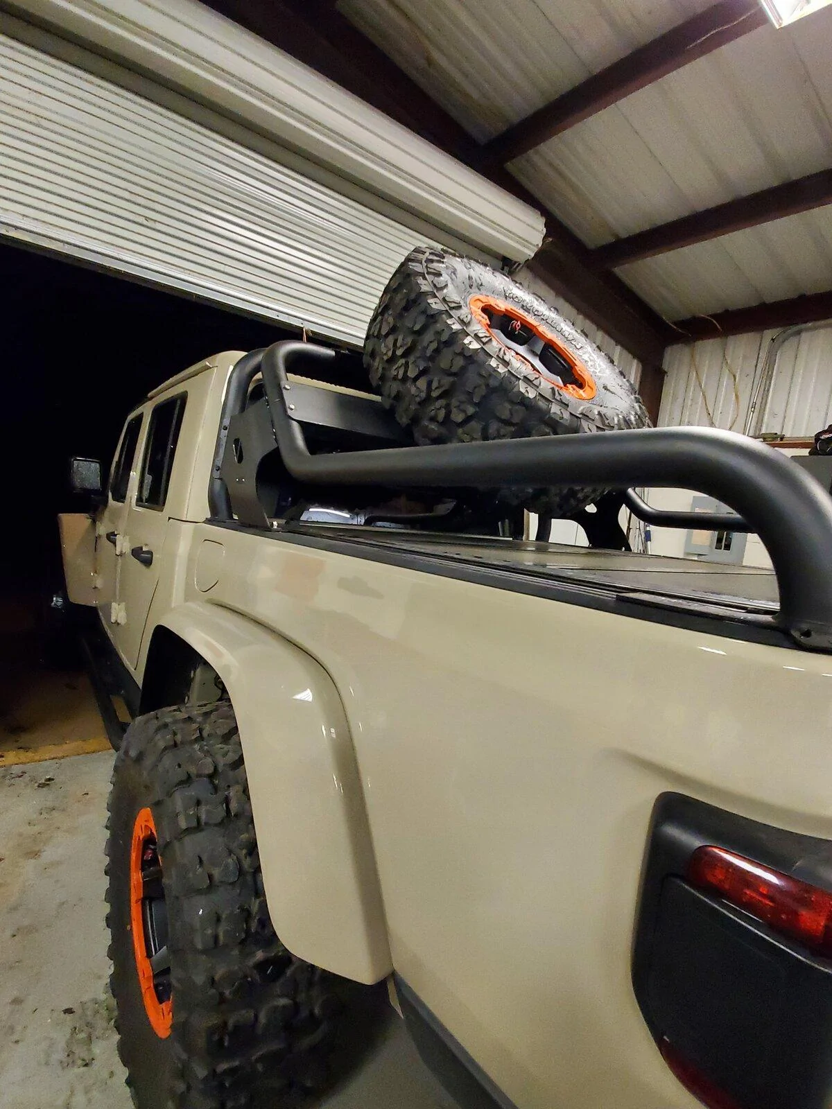

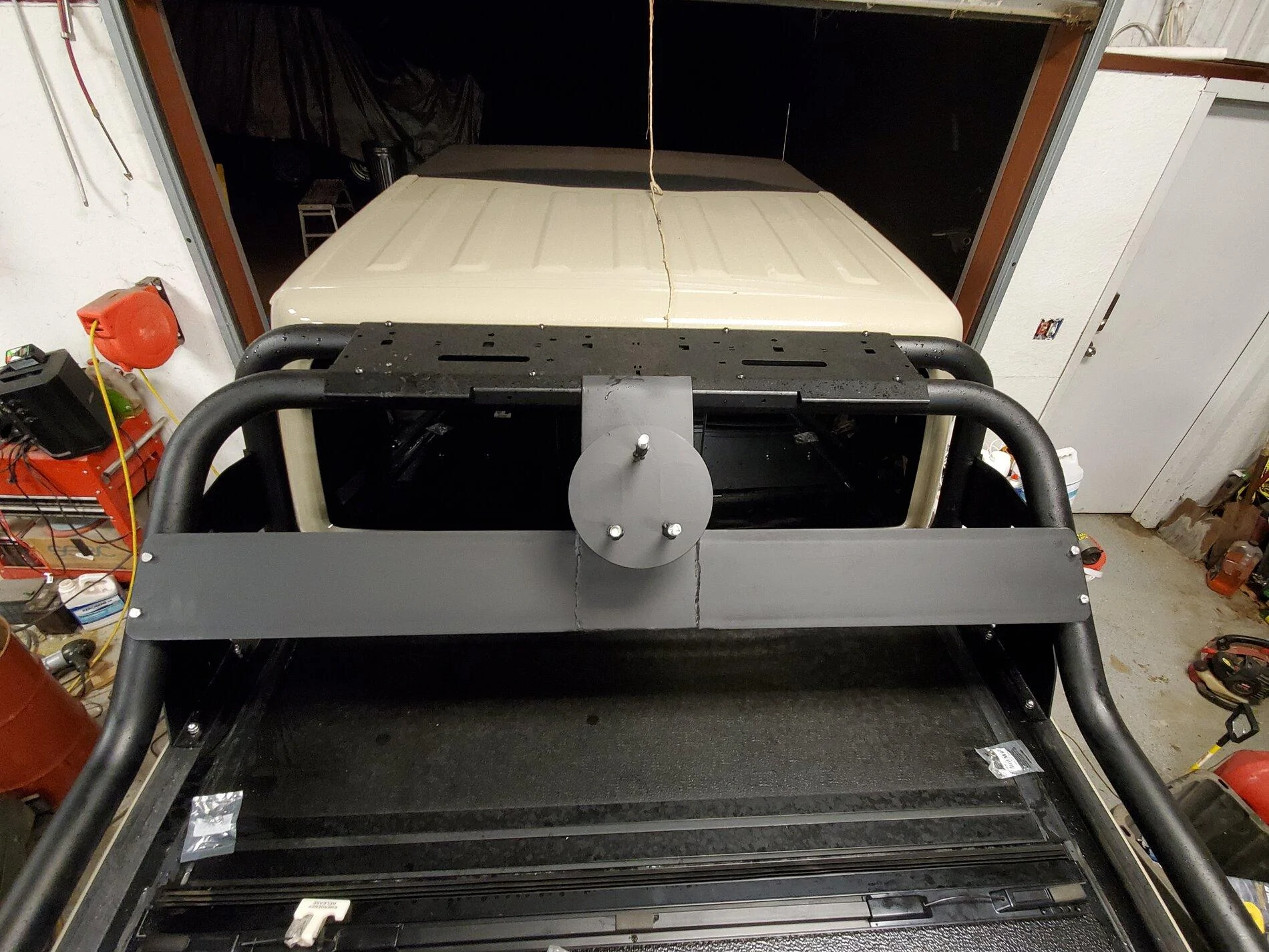

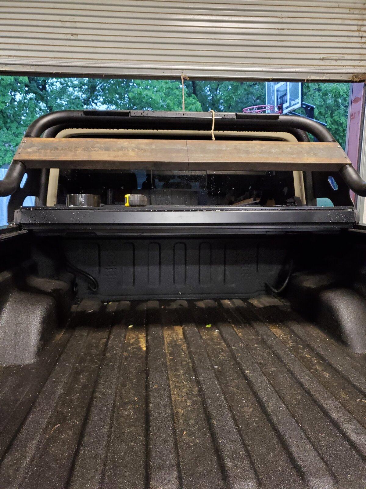

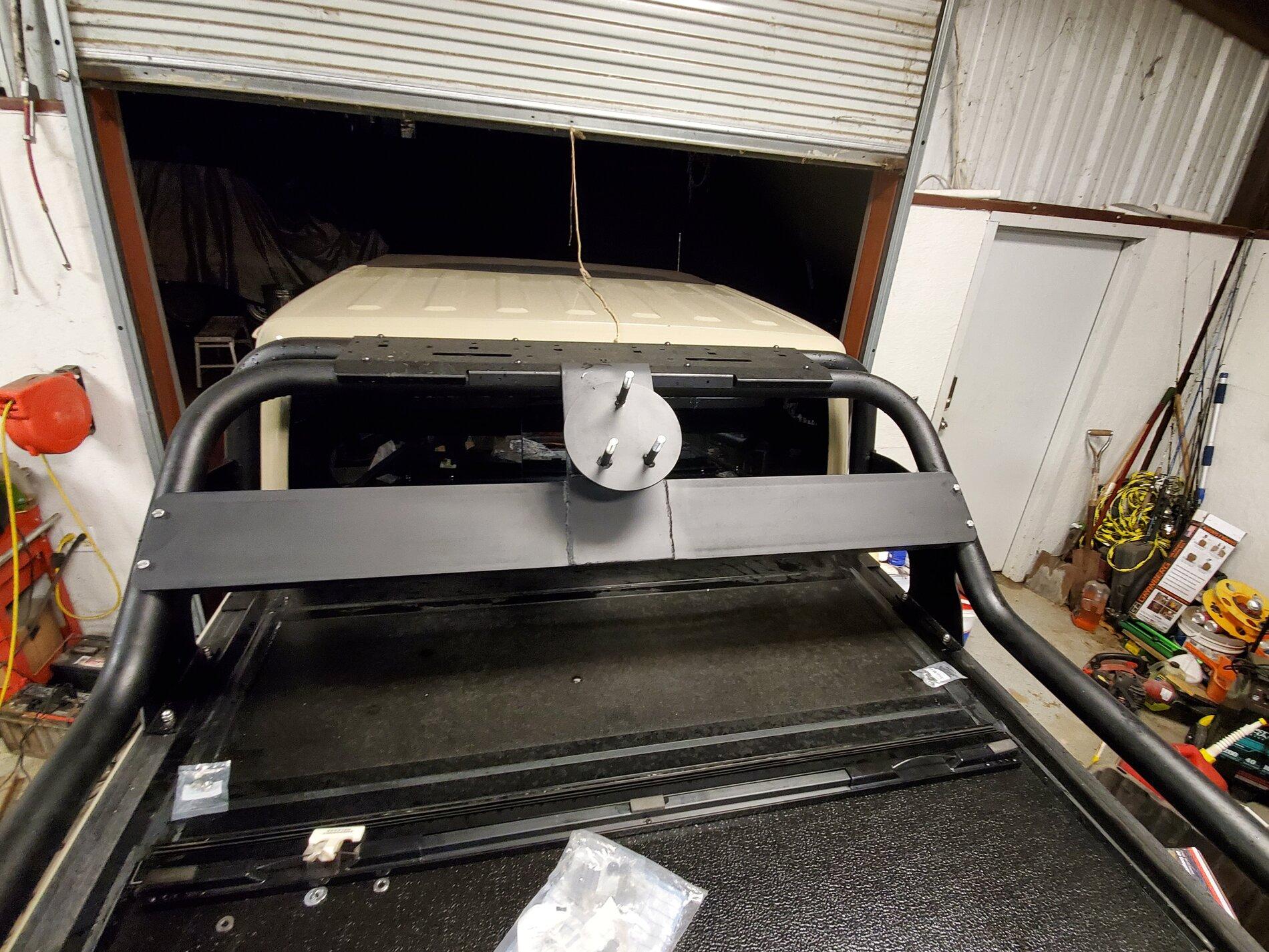

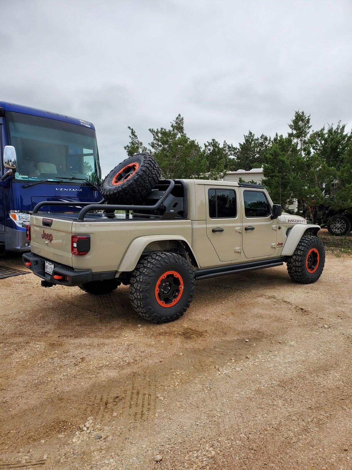

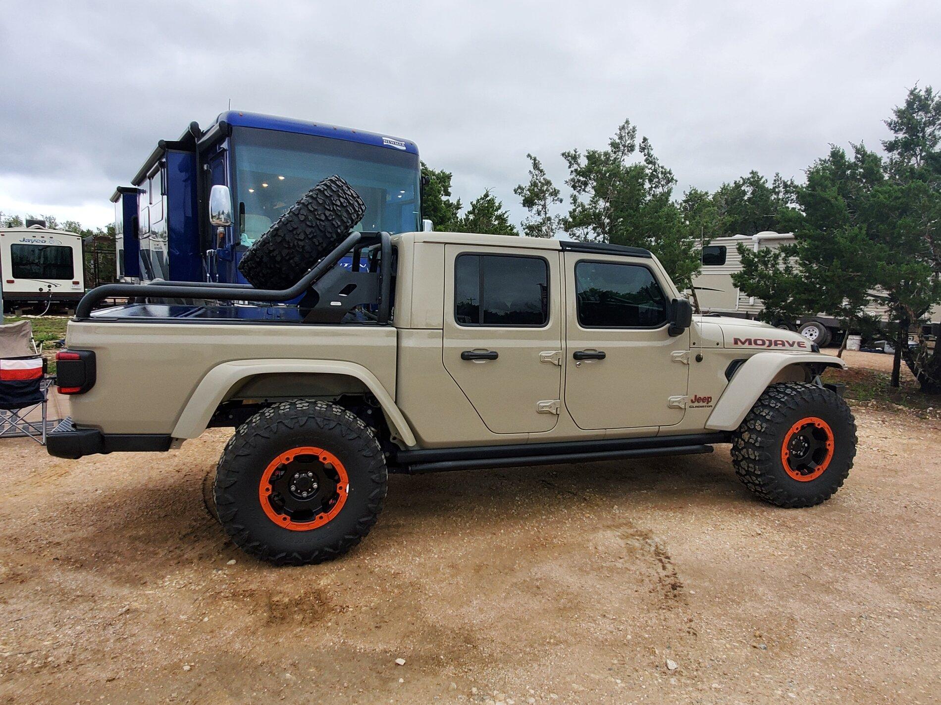

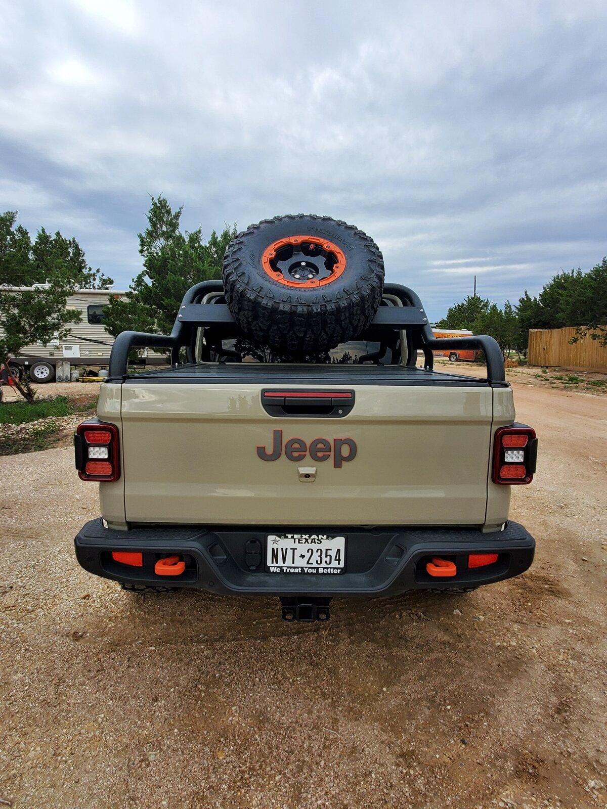

My buddy Ronnie and I have had a blast building my Mojave so far. The difference from the first few trips before the build and the trip last weekend after the build was incredible. The chopped fenders with the massive and very aggressive Yokohama XMT 37"x13.5" tires and the added confidence of a beast of a skid system made all the difference in the world. I was determined to find a way to BAJA mount my spare tire and so my buddy Jason helped me fabricate an awesome spare tire mount integrating it with the Maximus-3 Sport Rack. I probably over did the mount using 8lb per foot 6" channel iron which equates to approx. 1/4". I told him we may get lots of request for them...lol. I was told you couldn't use the Maximus-3 Sport Rack and keep my Mopar bed cover but I was able to do some cutting and modifications and made it work. It is not water proof but it wasn't before either.
I have had lots of compliments from various folks but want to hear what Fellow Gladiators think about it...let me know!!
2020 Gobi Mojave
YOKOHAMA XMT 37X13.5
TERAFLEX NOMAD WHEELS FEATURING AUTO DEFLATE VALVES
TERAFLEX WHEEL RASH RINGS PAINTED ALLIS CHALMERS ORANGE
FENDER CHOP UTILIZING AMERICAN DESIGN LABS BRACKETS AND LIGHTS
ROCK HARD 4X4 FRONT BUMPER WITH BLUE OX TOW BRACKETS

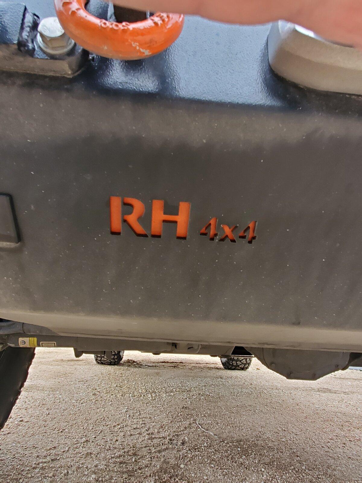

ROCK HARD 4X4 STEEL SKID SYSTEM
ACE ROCK SLIDERS
BADLANDS 12,000LB SYNTHETIC WINCH
ARTEC FRONT INNER FENDERS
BESTOP SUNRIDER
TAZER
MAXIMUS-3 SPORT RACK
CUSTOM MADE SPARE TIRE CARRIER
MODIFIED MOPAR BED COVER TO WORK WITH SPORT RACK
FRONT AND REAR DVR

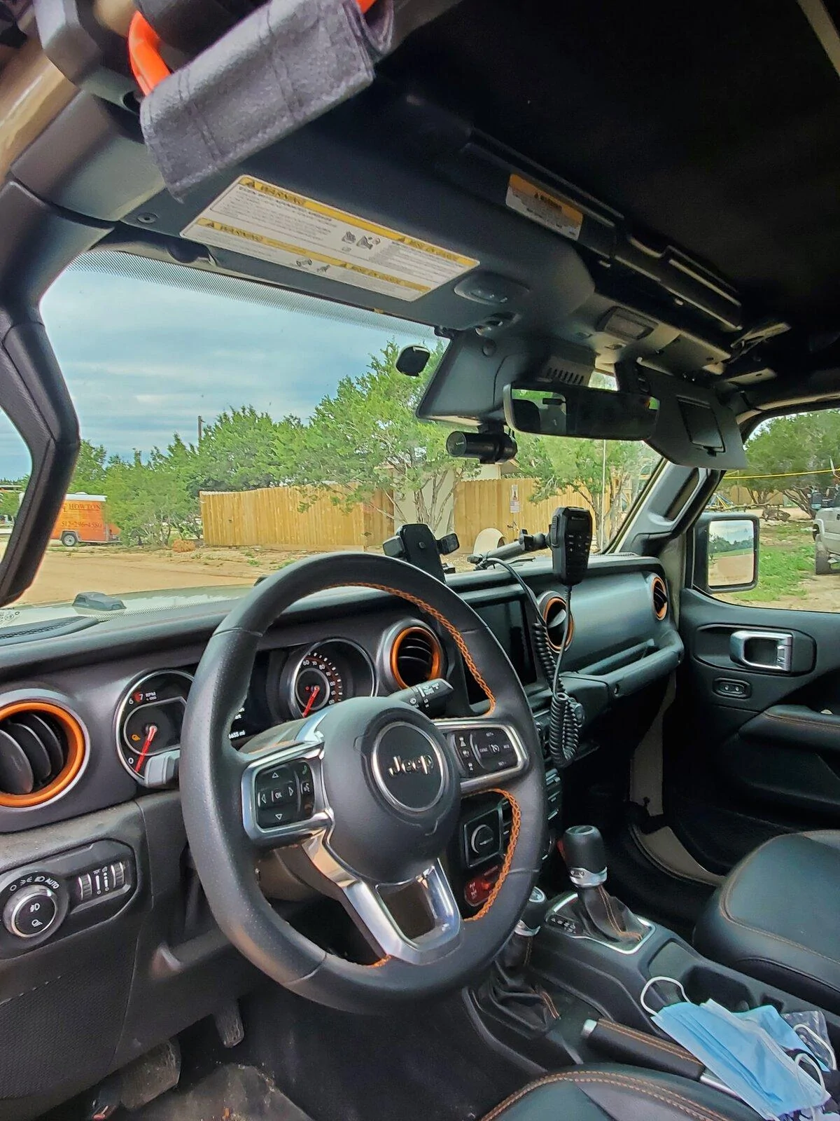

DASH MOUNTING SYSTEM WITH POWERED PHONE CHARGER, 2-WAY MIC HOLDER AND GO PRO MOUNT
GPCA GRAB HANDLES ORANGE EDITION
DCS ROCK LIGHTS
BAJA DESIGNS LIGHT BAR
ORACLE REPLACEMENT REAR TAIL LIGHTS PRE-ORDERED
OTHER THINGS I HAVE FORGOTTEN

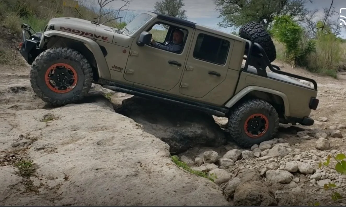

It's definitely improved since our winter snow trip. The back to back runs at hidden falls show what an improvement 37s are for the mojave.
The fact that you didn't have to change suspension is very impressive. You had no rubbing on the runs I thought you would have.

Looks awesome!! Your tonneau will flip all the way forward?
Mark Miosi
Mark Miosi
Mark
Jan 29, 2021
Cleburne Tx
2020 Mojave Gobi launch color
Developer
Thanks. No it won't flip forward after the first flip. I think of it more as a trunk that locks for now. Going to keep my eye open for a retractable one that I might be able to go with. I was willing to sacrifice that for now. For large load hauling I have a 3/4 ton Chevy. This is my toy.

Did you re-gear after adding the 37's? If not how does it ride with 37's and stock gearing?
Mark Miosi
Mark Miosi
Mark
Jan 29, 2021
Cleburne Tx
Developer
I have not re-geared but plan to soon. If I don't look at the tach or the gear indicator it is fine ...lol... I don't see 7th and 8th as much and spend more time up around 3000 RPM which of course reduces my gas mileage. If I had bought it this way I would not think anything of it but I drove it stock for 6 months before the build so I notice these things. It's not quite as zippy as it was. If money were a barrier I would be fine keeping it as is but the $1600 to re-gear isn't a problem so I will go ahead.
Gladiator_Explr
Derek
Apr 16, 2021
Kentucky
2020 Gladiator Rubicon; 2017 JKU Rubicon
Man of Mystery
I am running 37’s on a 3.5” lift and I re-geared to 5.13’s and it’s is great. On the highway I rarely fall out of 8th gear and cruise around 2400 rpm at 77 mph. Really great on the trail as well.

Your Baja Designs light bar bolt right up to the Rock Hard tabs or did you have to do a modification?
