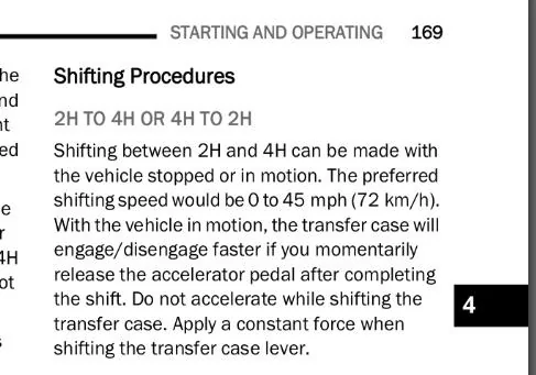

Here ya go. You’re not crazy! Page 169 of the JT owners manual.
That's not a maximum speed for using it though, that's a maximum speed for shifting. "The preferred shifting speed...". If there were a max, it would say so, like it does for 4Lo, where it says "do not exceed 25 mph".
