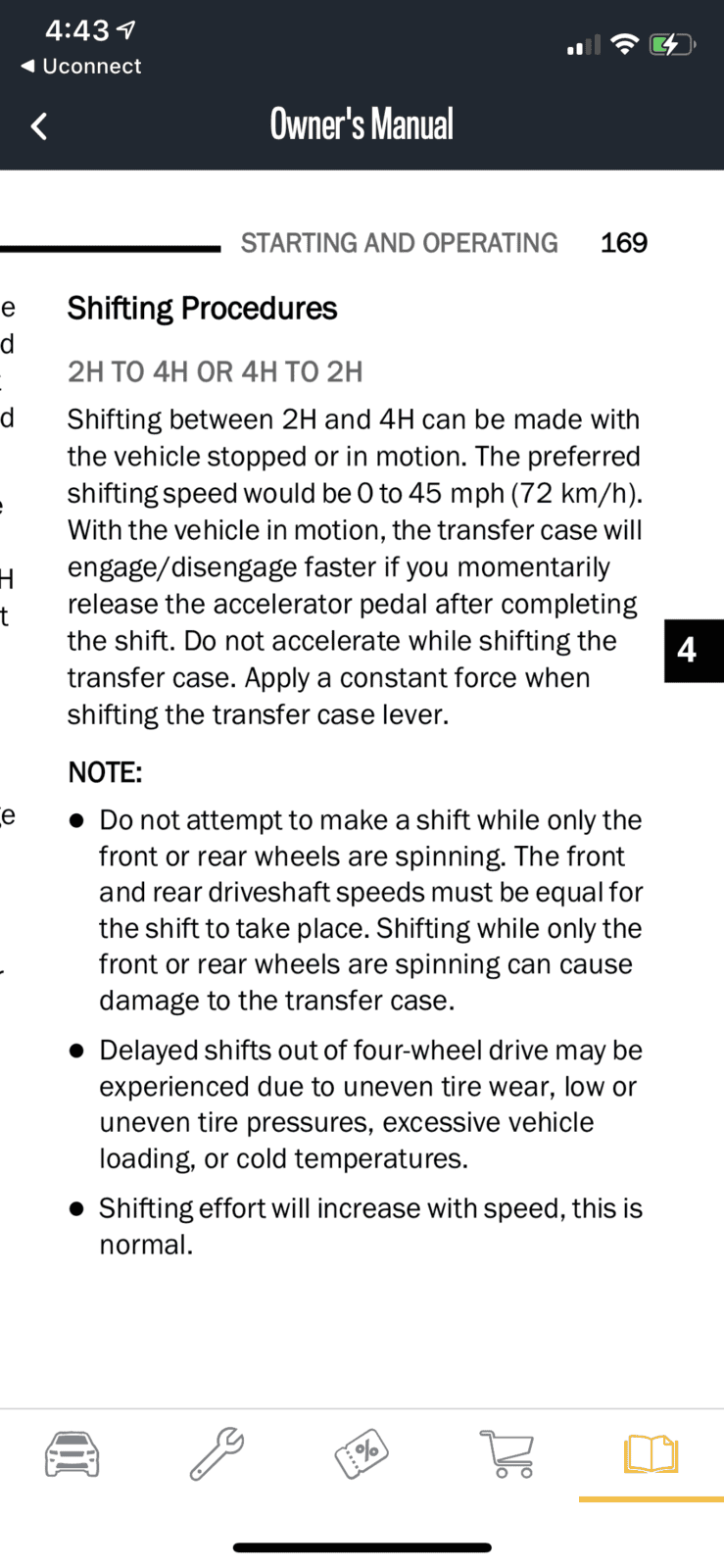

From the manual, preferred shifting 2wd to 4H is 45.
There is no max speed for 4-h. Just use your brain and drive fir the conditions.
