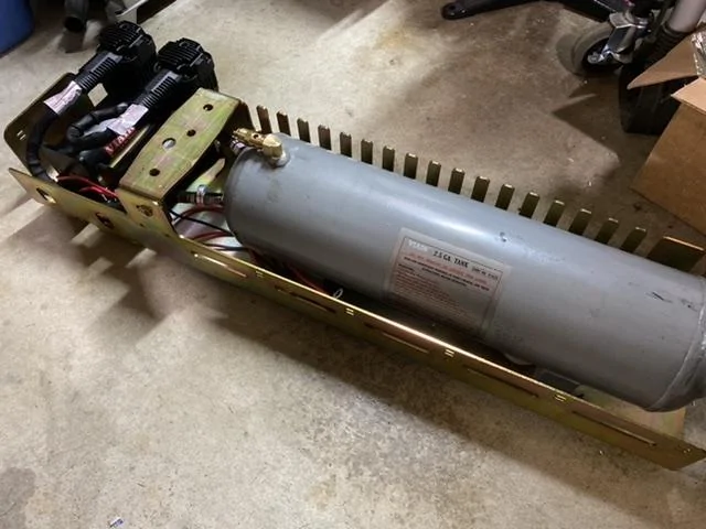

I'm in the process of installing their cradle with a pair of 400C's.

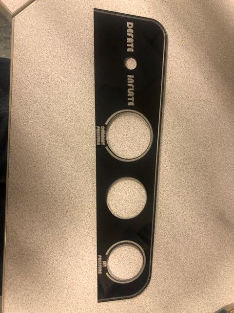

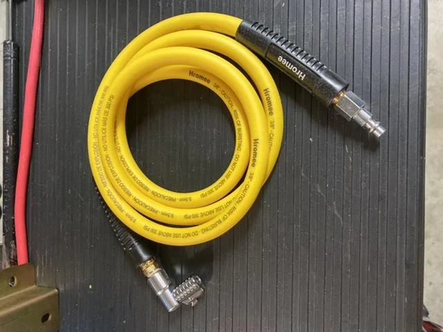

I also looked at the UpDown Air system but can't justify the cost for what's included in the kit. My buddy has a fiber laser and we'll knock out a panel for the pressure regulator, gauges and switch for a fraction of what they want for their system. I put together the whips and quick disco's for each corner for about $60.

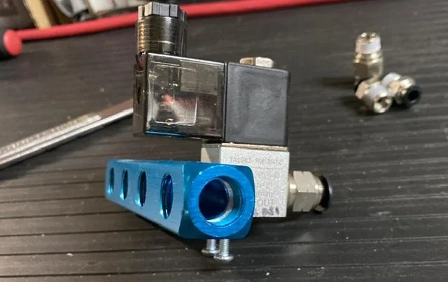

I might be going a bit overboard with the setup though as I’m installing a distribution block with a main shut off solenoid. It’s all cheap stuff off of Amazon though.

This is the Gen 2 if I’m not mistaken. Their first design had the compressors on either side of the tank.
There will be a Youtube video of this once up and operational along with a parts list. Here’s a shot of the acrylic overlay we’re messing with. SUPER rough design right now though.

Curious about the durability and strength the tank sitting next to a muffler. The VIAIR website says the air tank temp. rating is "+ 176 degrees". Not sure if + just means that's as high as they tested it but he muffler with get a heck of a lot hotter than that. I read on other posts that the metals are not made for continued high heat exposures over and over again.
Any thoughts on this? Anyone with some valuable input that would quell my nerves and convince me that it's ok to go forward with this type of installation?

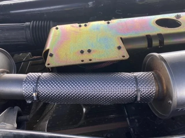

There is a heat shield that comes with the kit to wrap part of the exhaust.

Good to know. That heat shield wraps over the exhaust... or is it on the side of the cradle to deflect heat from the exhaust? If it actually goes on the exhaust I suppose I could also buy some to put on the side of the cradle.
On your gen 2 cradle, does it look like there’s enough room to mount the 2 ARB compressor, as opposed to two of the VIAIR compressors?
A review of the instructions indicates that the heat shield will wrap around the exhaust pipe between the muffler and the cat.
My VIAIR pumps are about 10" long, they will fit side by side in the cradle, and they utilize the majority of the room. I have the VIAIR model 20020 with Dual 444C compressors. I am not familiar with the ARB compressor(s) you have, there is about 12" of room between the 2.5 gallon tank and the end of the bracket.

Here’s a photo of the heat shield:
not sure why it keeps loading up side down...
