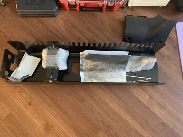

A review of the instructions indicates that the heat shield will wrap around the exhaust pipe between the muffler and the cat.

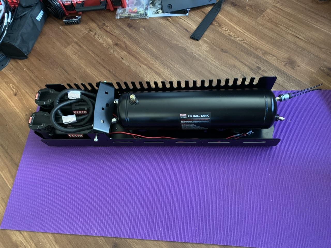

My VIAIR pumps are about 10" long, they will fit side by side in the cradle, and they utilize the majority of the room. I have the VIAIR model 20020 with Dual 444C compressors. I am not familiar with the ARB compressor(s) you have, there is about 12" of room between the 2.5 gallon tank and the end of the bracket.
Looks like the Twin ARB compressor should fit then as ARB says the dimensions are 4 x 7.5 x 10.8.
Thanks for the pic @Koloradokid. So am I to assume the muffler itself doesn’t get hot, and it’s just the tail pipe that does? I think I’d prefer to get some more of that stuff and place it along the side of cradle.
The muffler will also heat up however the cradle turns up and acts as somewhat of a shield as well even though the only thing that’s going to protect is the air tank. The supplied heat shield is plenty to protect the area in which the pumps, air lines and wiring come close to the exhaust.
Air tank is what I’m worried about. I’ve read some stuff on here that relates to the the heat it’s still going to get.

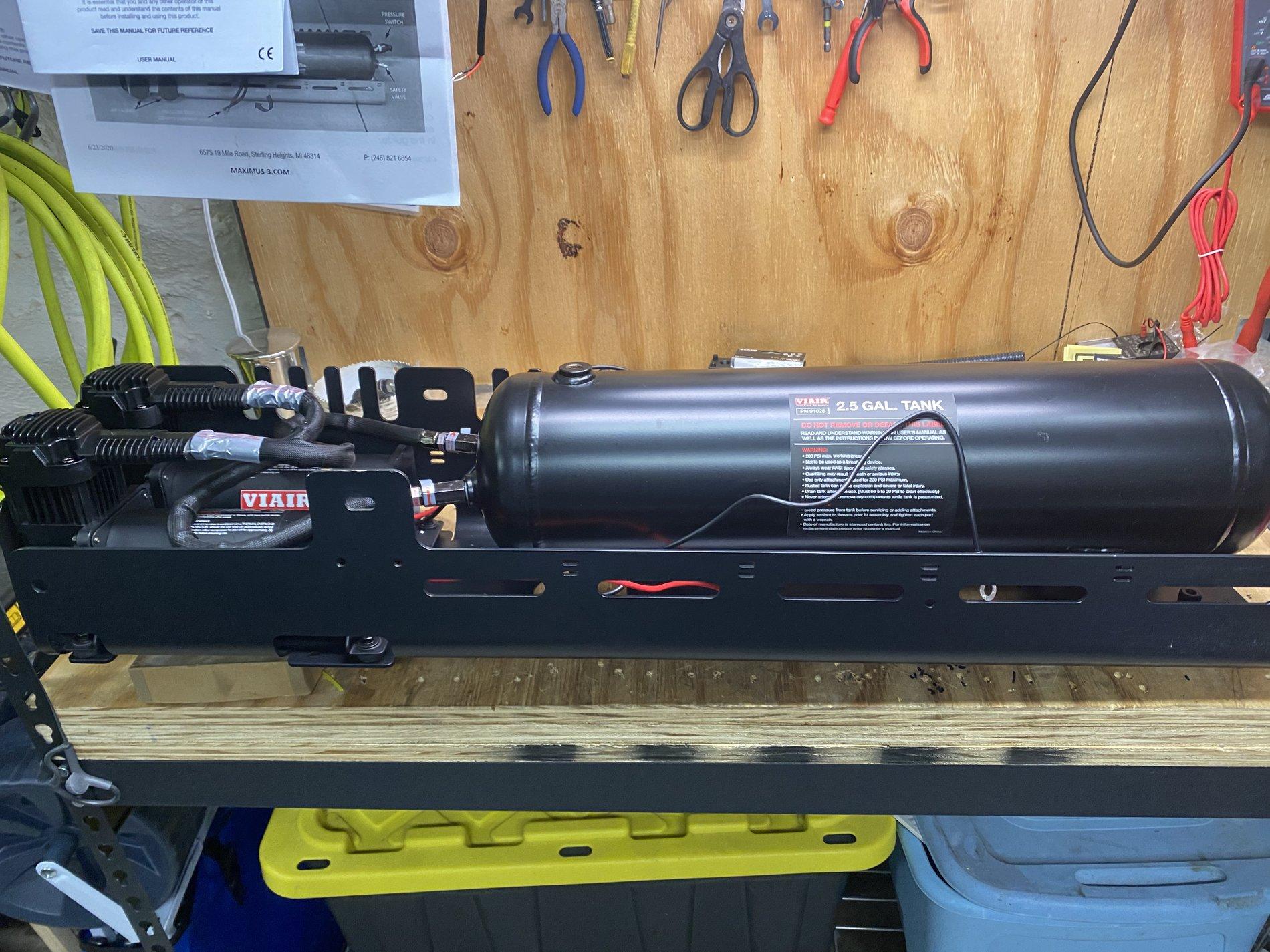

Mounted the system last night. The 485c pumps mount nicely in the new alignment.

Just waiting for some time off to install. Also ordered some fiberglass exhaust wrap. Wife threw out the stuff that came with the kit.
