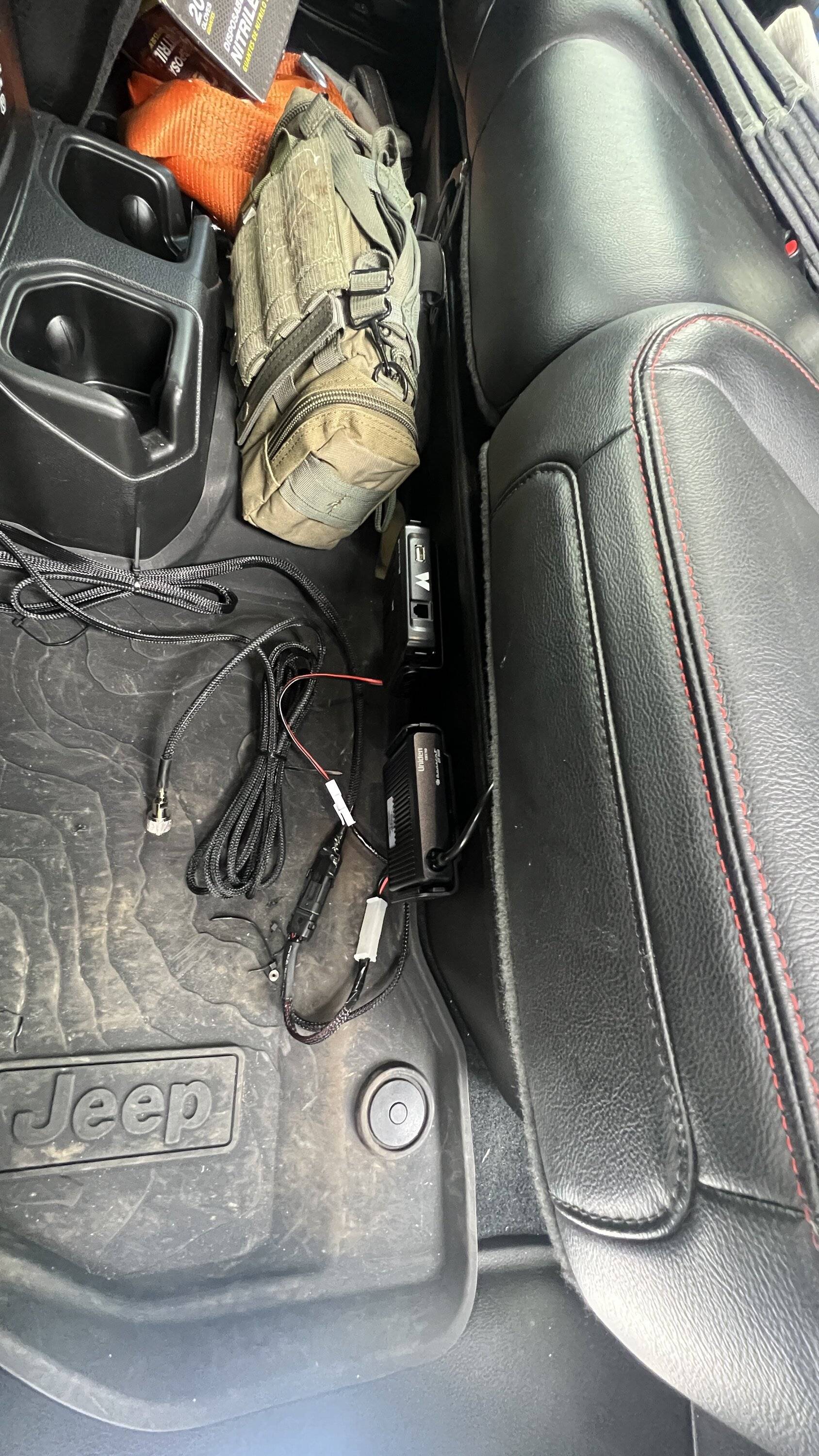

Knowing Jeeps have relatively poor options for good mounting locations I expected relatively poor or borderline swr based on not ideal ground plane options. But seeing as how mine is almost perfect and I havent had to make any adjustments I am open to taking advantage of more powerful radios if it will benefit. my mounting location isnt super affected by the size difference. This is a very temporary location until i bulld my own seat delete unit.
