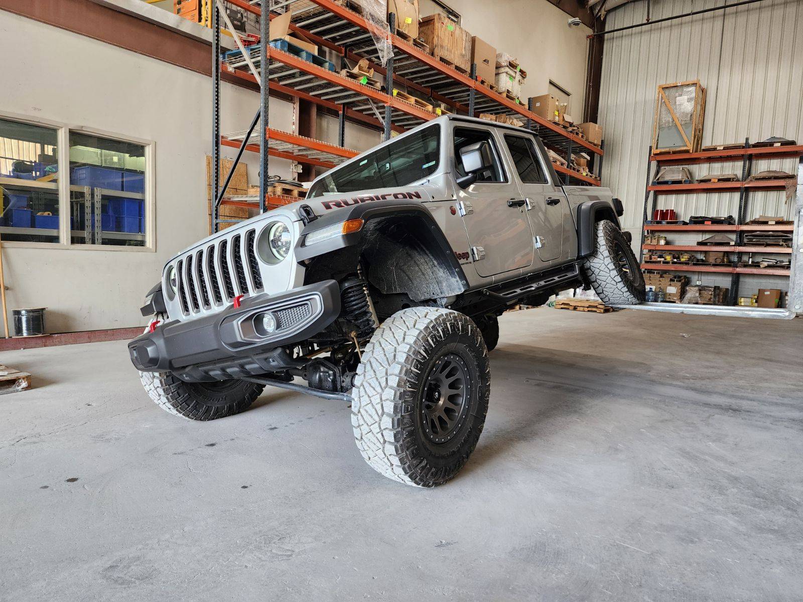

Regrets: FAD delete on a daily driver.
I went with the RCV shafts and now getting 12-13 mpg (with 4:88's & 37's) on the highway. I now have a slight driveline vibration (running an Adam's front driveshaft) at 40-50 mph and anything over 70. If I had done my homework, I would have either went with a smaller lift (currently on a 3.5" MetalCloak, or left the FAD.

Why would you have gone with the smaller lift? I’m thinking about doing the 3.5 Metalcloak.
Billyj7175
Joel
Jan 27, 2024
128
320
Sooner State
2023 Jeep Gladiator Rubicon, 1983 Jeep J10
Oilpatch USA
First off, I got a lot more than 3.5" of lift out of it. The RidgeGrappler's in the 37" size, only measure 35-3/4", the stock tires measured 32.5", so I gained 1-5/8" of lift just from the tires. Add 3.5" to that comes out to 5-1/4" overall lift. However, by measuring from the driver's door sill, I"m almost 7" higher than stock. The shop I had the lift put on, swears those are the correct springs. I found a discussion on an online forum (I forget which one), but basically on the JL/JT, anything over 2" of lift can cause a slight vibration in the front end. IIRC, Jeep changed the angle of the transfercase, so they changed the relationship between the caster angle and the pinion angle on the JL/JT. I guess the 392 guys are noticing it the most as they are full time 4wd? Adam's driveline even has that disclaimer.
The flex is amazing, for a short arm kit though. If I really trailed it a lot, it might be worth it, but honestly as a 56 yr old with arthritis in my knees, and living in an area with a lot of high winds (Oklahoma), driving it daily can be a pain (literally). Furthermore, and this is only an aesthetic issue, the wheel wells really swallows the smallish 37's. In my opinion, it would look a lot better on 38's.
