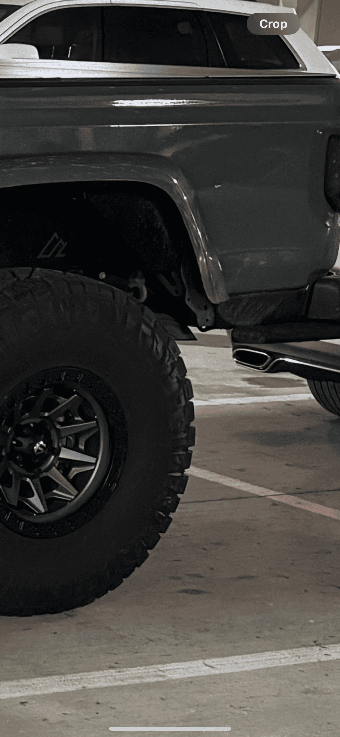

Hey, very nice build. Question for you. The rear fender chop, do you have a pic? I'm curious what the bed right behind the rear flare looks like....on the bottom. Thanks!
Yeah I’m going to find some sort of cover or cut off the extra eventually.
Thank you, I'm a little relieved to be honest. It doesn't look nearly as bad as I was imagining. But I may just get the old grinder out. Thanks again!

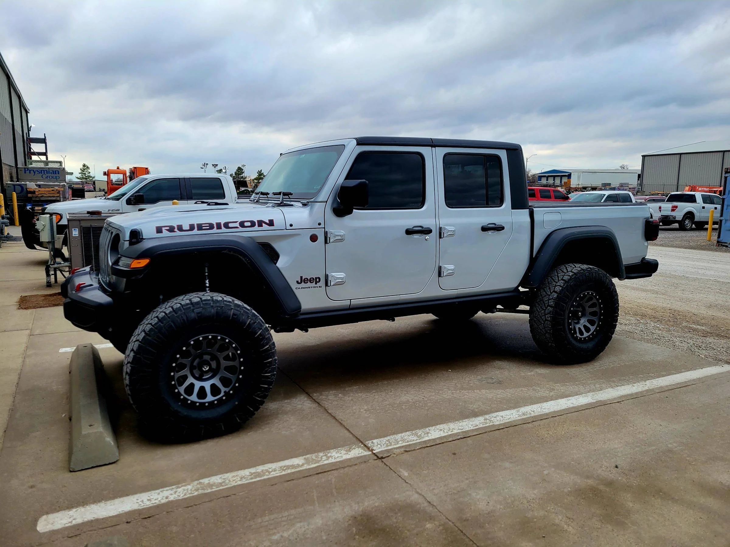

I went with the RCV shafts and now getting 12-13 mpg (with 4:88's & 37's) on the highway. I now have a slight driveline vibration (running an Adam's front driveshaft) at 40-50 mph and anything over 70. If I had done my homework, I would have either went with a smaller lift (currently on a 3.5" MetalCloak, or left the FAD.
Jeep Gladiator Mods: Regrets and Required 20231220_150958 (002)Sm
