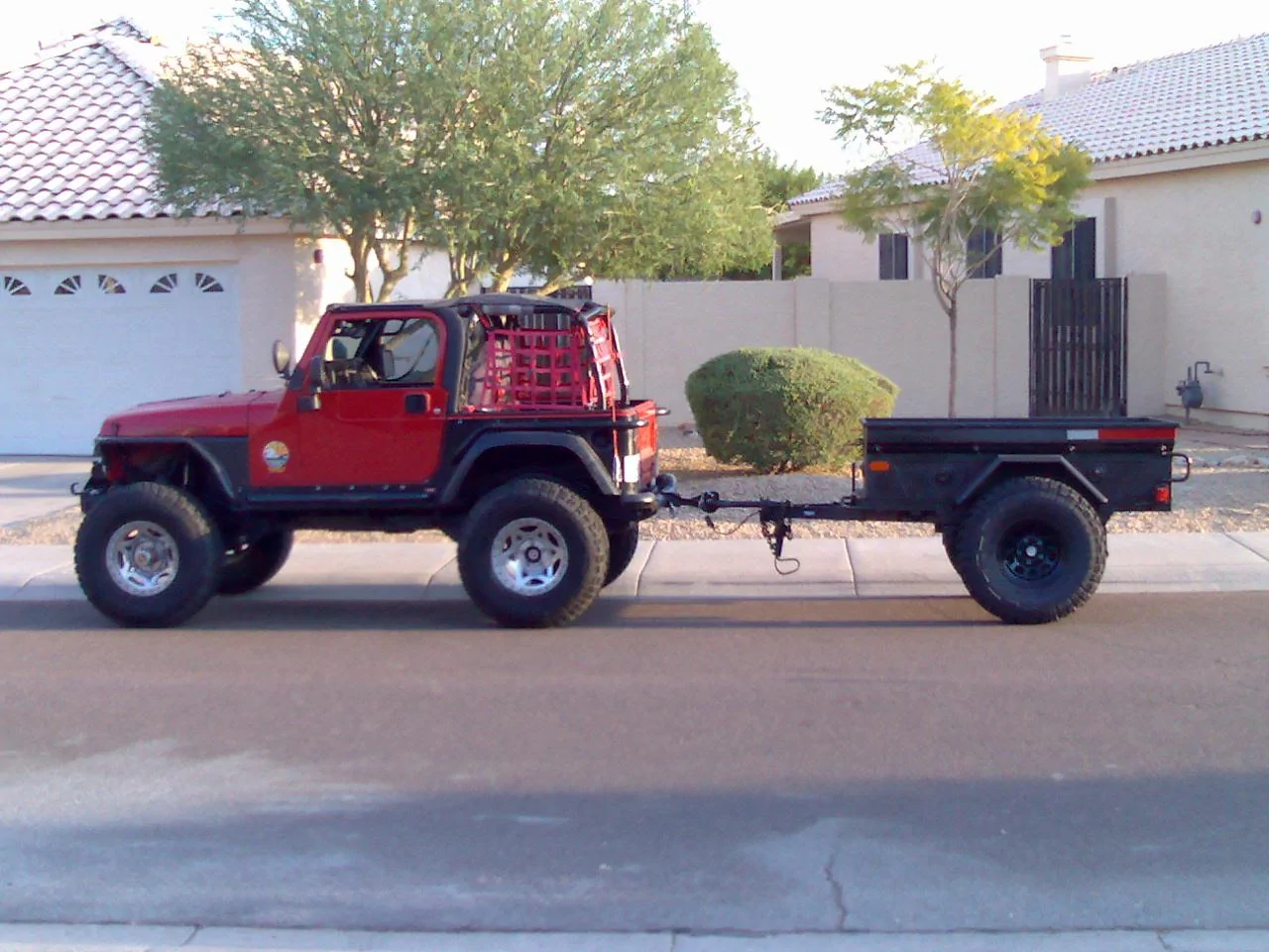

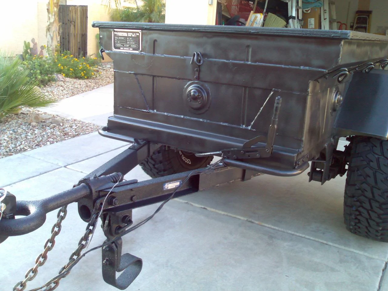

I think in most instances it would be hard pressed to contact the vehicle, the mil-spec lunette is long and also offered in 2 mounting points-levels and it rotates 360. Note the spring on there to absorb shock loads.
Here is the mil-spec unit on my Jeep and hooked to my Jeep as long as you go mil-spec you should have no issues and if you do, then the trailer is on top of your or you are on top of it LOL
This is the Canadien M101 and I converted the hubs from Metric to US I also did the same bolt patter as my Jeep and put 35's on the trailer, shocks were Rancho as were the bump stops both were stocked parts at almost any auto store!!!

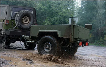

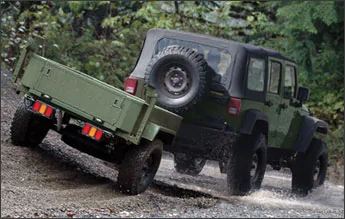

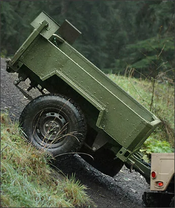

From silver eagle and their L-WATTS trailer system that appears to be highly compatible with the J8 and thus its progeny
Jeep Gladiator Overlanding Build Questions/Payload Capacity L-WATT-Tactical-Trailer-1
Jeep Gladiator Overlanding Build Questions/Payload Capacity L-WATT-Tactical-Trailer-2
Jeep Gladiator Overlanding Build Questions/Payload Capacity L-WATT-Tactical-Trailer-3
https://silvereaglemfg.com/wp-content/uploads/L-WATTS-sheet.pdf
I can see a situation where you've put a rack structure and gear on the trailer and gear hauling baskets etc on the spare of your JK/JL and you have a potential for clashing. I'm bringing it up so it can be designed away from not towards.
Ole Cowboys setup has a huge amount of length between both bodys and the hitch pivot which is great.
