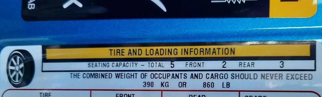

My label says 982 pounds for the cargo capacity
2023 Ecodiesel Rubicon a lot of options.
I have already bought so much gear lolšŸ«£šŸ«£šŸ«£šŸ˜®ā€šŸ’ØšŸ˜®ā€šŸ’Ø. I also did remove some weight with the lifep04 starter dual batteries as the bigger one and a few other weight reduction modifications.
The gross vehicle weight rating is 6450 lbs. So overall with whatever I remove and I add this is the number that you’re not supposed to exceed. I’ll be heading to the scales eventually and seeing where I’m at once I load up things and put together my configuration.

Jeep Gladiator 1086lb Payload capacity, Mojave. What? 1730647938240-o
Mojave is a sand dune jumper, not a heavy haul truck. It's definitely purpose-built.
By the time I put on my power steps, I'd be under 800 (about 790)
You don't go Mojave for the payload capacity...........
Can really say the same for Rubicon - it's "aimed at" a different group of buyers/customers, and is an excellent rock and ravine machine.
