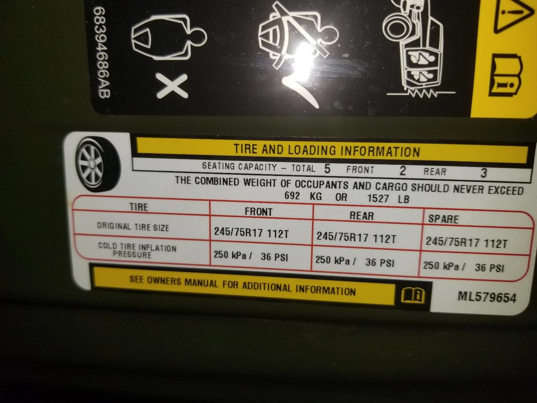

1086lb Payload capacity, Mojave. What?

I checked mine and it’s 1086 too lol.

Mine is a '21 Mojave with select-trac, tow package, leather seats, & freedom top.
Jeep Gladiator 1086lb Payload capacity, Mojave. What? DSCN3787

I seem to recall from one of the gazillion other threads on this subject that buying the trailer tow package on the Mojave raises the rating----which is why I bought it. Do you guys have that option?
Oh yeah. '21 Mojave, auto, selec-trac, 8.4" radio, LEDs, cold weather pkg, front cam, freedom top, bed liner, tow pkg, aux switches = 1071 payload.

This is not a mystery. The difference between the cargo ratings shown here is the difference in weight of the vehicle itself, including equipped options, it all adds up. The MaxTow has a bigger axle, thus it has a larger cargo capacity over a Sport S with tow package, given all other options are the same. Add the axle GVWR and subtract the cargo payload rating and you are left with the weight of The truck, less axle and wheels.

The dual top group will drop your payload rating on the sticker as well, as they calculate in the weight of both. This shows that the payload number may not be accurate for how you’re rolling down the road. I know I don’t usually carry around both tops at the same time.
I think people are worrying far too much about the payload number on the sticker. That number is just based on exactly how your Jeep rolled off the factory floor, plus 150 lbs for driver, subtracted from the GVWR. What that means is the thing that matters is not exceeding that GVWR. So if you’re concerned, load up your Jeep and head to the scale. If you’re under GVWR your payload is good, regardless of how the weights of your actual payload and the listed payload on the sticker compare.

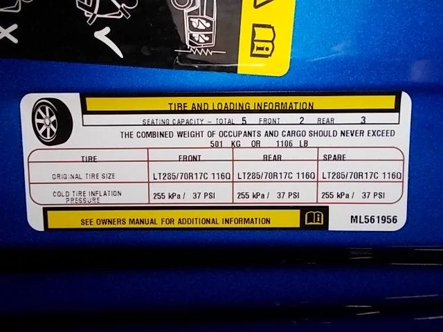

Jeep site says 1700 payload for my JTW. Kinda consistent with that my manual says I can have a trailer tongue weigh of up to 600 lbs.
But my sticker says 961 lbs payload!
Does the weight of the fuel count towards payload?
will filling the bed with helium balloons help?!?
961 lbs? Thats pathetic. Me, wife and two teenage boys will have fun never leaving the house for groceries, let alone plywood or camping....
