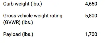

I might buy this "The Engineers know their stuff" argument, if Jeep didn't flat-out lie in their published specs. This is the table (for my vehicle) that I relied on in purchasing. Look a bit closer at the numbers, and it is clear they don't know their a$$ from their elbow... My bad, for trusting "the engineers" to tell the truth.
Jeep Gladiator Payload Questions Screen Shot 2021-06-28 at 6.17.00 AM
