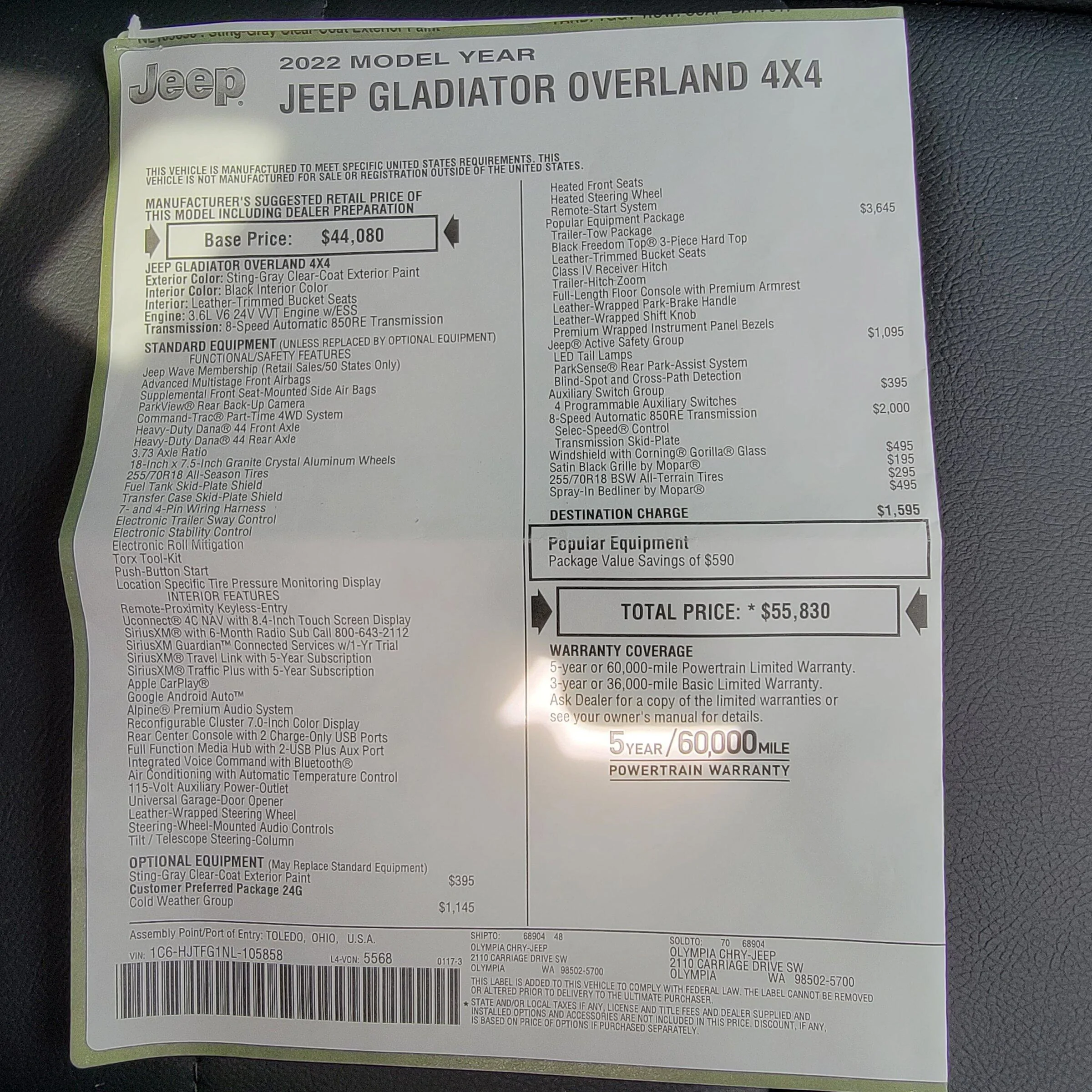

Here is a photo of the window sticker, if that helps explain the difference in payload.
Jeep Gladiator Overland edition payload 20220525_111758

Positively in some cases... since the diesel gets the wider axles, it gets the 6,500lb GVWR too so an overland or Sport with the diesel actually have a higher payload than they normally do. Gimps the Rubicon even harder though.
That's like 140lbs lower than the spec assuming a gas truck... I'm guessing you have a ton of factory options and/or maybe a few dealer installed Mopar add-ons?

Well the one I ordered has the same options you have, the only difference is the color and I ordered the diesel. My dealer assured me it would have 1200+ payload when I ordered so seeing this along with your 900+ payload sticker don’t give me that warm and fuzzy feeling. I sure as hell hope I’m not waiting 3 months for a truck I won’t take.
Anyone know if when your order shows up on the cryptostickers site if I can find out what they payload will be?
