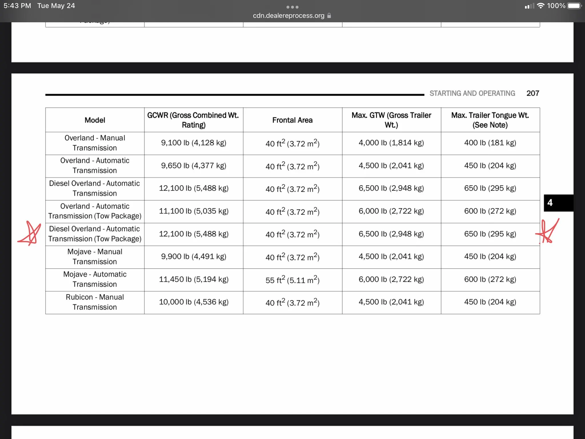

You’re wrong the auto with tow package can tow 6,000 in the overland
That's what I said. Without the factory tow package, the automatic is maxed at 4,500 pounds.
  • 240-Amp Alternator
  • Class IV Receiver Hitch
  • Heavy-Duty Engine Cooling
  • Trailer-Hitch Zoom
  • not sure that’s gonna improve the max towing capacity 1500 lbs

I stand corrected, wouldn’t think the HD engine cooling would give an extra 1500, thought it was 6,000 regardless of having the tow package so long as it was automatic. Thanks, man!
It makes no sense I know. I have an overland without the tow package. That's why I've been looking at trailers with a dry weight of 3000 lb or less.

The rating decrease, without the Factory Tow Package, is due to the missing receiver and cooling capacity. The towing capabilities are similar across all the trim variants. The rating from the factory is based on the combination of engine, transmission, and installed options.

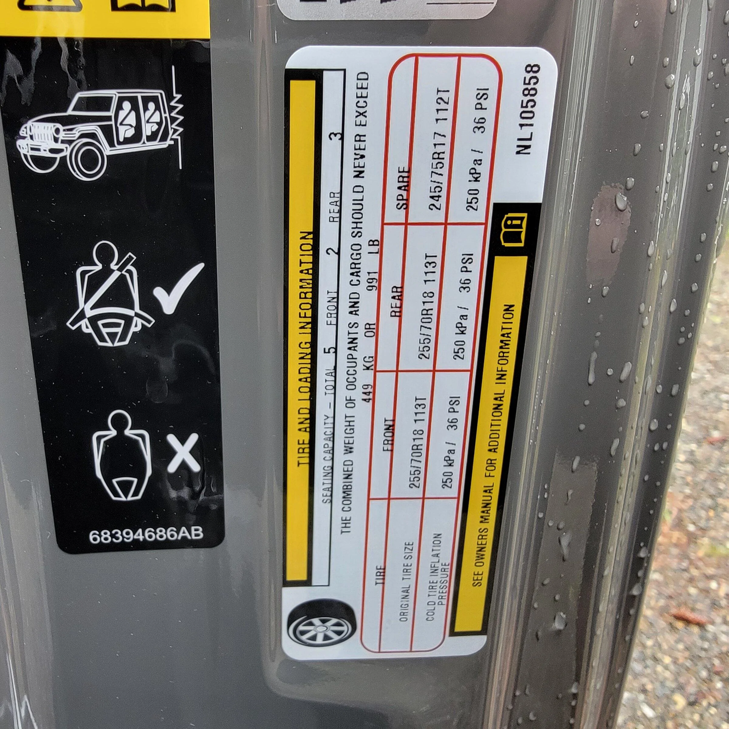

Thanks everyone for all the responses and great discussion! I work nights so missed all the discussion. Here is a photo of the door plate on my specific Overland.
Jeep Gladiator Overland edition payload 20220425_094544

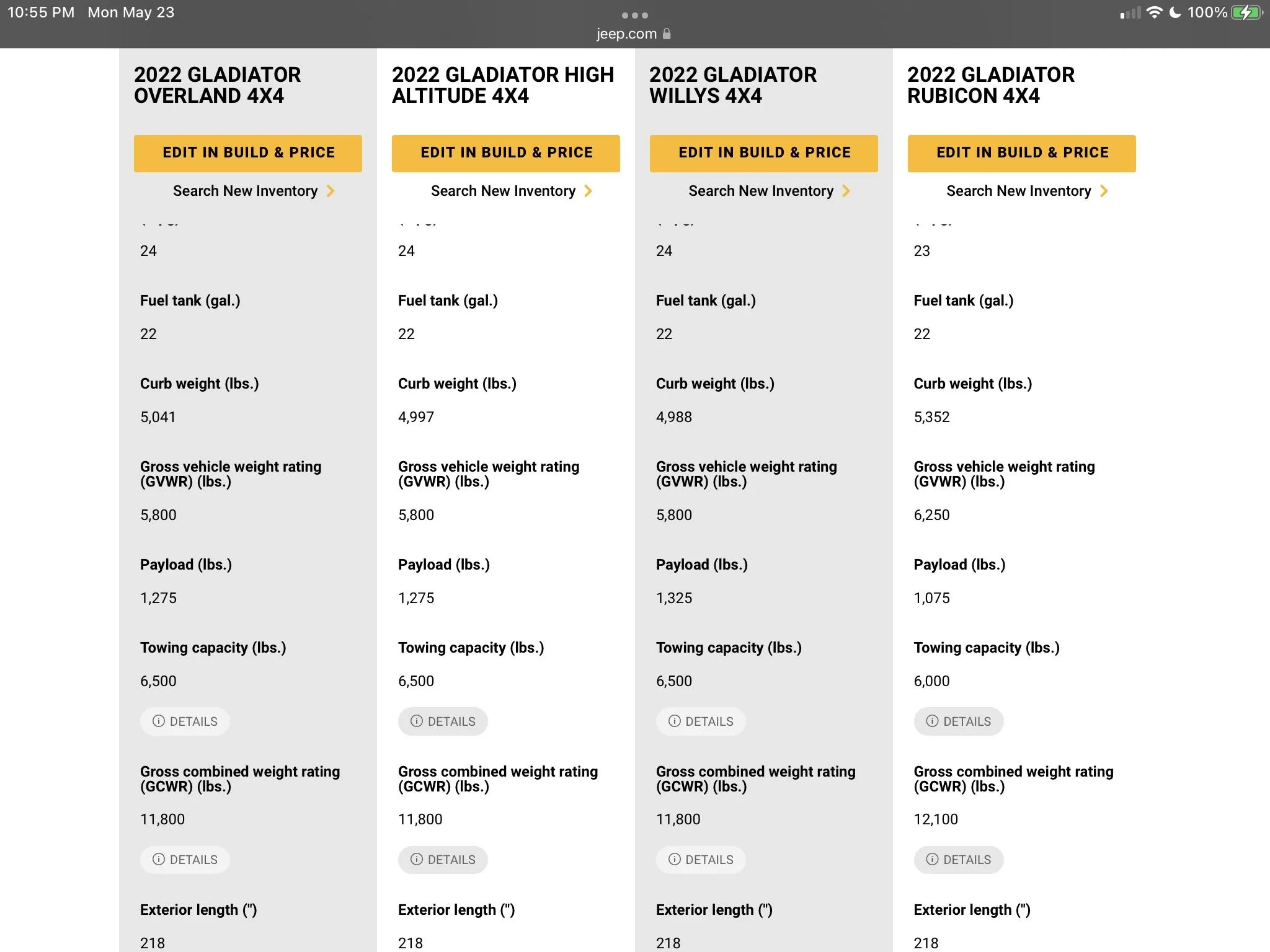

Diesel does affect the payload.
Positively in some cases... since the diesel gets the wider axles, it gets the 6,500lb GVWR too so an overland or Sport with the diesel actually have a higher payload than they normally do. Gimps the Rubicon even harder though.
That's like 140lbs lower than the spec assuming a gas truck... I'm guessing you have a ton of factory options and/or maybe a few dealer installed Mopar add-ons?
